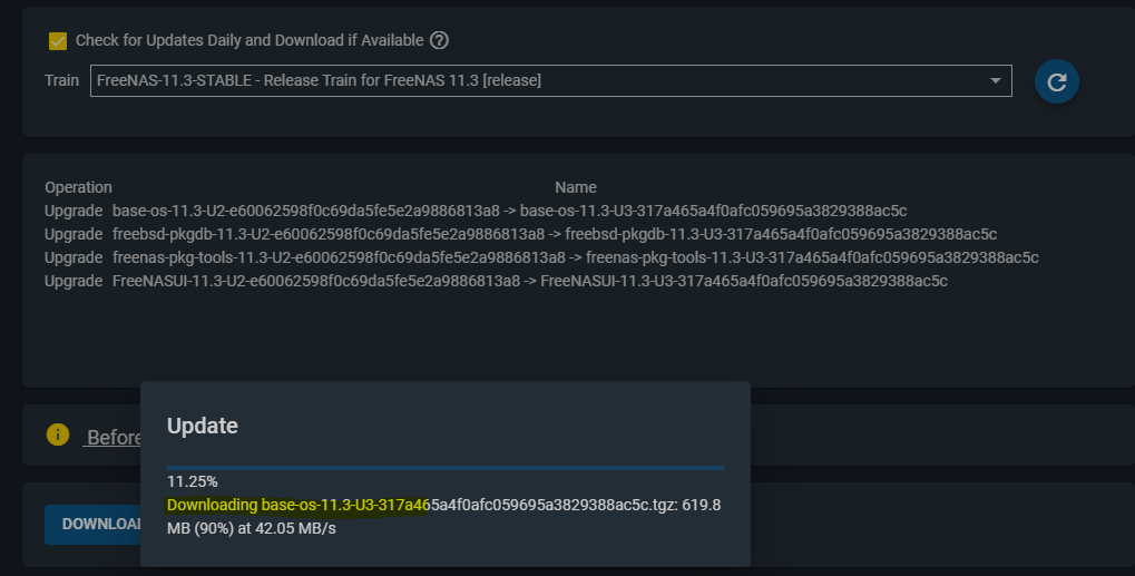

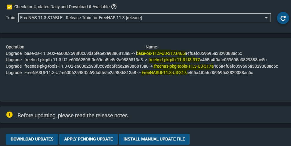

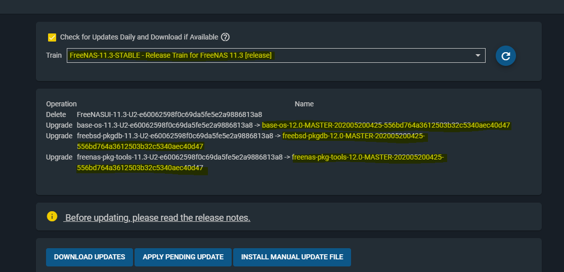

Below is a few screenshots from re visiting the update process
Update screen after a fresh reboot:
Switching to release train 12 and then back again gave me this:
Another reboot and the update still lists 11.3 and updating seem to grab the right set this time...
