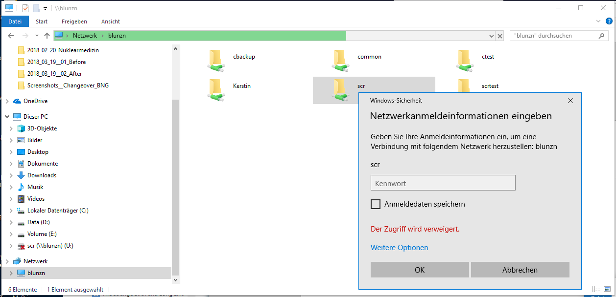

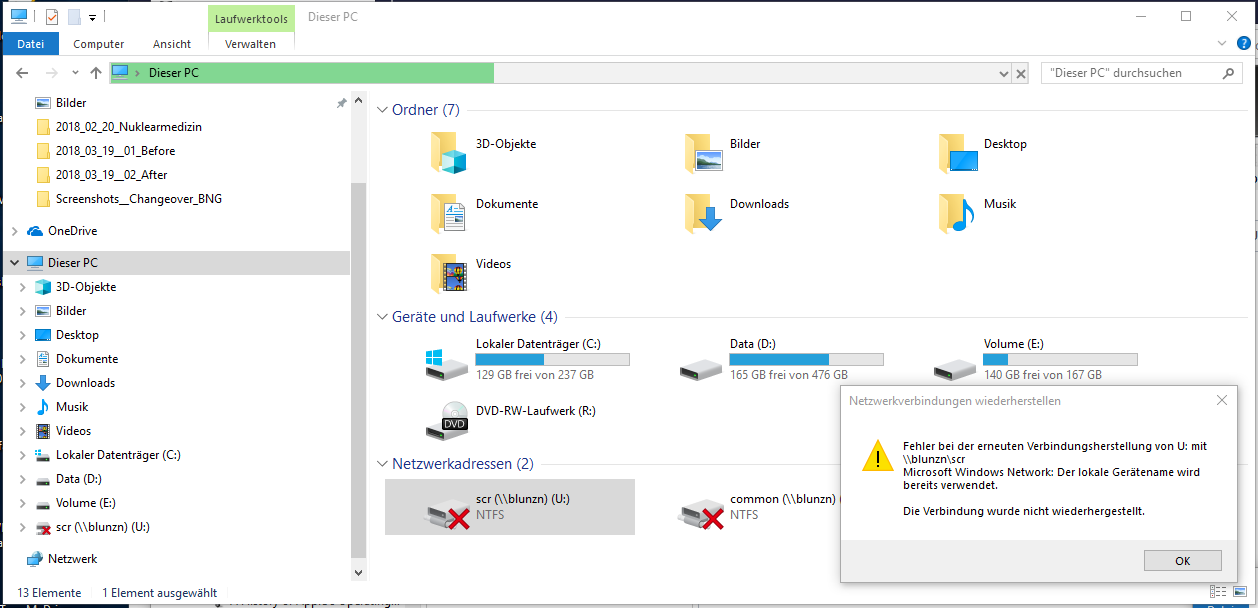

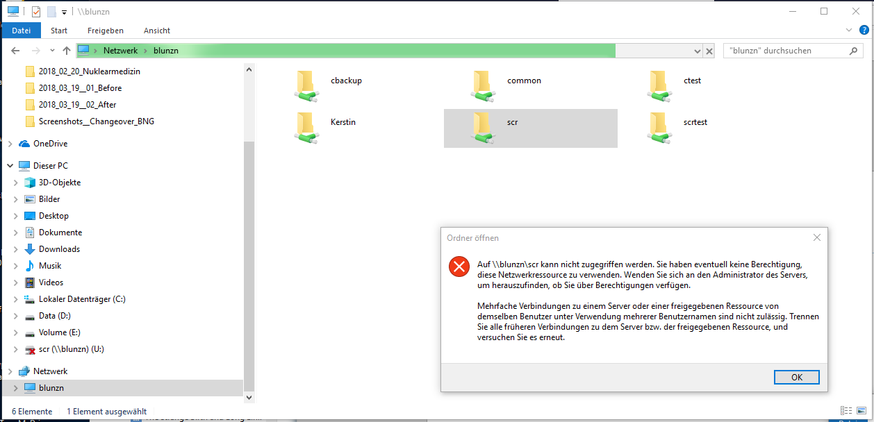

I can confirm access problems to Samba shares with 11.1-U3. These shares worked like a charm in 11.1-U2 and for at least the last three years (shares were created in FreeNAS 9.3 with hardly any manual interference since then IIRC).
Using 11.1-U3
- I'm able to access the FreeNAS GUI as usual
- I'm able to SSH login using PuTTY as usual
- I'm not able to access Samba shares (that is: any Samba shares that do exist on this FreeNAS machine), irrespective of whether I'm using data from the "Windows credentials" store or not.
I'm attaching three screenshots using a German Windows 10 instance, hoping that this rings some bell even for non-German readers.
The update to 11.1-U3 entailed the following change to smb4.conf on my system:
~/althome/smb4 # diff smb4.conf_11.1-U2 smb4.conf_11.1-U3
9a10
>	 private dir = /root/samba/private
I'm happy to answer further questions / provide more information.
Side notes: In 11.1-U3 using the classic GUI login the username root is not pre-populated as usual (i.e. has to be typed in manually). Going back to 11.1-U2 works without further problems on my system.
