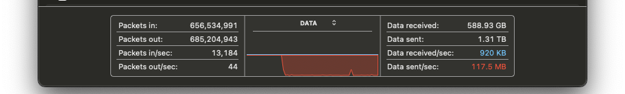

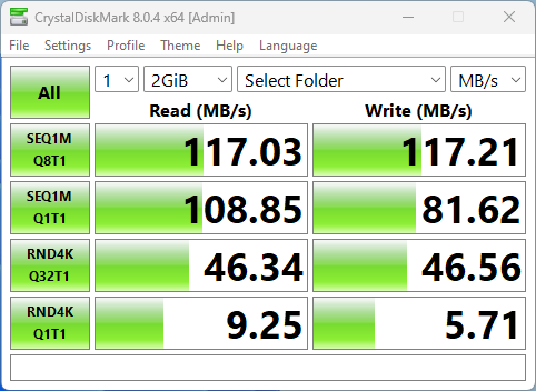

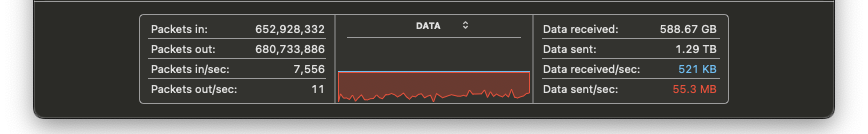

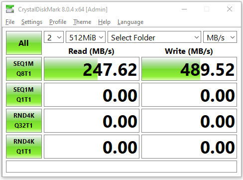

I was able to test using my Windows Gaming PC. It's hooked into the same ethernet switch as my M2 Mac mini with a 1G connection. The tl;dr is Windows 11 did not have the same performance hit as MacOS. Here's my testing.
  1. Set all TrueNAS SMB datasets back to use ACL Type: SMB/NFSv4 and ACL Mode: Restricted.
  2. Restarted SMB via sudo systemctl restart smbd
  3. Started a transfer of a large mkv file and observed SMB was transferring between 50-70 MB/s on MacOS
  4. Switched over to my Windows 11 computer and connected to the same SMB share
  5. Ran CrystalDiskMark on that same share and observed saturated link with the SEQ1M read and write tests
  6. I changed the ACL Mode back to discard on a single SMB dataset
  7. Restarted SMB again
  8. Re-ran my Mac test to find full 1G link speeds again at 117MB/s

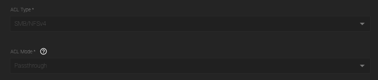

@rymandle05 This is really interesting! I'm happy to test on my side to see if any ACL-related settings affect my issue. (I haven't been fiddling with ACLs much, since the standard unix/chmod bits have been sufficient for my use case.)
Just so there's no confusion, can you please post some screenshots showing the ACL config you're referring to? I don't want to mix anything up. I don't see anything in Share ACL settings that seems to fit your description. I'm probably just looking in the wrong place.

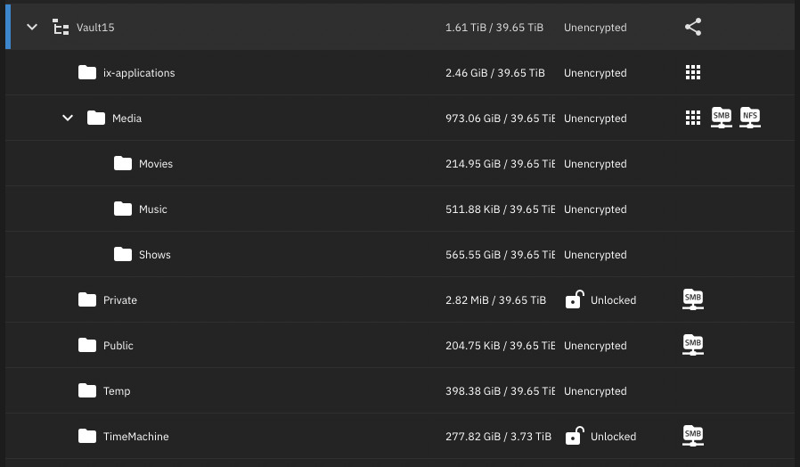

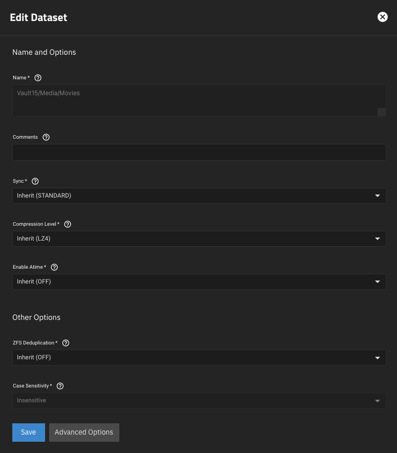

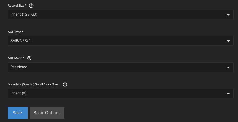

Here's my dataset structure:
To start with, all the datasets shared via SMB (Media, Private, Public, TimeMachine) were setup with same ACL Type and ACL Mode (which I did based on my TrueNAS Core setup). All other settings are also the same except Record Size. Here's a screenshot of Vault15/Media/Movies for reference:
It's here on the dataset level that I'm changing ACL Mode of one dataset (usually Vault 15/Public) to a different value such as discard, restarting smbd, and then seeing immediate performance improvements on my 1Gbe connection copying a large file from my M2 Mac to the SMB share.

At present, my top-level pool settings look like this:
From there, all of my individual datasets have ACL Type and ACL Mode set to Inherit. I'm guessing these are the defaults, because I did not adjust them manually.
This leads to a question: @rymandle05 did you ever test with ACL Mode set to Passthrough? If your throughput issues are only happening when ACL Mode is set to Restricted, and the throughput is normal otherwise, we might be looking at two different performance-impacting issues.

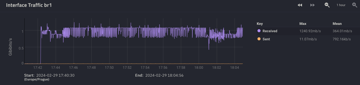

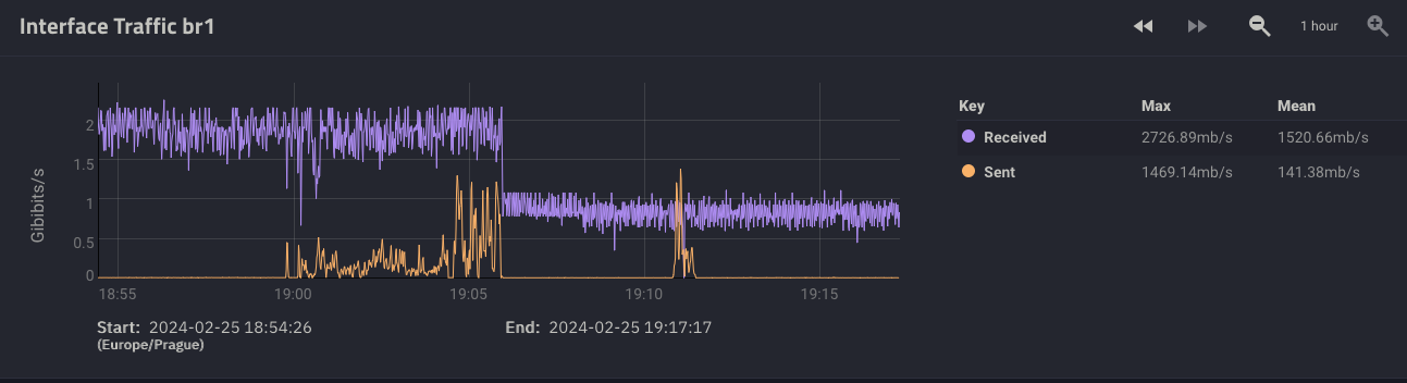

Hello. Also having terrible performance and stability issues with the last SCALE releases. The overall performance is max 4Gbit/s and after some time it rapidly drops to nonsense speeds..

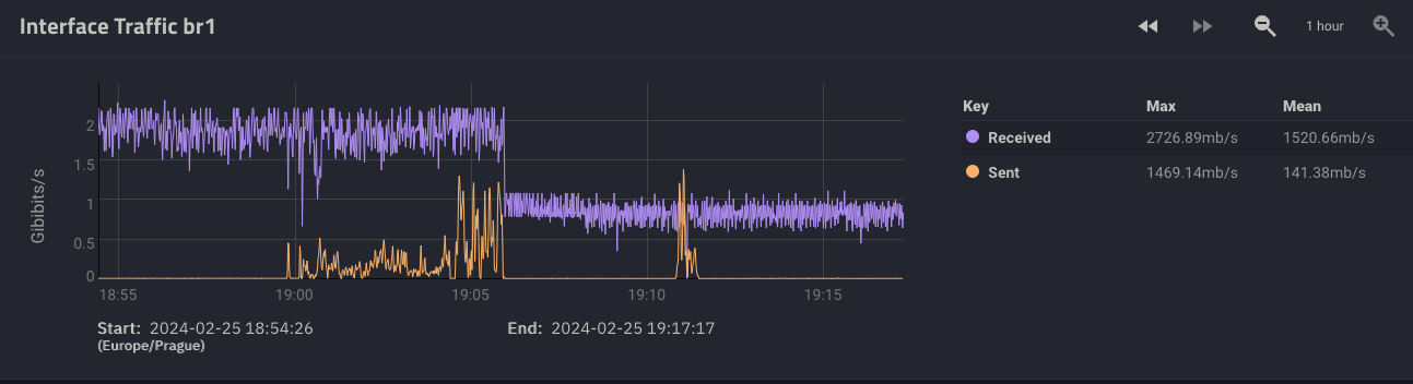

I have TrueNAS-SCALE-23.10.2 and our transfer speeds are terrible.. I have no clue what to do next. Maybe switch to Unraid. I don't know. So frurtrating.

Hm... Weird especially the slowdown, that almost seems like it's running out of memory or cache somewhere? How much RAM do you have? You need quite a lot of (Preferably) ECC RAM for ZFS depending on how much storage you have.
Maybe share more detais on what your hardware and setup is. It could easily be something else causing the slowdown. For instance some LSI HBA require specific firmware for certain SSDs, I think this was due to disconnects in the pool so not really relevant in your case, but could be something else happening? Maybe try spinning up a live linux image of some descruption and trying smb speed with that? At least that would give you an idea whether it's Truenas or something else going on. If its the Dell machine as in your sig, have you cheked the HBA is definitely running in IT mode? Might need a firmware flash.
Random question, do you actually need Truenas Scale? Your could try Truenas Core instead? Depends if you need VMs or lots of apps. If you just want a great performing NAS then Core is probably a good option and more stable than Scale.
