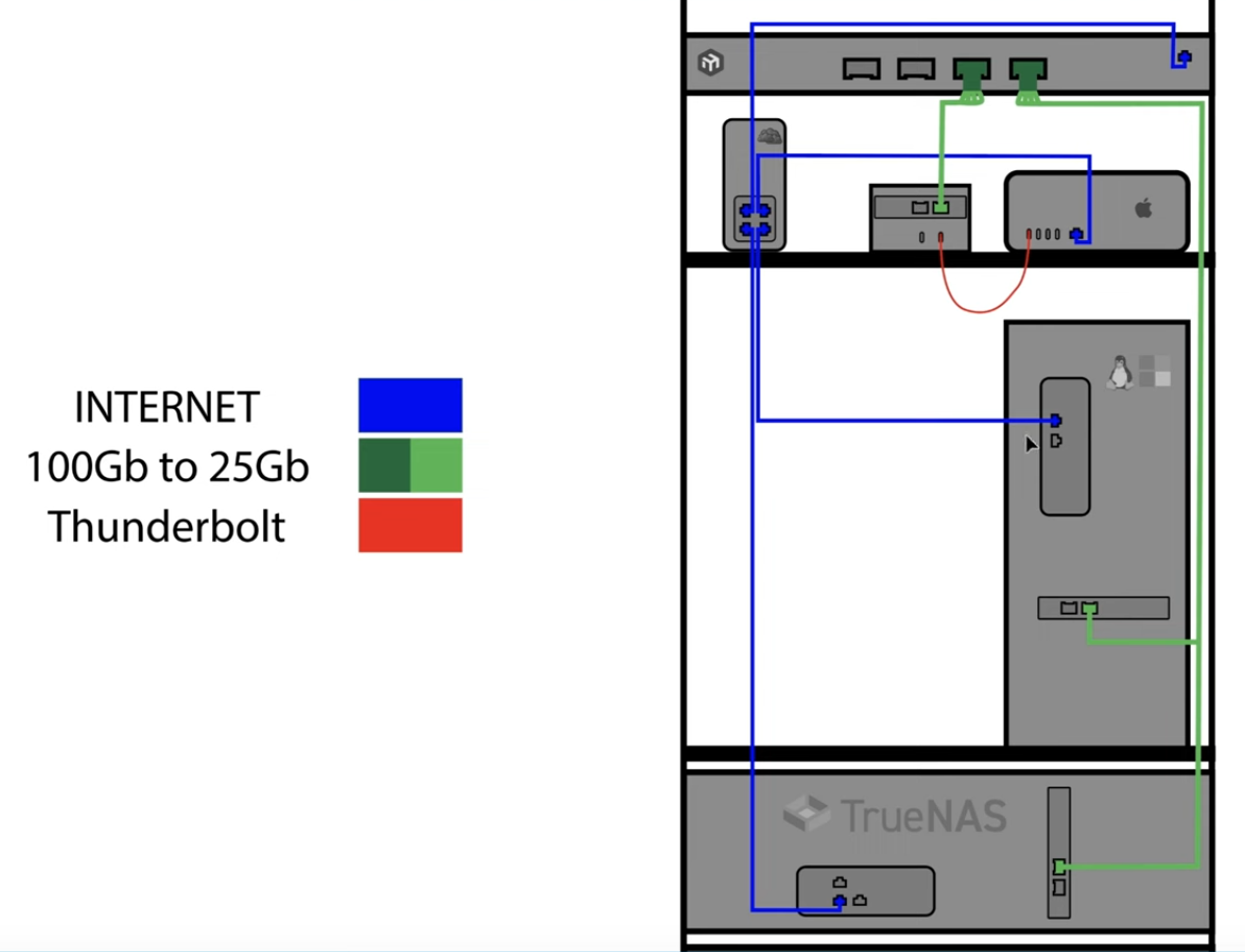

A rough visual of my setup below. (Not sure if this helps)
I love your diagram!!!
Let me decipher this to make sure I get this right:
  1. Switch
  2. Multishelf:
    1. Modem/another switch/router? I am not sure what this device is.
    2. I am also not sure what this device is.
    3. Mac machine.
  3. Windows/Linux machine?
  4. TrueNAS.
Ok, I get that the top box looks like your switch. The third box is a Linux/Windows machine? Bottom box is your TrueNAS server.

I don't really get your representation. The mac is connected via thunderbolt to a device I can't makeout. And from there it goes to your switch.
The windows/linux machine is connected to the switch and to truenas?
How is that connection realized:
If they are on separate networks, are you actually using the correct IP / network interface? Judging from your diagram I doubt you missed that though.

Ha thanks :)
1. Yep that's the switch MikroTik CRS504-4XQ-IN
2. Multishelf:
  1. Xfinity provided Modem/router (For internet/wifi).
  2. Thunderbolt3 to NIC Adapter: Sonnet Twin25G
  3. Mac Studio (Apple System).
3. Linux PC running PopOS (I am running Docker/Nextcloud on it) this is the machine that has the slow connection.
4. TrueNAS.
chuck32
Jan 14, 2023
623
So truenas actually has two connections to the switch? The linux machine has one and your Thunderbolt NIC adapter. So in total 4 ports on your switch are occupied with 25 Gb connections?
Did you try switching ports / NICs?

Hey, thanks for asking!
Does this make the diagram clearer?
DenisInternet
Jun 14, 2022
28
Yes, I suppose I could simplify things, and just have a single 25Gbe connection from TrueNAS to the switch and see if that makes things easier. I thought by giving a second dedicated connection I could increase speed/performance when I really push the systems (Rendering footage with DaVinci Resolve on the Mac while rendering Houdini sims on the linux pc).

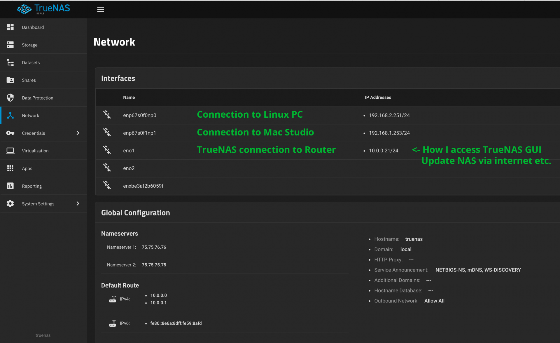

You would probably want to do some link aggregation then instead (switch needs to be aware and configured for this too). And have the new aggregated interfaces assigned to a bridge in the Truenas internally. That is if you really need it to be on multiple subnets.. But I could be wrong.
DenisInternet
Jun 14, 2022
28
That did the trick! Simplified the setup for now all under one subnet and now getting the correct speeds. Will look into if link aggregation is worth it (and supported by the NICs I am using).
