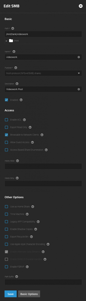

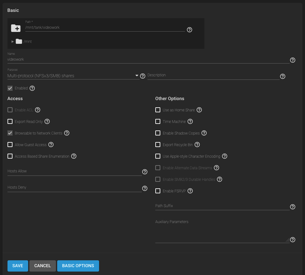

So what is going on here? What design parameters are impacting these protocol overheads? What tuning parameters are going to be most relevant for my use case?
I've googled around a ton, and mostly what I'm finding is half-baked guidance for "set this parameter" without a detailed explanation of why. And a lot of the guidance out there seems either outdated, irrelevant, or outright dangerous.
My experience with this community has been fantastic so far, so I'm hoping someone here will have the expertise and the time to help me reason through this.

Last note before I sign off for the evening. I noticed the UNIX_SUPPORT and OS_X_SERVER attributes in the Veritas2 share, which were not present in the Speculum share. This was caused by the "Enable Apple SMB2/3 Protocol Extensions" flag in the SMB service being set.
I just now tested disabling that flag on Veritas2, and the file transfer speed did not improve.
I also tested enabling that flag on Speculum, and the file transfer speed did not degrade.
I also checked again, and both shares appear to have equivalent configurations.
The outlier here is "Enable Alternate Data Streams", but in both cases the checkbox is disabled, so I cannot check or uncheck it. (Regardless, I don't see how Alternate Data Streams could affect the performance of a simple sequential file read via cat on the command line. But who knows. ‍*shrug*)
Here's the share configuration in CORE:
Versus the configuration in SCALE:

I got some feedback from iXsystems and ran some more tests. At this point it looks like the share performance tanks when you select "Multi-protocol (NFSv4/SMB) shares".
This is surprising because the equivalent option in CORE "Multi-protocol (NFSv3/SMB) shares" does not have any visible performance impact.
Also, somewhat frustratingly, iXsystems closed my ticket as "User Configuration Error" with no explanation. I opened a new ticket: https://ixsystems.atlassian.net/browse/NAS-126798
Anybody following this issue, if you can reproduce and/or are affected by this issue, please give my ticket a thumbs up so iXsystems can pay better attention to this!

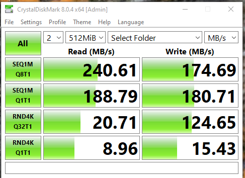

Dysonco
Jul 4, 2023
27
Well, tests aren't looking good...
It's still dire!
Crystal Disk mark bench of shared folder over network. I'm barely getting the speed of a single spinning rust disk...

So I've been able to conclusively identify "Multi-protocol (NFSv4/SMB) shares" as the culprit in my situation. If I remove that setting from my big videowork share, the performance goes up more than 10x.
This is very confusing, because I never encountered this issue with CORE.
I'm also disappointed because iXsystems closed my second ticket without much engagement. If there is a performance regression bug somewhere in the SCALE stack, you would think they would jump at the chance to track it down. I was offering to perform free labor in the form of testing and gathering data on my side!
But they were ultimately pretty dismissive of me. The specific response was "we do not troubleshoot performance problems" and "this is outside the scope of what we do for our free product."
That is an especially disappointing position for iXsystems to take, since I've purchased over $5,000 of hardware and software from them, and I literally told their sales team on the phone that I would be happy to pay for extended support. But they have never actually sent me a proposal or followed up with me.
It's almost like they're taking the position that I'm some freeloader asking them to do me a favor, which is frustrating and couldn't be farther from the truth.
