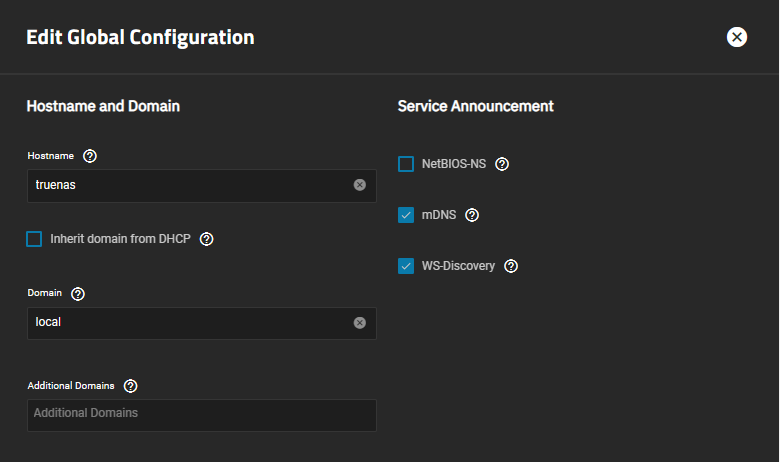

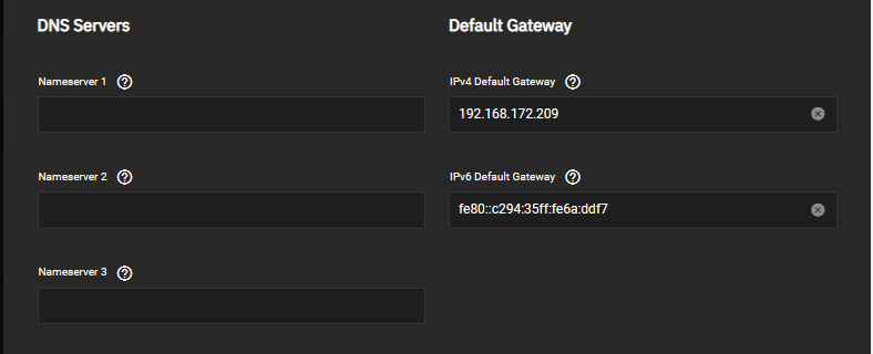

Specifically - Network / Global Configuration Settings
NugentS
Apr 16, 2020
2,947

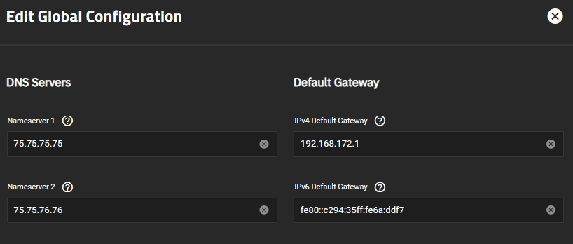

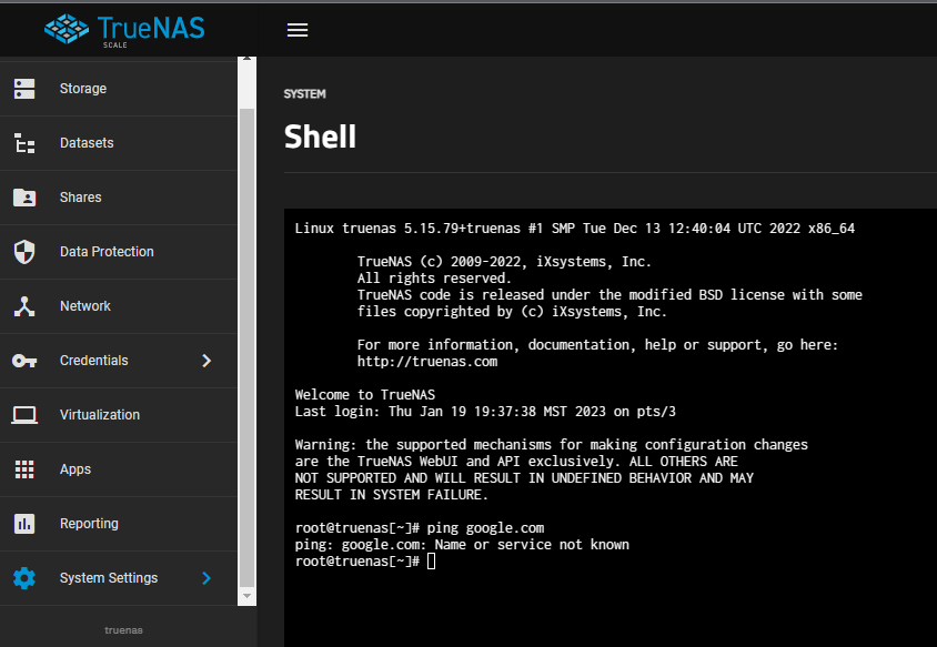

You have no DNS servers - fix that and it should work
15,504
In addition to DNS servers (1.1.1.1 and 1.0.0.1 will work if you don't otherwise know what to put there), the gateway address is questionable. That should be the IP address of your router, and most of the ones I've seen end in .1 or occasionally .254. Make sure that address is correct, and I'd also suggest removing the IPv6 gateway entirely.

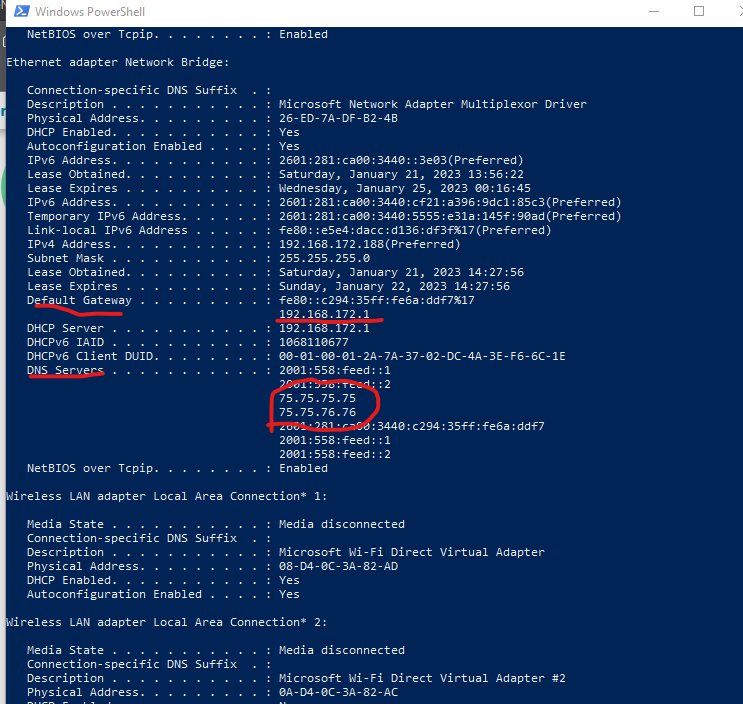

Changed the Default IPv4 and DNS Servers based on results from ipconfig /all from my laptop. Still does not result in positive comms outside of LAN.

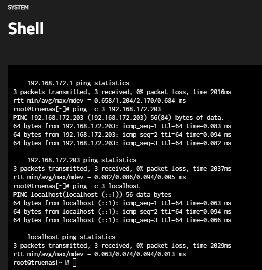

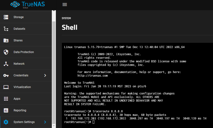

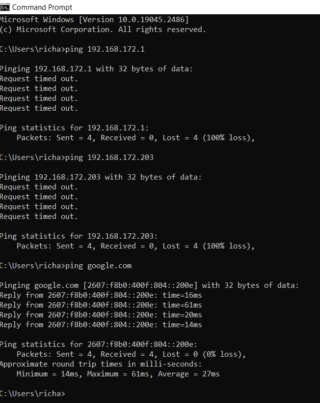

15,504
No reply from either gateway of console.

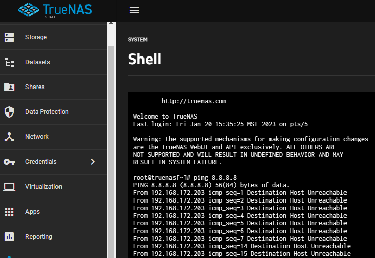

What you posted looks troublesome, but I was asking whether you could ping the gateway from the NAS, not from your Windows machine.
