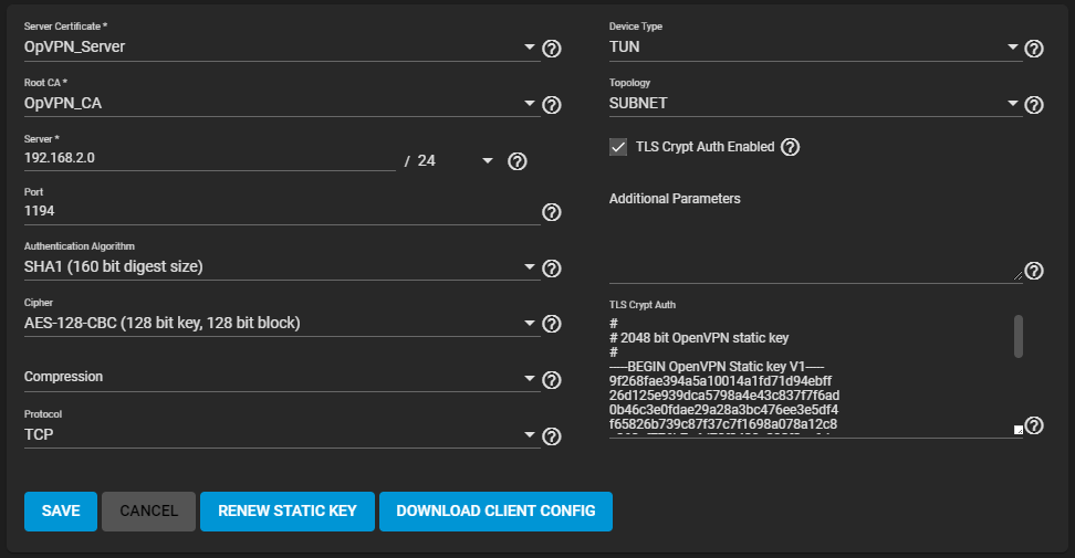

Updated to Truenas 12, but I'm unable to connect to the service remotely.
- Followed all steps from this guide: https://www.youtube.com/watch?v=S8I-IiQYVas
- Using No-IP as DDNS, instead of Google in his guide.
- 1194 forwarded in my router as well, to my truenas' lan ip. Confirmed the port is correctly opened via: https://www.portchecktool.com
My router and gateway's LAN IP is 192.168.1.1 and my Truenas server is 192.168.1.x
Shouldn't my OpenVPN Service settings be something like "192.168.2.0/24" then? Or is this incorrect?

Hi @Arkhen,
Do you have any error message in your logs ? What kind of client are you using to connect to this ? You switched the default protocol from UDP to TCP. Are you sure that is what you forwarded in your router and using in your client ? What version is your client ? ...
You need to tell us more...
