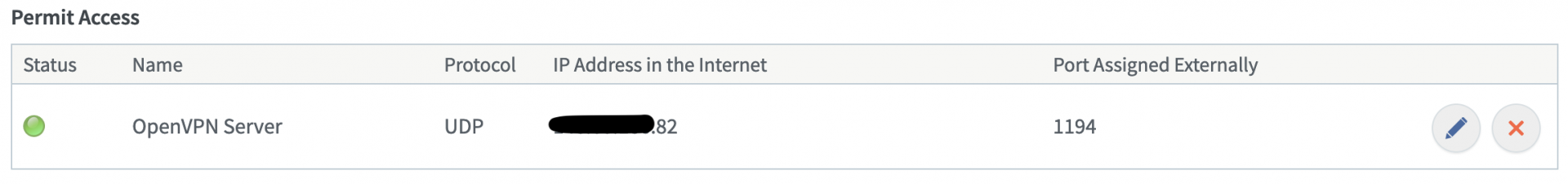

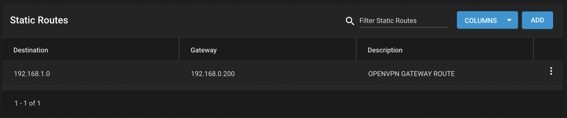

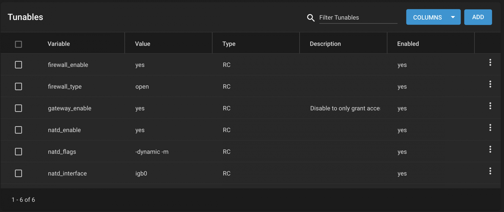

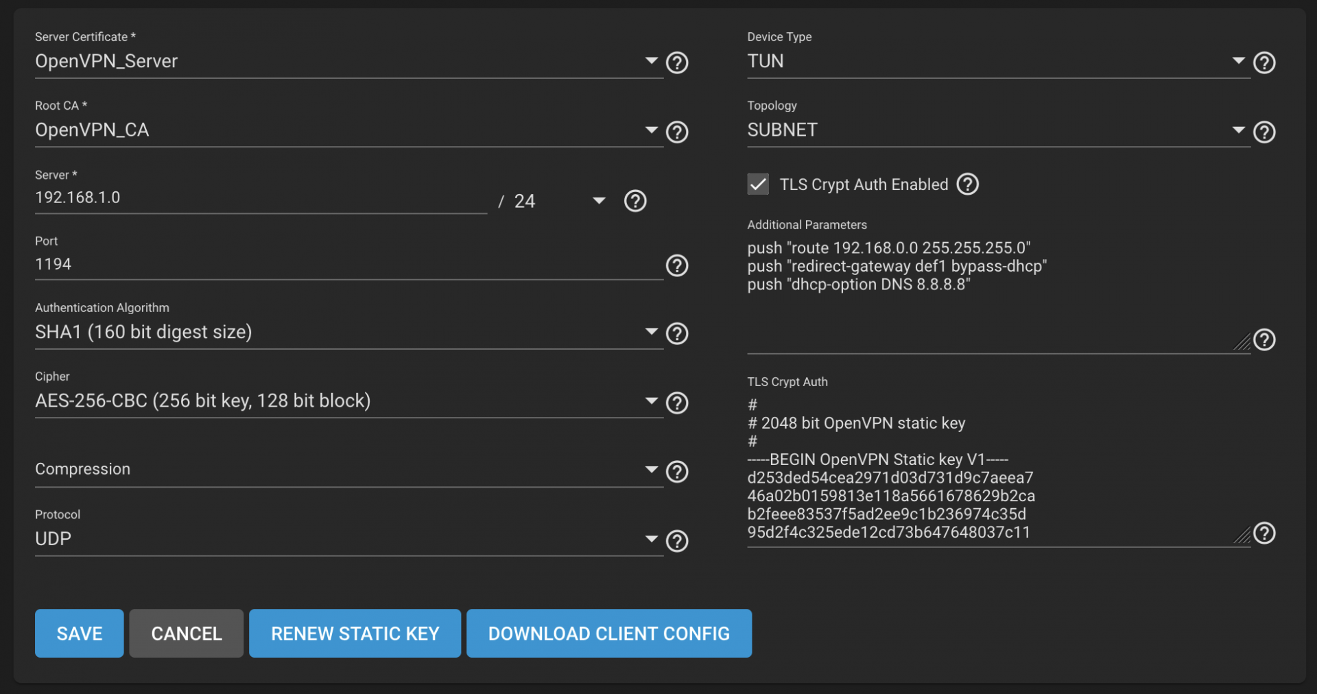

I've exported the Client Configs and made the necessary changes, however when I run the OpenVPN Client on my Mac, I get the following error messages:

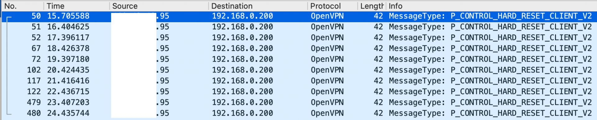

I just ran a WireShark analysis on my router and got the following:
The xxx.xx.xxx.95 IP address is the address of my client - accessing inbound from the internet.
I'm guessing that port forwarding is working okay, as the Destination is my TrueNAS server IP, located at 192.168.0.200
Although I'm not sure what the P_CONTROL_HARD_RESET_CLIENT_V2 means...
After doing some searching I stumbled upon this page (https://sourceforge.net/p/openvpn/mailman/openvpn-users/thread/200502231146.06867@-mr700/) in which someone says the following:
In SSL/TLS mode, the initial P_CONTROL_HARD_RESET_CLIENT or
P_CONTROL_HARD_RESET_SERVER message creates an untrusted client instance
object and sets the reply address, which cannot change during the life of
the session (if the client address changes, a new session must be
negotiated). If --tls-auth is used, the reply address will not be learned
from a packet unless it is verified by an HMAC integrity check.
So I turned off the TLS Crypt Auth Enabled option and lo and behold I can connect - it's now working perfectly!
