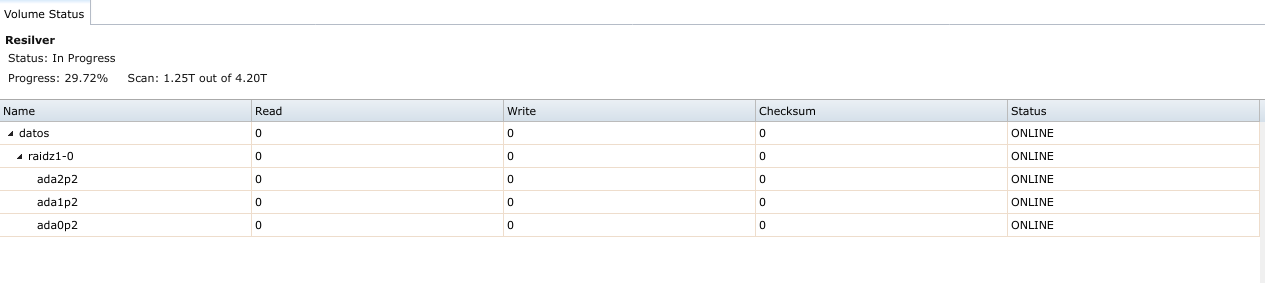

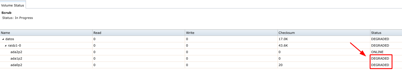

Hi, in a FreeNAS-11.0-U1 (aa82cc58d) I found this:
Last week I found one disk (ada2) was in an error state (I don't have a screenshot) and bought a new one and replaced it. At that moment ada0 and ada1 where ONLINE, but now I found them are in a DEGRADED state, what can have caused that?.
Here's the smartctl -x for ada0:

Jan 7, 2015
1,153
See what it reports after your scrub is complete.
zpool staus -v
leonardorame
Jun 30, 2018
106
Not finished yet, but here's the outpot:
root@freenas:~ # zpool status -v
  pool: datos
 state: DEGRADED
    corruption.  Applications may be affected.
action: Restore the file in question if possible.  Otherwise restore the
    entire pool from backup.
   see: http://illumos.org/msg/ZFS-8000-8A
  scan: scrub in progress since Mon Jun 28 13:19:20 2021
        1.53T scanned out of 4.09T at 105M/s, 7h6m to go
        0 repaired, 37.28% done
config:
    datos                                           DEGRADED     0     0 17.0K
      raidz1-0                                      DEGRADED     0     0 43.6K
        gptid/70e6882f-bc38-11ea-a7ae-1c1b0dc62b56  DEGRADED     0     0    20  too many errors
        gptid/4ae4995d-bc8a-11ea-9395-1c1b0dc62b56  DEGRADED     0     0     0  too many errors
        gptid/75383bdc-d680-11eb-80cf-1c1b0dc62b56  ONLINE       0     0     0
        datos@auto-20210622.1500-2w:<0x0>
        datos:<0x0>
        datos@auto-20210622.1800-2w:<0x0>
        <0x151b>:<0x0>

Jan 7, 2015
1,153
A great majority of these errors are in auto snapshots, but as of now, this doesnt look good. As a precaution id backup anything from this pool you cant live without.
leonardorame
Jun 30, 2018
106
Yes of course I'll backup as much as possible (this and past year's files), but apart from that, do you see anything wrong in the smartctl reports I posted early?.
Jan 7, 2015
1,153
Have a look thru your dmesg and see if theres anything goofy in there. Certainly you must have system alerts, what do those say?
cat /var/log/dmesg.today and cat /var/log/messages
ChrisRJ
Oct 23, 2020
1,919
With a such a temporal correlation, i.e. two disk going "bad" right after replacing another, chances are that it has something to do with that change. The usual suspect are the SATA cables. I would recommend to mark the cables, and then shuffle them. Take notes like "cable A from ada0 to ada2" and make sure all cables are inserted into their connectors properly. This should allow you to narrow down the issue to either drives or cables.
The power supply is also a candidate here, but I would start with the cables. It is more likely, especially with the timing right after the disk replacement, that something is wrong elsewhere, rather than two disk dying at the same time.
leonardorame
Jun 30, 2018
106
Yes, today I'll have that machine in my office to take a look at cables and power supply.
leonardorame
Jun 30, 2018
106
The scrub finished, here are the results:

leonardorame
Jun 30, 2018
106
In cat /var/log/dmesg.today everything seems to be ok, well, I found this machine has an Intel i3 processor, but apart from that there are no errors. In /var/log/messages I found a couple of blocks like this on Jun 26 and Jun 28:

Hi, I'm back with this machine. I've replaced the power supply with a ThermalTake SMART 430W and now I don't see any DEGRADED disks.
However, as you can see the system is in a resilver state that's taking ~20 hours and only did a 29% of the job.
What whorries me the most is the scan rate is lower every time I check.
root@freenas:~ # zpool status datos
  pool: datos
 state: ONLINE
status: One or more devices is currently being resilvered.  The pool will
    continue to function, possibly in a degraded state.
action: Wait for the resilver to complete.
  scan: resilver in progress since Fri Jul  2 13:57:13 2021
        1.25T scanned out of 4.20T at 25.3M/s, 33h59m to go
        422G resilvered, 29.67% done
config:
    datos                                           ONLINE       0     0     0
      raidz1-0                                      ONLINE       0     0     0
        gptid/70e6882f-bc38-11ea-a7ae-1c1b0dc62b56  ONLINE       0     0     0
        gptid/4ae4995d-bc8a-11ea-9395-1c1b0dc62b56  ONLINE       0     0     0
        gptid/75383bdc-d680-11eb-80cf-1c1b0dc62b56  ONLINE       0     0     0  (resilvering)
errors: 149746 data errors, use '-v' for a list
As you can see the scan rate now is 25.3M/s, but a couple of hours ago it was over 30M/s.

Hmm, after finishing the resilvering it went back to the DEGRADED state:
  pool: datos
 state: DEGRADED
  scan: resilvered 1.10T in 67h2m with 8996 errors on Mon Jul  5 09:00:03 2021
config:
    datos                                           DEGRADED     0     0 10.0K
      raidz1-0                                      DEGRADED     0     0 23.0K
        gptid/70e6882f-bc38-11ea-a7ae-1c1b0dc62b56  DEGRADED     0     0     0  too many errors
errors: 9146 data errors, use '-v' for a list
If I run zpool status -v datos I get this:
  pool: datos
 state: DEGRADED
config:
