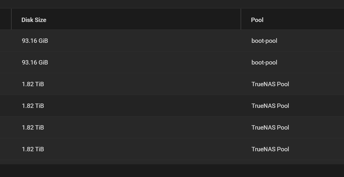

I have a brand new setup with a few old parts lying around. I am new to TrueNAS and trying to set up a basic sandbox NAS.
I installed a fresh copy of TrueNAS-12.0-U6 using DHCP. Upon logging in, I added the second SSD 710 to the boot pool. Other than that I have not made any changes to the default software configuration.
