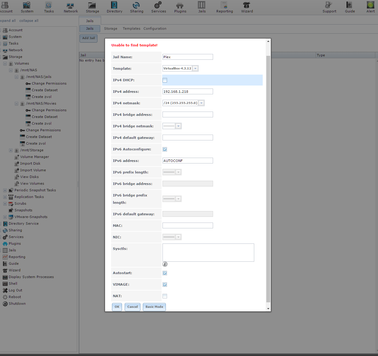

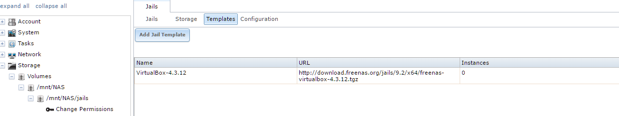

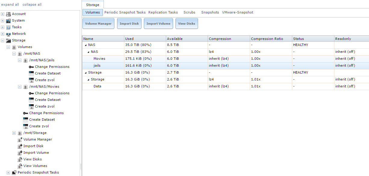

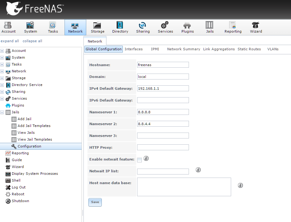

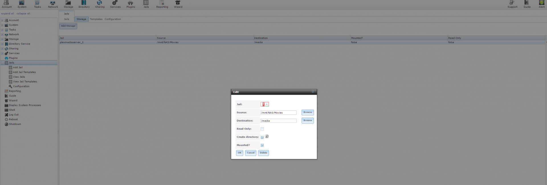

striker79
Feb 11, 2016
59
Here is what I am seeing...
nojohnny101
Dec 3, 2015
1,477
well that picture #2 makes sense because there is not jail installed to add storage to. not sure about #3.

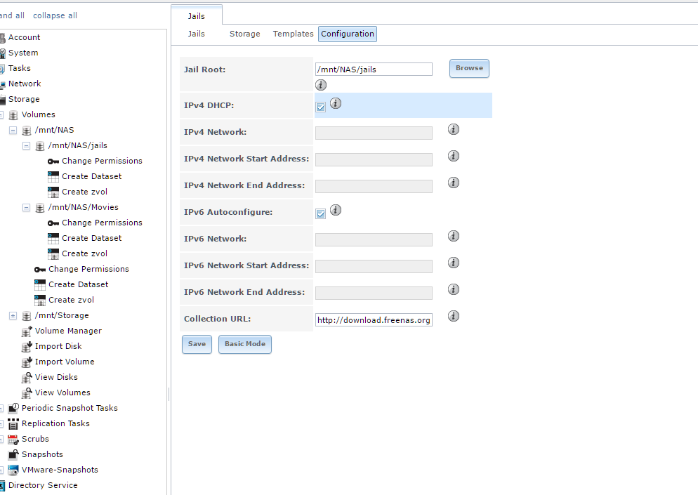

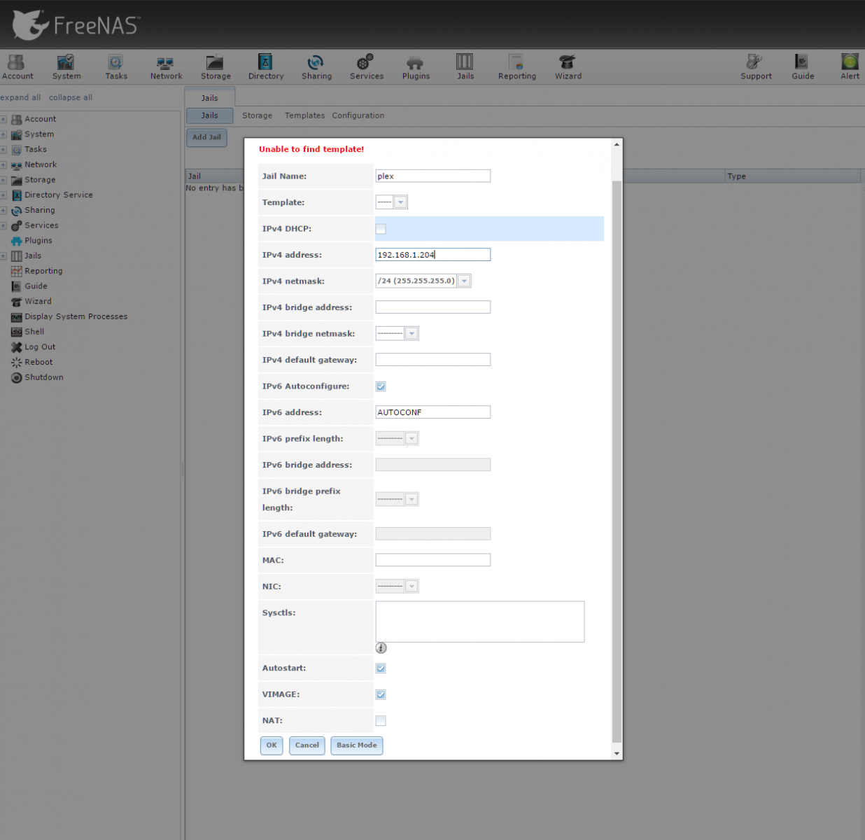

I just tried the link you posted but I get "Unable to find Template"

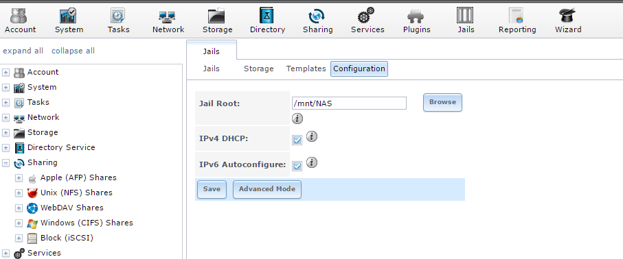

Sakuru
Nov 20, 2015
527
Under the Jails tab --> Configuration, what is your Jail Root set to?
striker79
Feb 11, 2016
59
Jailer
Not strong, but bad
Sep 12, 2014
4,977
You need to create a dataset for your template to reside in. It will not install to the root of your Pool.
striker79
Feb 11, 2016
59
Like this...

Jailer
Not strong, but bad
Sep 12, 2014
4,977
Like this...
Yes. Now change your jails configuration tab to point to the dataset you just created and try downloading the template again.

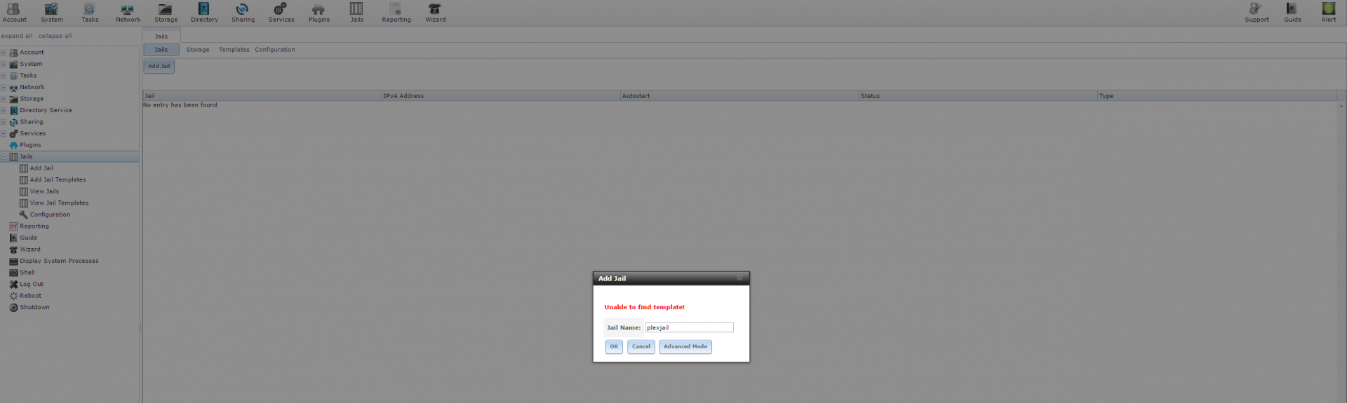

striker79
Feb 11, 2016
59
I just tried and still get "unable to find template"

Is there any templates listed on the templates tab?
striker79
Feb 11, 2016
59
Just this one

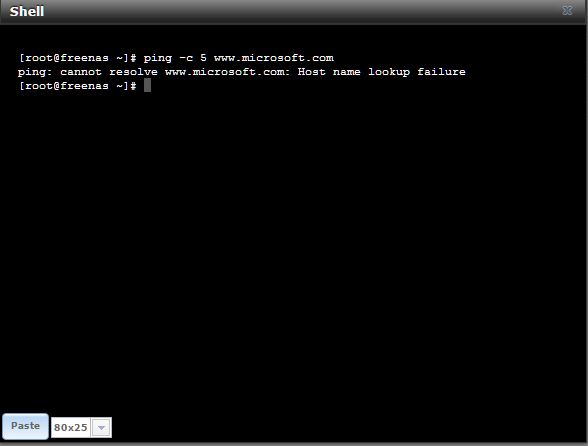

MisterIce
May 21, 2016
87
And sending a ping from the shell is working?
For example:
ping -c 5 www.microsoft.com

striker79
Feb 11, 2016
59
Ping doesn't seem to be working?
