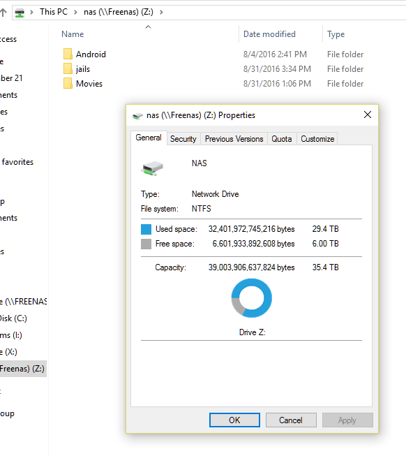

Huh, you have some strange stuff in there. All of the folders that start with a period should not be there, and "Android" isn't listed as one of your datasets. Poke around in those folders and see what you find.
I believe the Android folder was created by my Nvidia Shield. It's so odd. I went under every folder, but nothing. Even on my desktop, the properties of the folder show the movies should still be there...
Sakuru
Nov 20, 2015
527
How big is the snapshot you mentioned earlier? I'm curious about Used and Refer.
striker79
Feb 11, 2016
59
264.3 GiB Used, 25.7 TiB Refer
