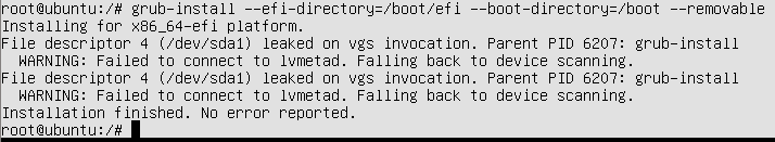

Ok, went back, ran the command to re-install. This also installed kernel 39. Generally seemed to proceed without much issue, just a few warnings that didn't look bad.
When that completed, I ran update-grub. Then I removed everything from /boot/efi/EFI/BOOT and ran the grub-install command as described. This displayed:
I then reverted the resolv.conf change and rebooted. I now still have an issue where I just get the grub prompt, with the same error I posted above about no such device...

That grub2 error message inidcates an EFI problem. As that grub-install command failed, I would in rescue mode delete the "/boot/efi/EFI/BOOT" directory, be careful to leave /boot/efi/EFI/ubuntu in place.
I would hope when booting the VM you would now be dropped to the EFI shell and exiting from there you can use the EFI boot manager screen to get your VM booted.
Although from grub2, it is supposed to handle having /boot inside a LVM, I'm wondering if this works OK when using EFI. I make little use of LVM in general, and certainly keep the partition layout as simple as possible when using bhyve.
If you can get your VM booted as I just described, you should be able to use that special grub-install command as root. If it then fails, then it would seem having /boot inside the LMV is not such a good idea.

OK, rather than being guilty of assuming what works in Ubuntu 16 LTS also works in Ubuntu 17, I tested it myself. Firstly, if you choose to force EFI install after selecting the "guided whole disk + LVM" layout option, Ubuntu 17 should boot post install without further intervention. In rescue mode there is an option to "Force GRUB installation to the EFI removable media path" , but this fails with an error - see attached images. So that special grub-install command does not work in Ubuntu 17, as you have found.
If the contents of /boot/efI/EFI/BOOT are removed and you then have to boot the VM from the UEFI shell, you need to install grub to your VM's disk again and update grub to restore EFI booting.
grub-install /dev/sda followed by update-grub

Boot the VM from the UEFI shell? Do you mean boot from file, then pick and .efi file to load? Which one?
Joe Fenton
May 5, 2015
40
Nevermind, I just booted the CD again. Removed /boot/efI/EFI/BOOT contents, and ran those 2 grub commands. It now finally boots! Thanks so much. Wish I could buy you a beer or several!
