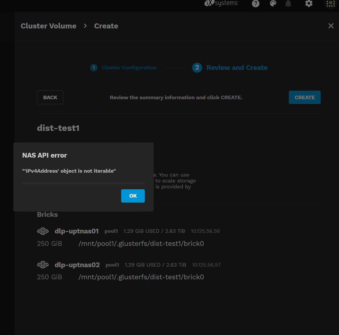

Hello all, i am trying to set up a test to see how the TrueNAS Scale works.
my hardware: not ideal. 2 R710s running RAID, but these are not the systems i will use if i ever get past the conceptual phase.
i work with EMC SANs at work the last 15 years, so i am up to speed on how iscsi and multipath connectivity work, but i am trying to figure out how this stuff is configured as pertains to TN-Scale.
so, both my R710s have a bonded interface for nic1-2, and 2 interfaces each with IPs on my iSCSI network (A and B are seperate vlans). those things seem to be working as esxpectd, the 2 r710s can ping all the other devices on their respective networks. i think individually the 2 systems would be at least useable... but when i try to create a cluster object in truecommand, i get the error:
NAS API error
"'IPv4Address' object is not iterable"
not sure exactly what this is trying to tell me. can anyone point me in the right direction?

well, i reset my test, with 3 identical nodes, but when i tried to created a replicated cluster from the 3, i still got same error.
NAS API error
is there any relevant logs files i should take a look at on the truecommand server that might shed some light?

I'm running into the same issue.
Ive tried to create each of the 4 gluster types over 2 systems (third system isn't up yet, just testing out)
Also tried doing a simple replicated/distributed on each system individually with 2 drives, with this i get a different error "[EFAULT] No peers detected"
First tested with link aggregated failover nics. Again tested with single nic, same result.
Restarted the gluster service on each system.
Have tested on both the docker latest and nightly builds with no difference in behavior.
Running TrueNAS-SCALE-22.02-RC.1-1 on both server and Command on my laptop on the same subnet.

Nov 7, 2021
3
To note i'm seeing these errors on the TrueNAS Scale side too, seem like Command is just iterating it back.
Nov 7, 2021
3
Digging further some i see this in the middleware logs, seems there was a fix merged 3 days ago for this issue https://github.com/truenas/middleware/pull/7823 .
[2021/11/08 04:50:33] (ERROR) middlewared.job.run():394 - Job <bound method returns.<locals>.returns_internal.<locals>.nf of <middlewared.plugins.gluster_linux.peer.GlusterPeerService object at 0x7fc028da66d0>> failed
  File "/usr/lib/python3/dist-packages/middlewared/job.py", line 382, in run
    await self.future
  File "/usr/lib/python3/dist-packages/middlewared/job.py", line 418, in __run_body
  File "/usr/lib/python3/dist-packages/middlewared/schema.py", line 1131, in nf
    res = await f(*args, **kwargs)
  File "/usr/lib/python3/dist-packages/middlewared/schema.py", line 1263, in nf
  File "/usr/lib/python3/dist-packages/middlewared/plugins/gluster_linux/peer.py", line 73, in do_create
    await self.middleware.call('cluster.utils.resolve_hostnames', [data['hostname']])
  File "/usr/lib/python3/dist-packages/middlewared/main.py", line 1310, in call
    return await self._call(
  File "/usr/lib/python3/dist-packages/middlewared/main.py", line 1267, in _call
  File "/usr/lib/python3/dist-packages/middlewared/plugins/cluster_linux/utils.py", line 60, in resolve_hostnames
    ips.extend(result)
TypeError: 'IPv4Address' object is not iterable
morganL
Captain Morgan
Administrator
Mar 10, 2018
2,694
I am having this issue as well. Is there an eta on the release of RC 1.2?
Later this week... it going through it final testing. The nightlies fix the problem.
** Edit: Needed multiple rounds of testing and was pushed back to next week (week of 22nd Nov).
