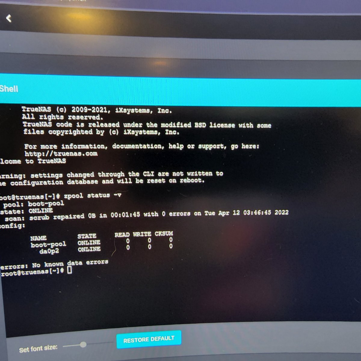

Zpool status just gives me boot-ool and da0p2 both online

What hardware are you using - all of it. Also Scale or Core. How are the disks connected to the motherboard, onboard SATA, USB, HBA what. Basically complete details please.
Output of zpool status -v in code tags
Output of glabel status (if core) in code tags
smartctl --scan in code tags

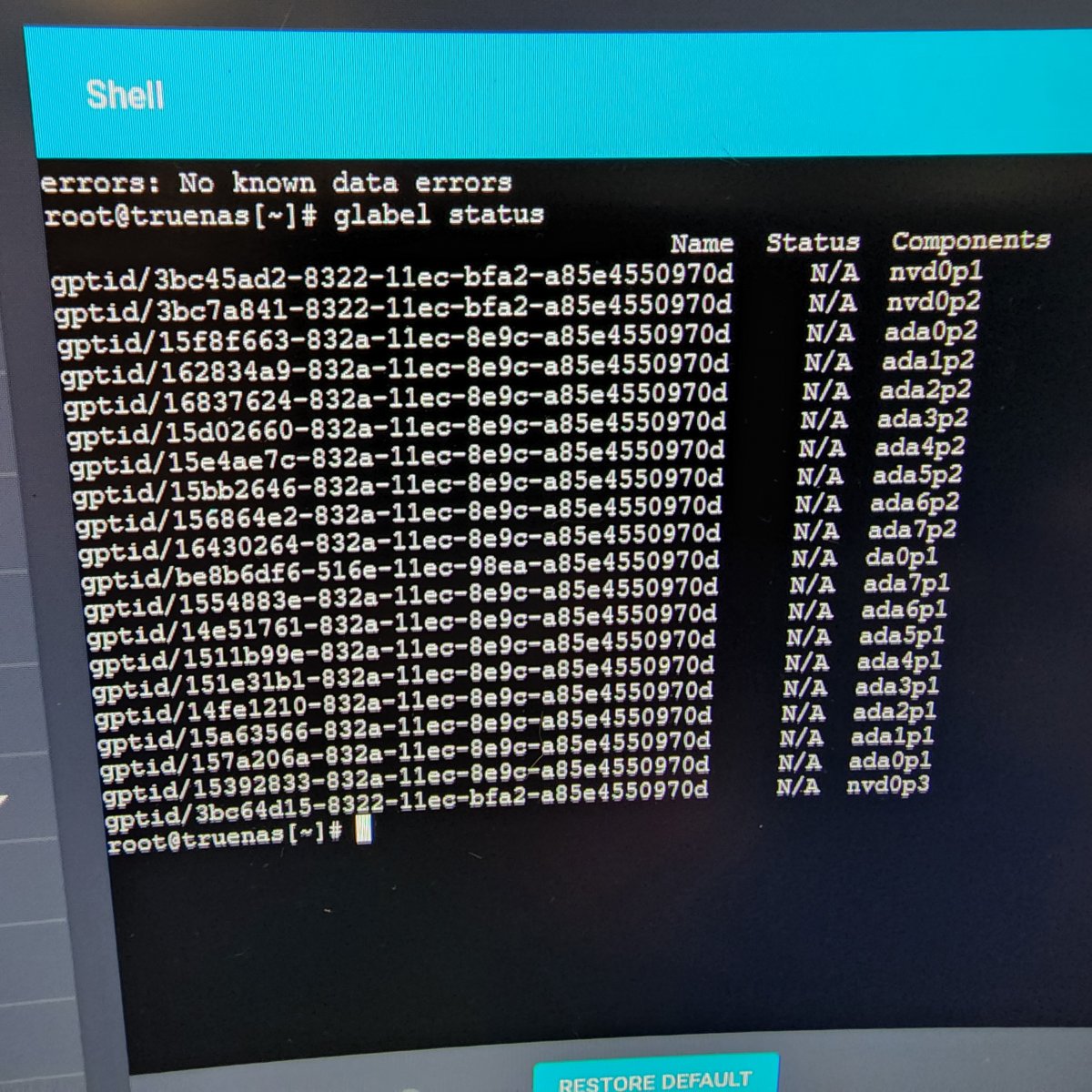

Here is the zpool and the glabel.

In code tags please - use Putty to log into the server and copy and paste from there
smartctl --scan is what I asked for please, in code tags

Your boot drive is da0
Your other drives seem to be listed as ada implying that they are on something different to the da0 of the boot pool - that they are connected differently. Also the motherboard has 8 SATA Ports to which you appear to have attached 9 disks plus an nvme drive
Also you have nvd0 which you haven't mentioned in your spec - whats that used for? Is that the boot disk?
You also don't mention how you disks are organised. 12 * Individual pools? RAIDZ1, Z2, Mirrors, stripes
