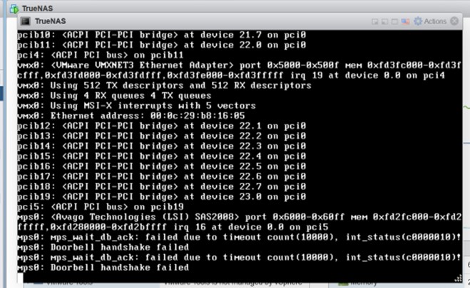

Upgraded from 12U8.1.
Everything worked to begin with.
But now TrueNAS 13 has shut itself down and will not boot.
Hanging on "Doorbell handshake failed".

Assuming you made a config backup beforehand, I'd try to install from iso to an new boot environment and restore the config through the gui.

Thanks, have config, so that will work. Or reinstall.
Hardware running TrueNAS as a VM might have some problems, missing drivers for 13.0 maybe LSI-card, will check.

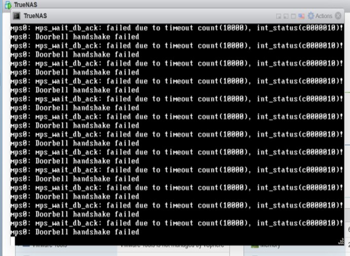

TrueNAS 13 boots up fine after rebooting ESXi host. But then TrueNAS 13.0 shuts down after som minutes..for some reason.
Was able to revert to 12U8.1 in the boot menu. No problems with that edition..(!)
So it seems like a problem with LSI-card and TrueNAS 13.0 for my ESXi installation. See screenshot.
Driver problem in TrueNAS 13?
When reverting to previous 12U8.1 version in the boot menu, how to make it permanent?
ie how to delete the 13.0 version so that it does not boot up 13.0 in case of power trouble or any other reason for a reboot of the system?

Same problem here. Updated to 13.0U1 from 12.0U8.1 on ESXI 6.7 with LSI 2008 pass through and TrueNAS would shutdown after a few minutes and then "Doorbell handshake failed" error when trying to restart TrueNAS. Rebooting the ESXI host temporarily resolved the issue, but only for a few minutes. Restoring 12U8.1 fixed the issue.

And I do not want to start the old 13 VM again since it is setup with the same LSI-card/hdd's that I am using in the now working SCALE-install - I do not want any corrupt data. I believe the LSI-card was the problem since the boot halts after the card is identified by the CORE boot process, so no point in removing the LSI-card from the 13U1 VM.
The only info I have are the screenshot in the start of this thread, and some more similar screenshots of the boot process before it halts.

No relevant messages after host reboot, the 13-release booted up fine, but crashed after some minutes. And any attempt to reboot it thereafter got stuck at the "doorbell-message".
