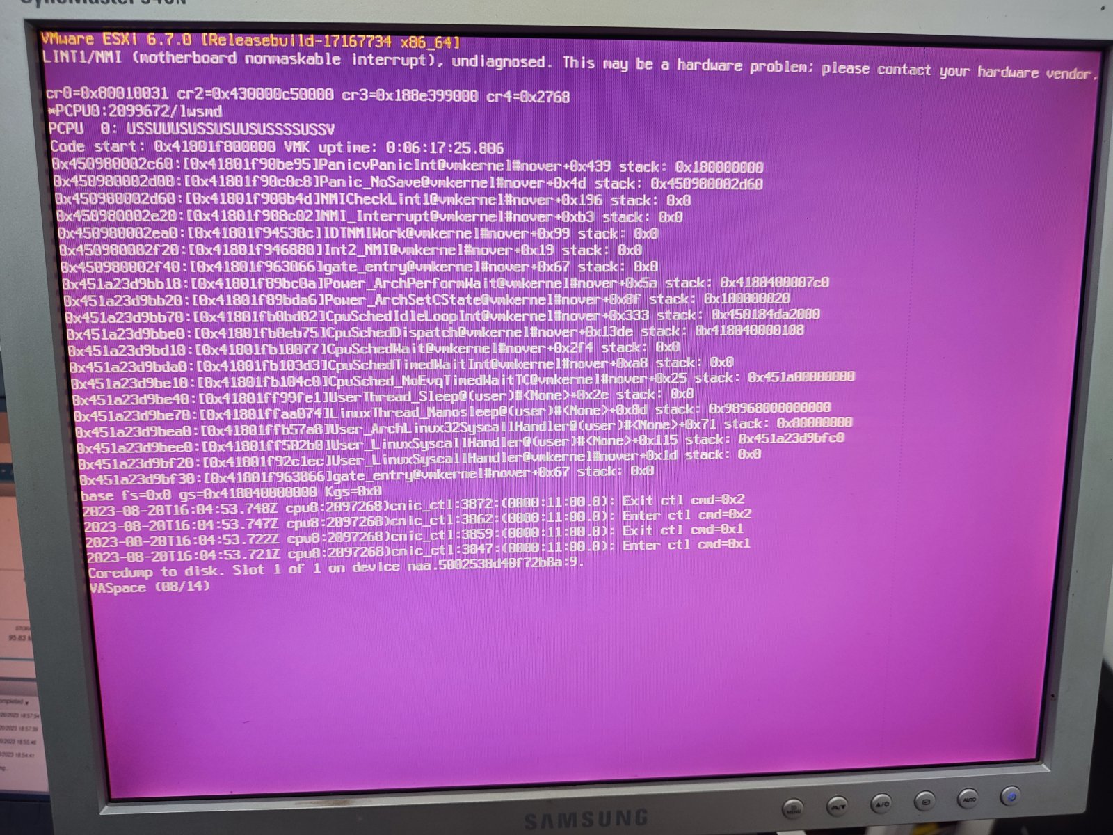

Then, had to poweroff vm, then i get a PSOD
BTW, it looks like all da disks are ok
