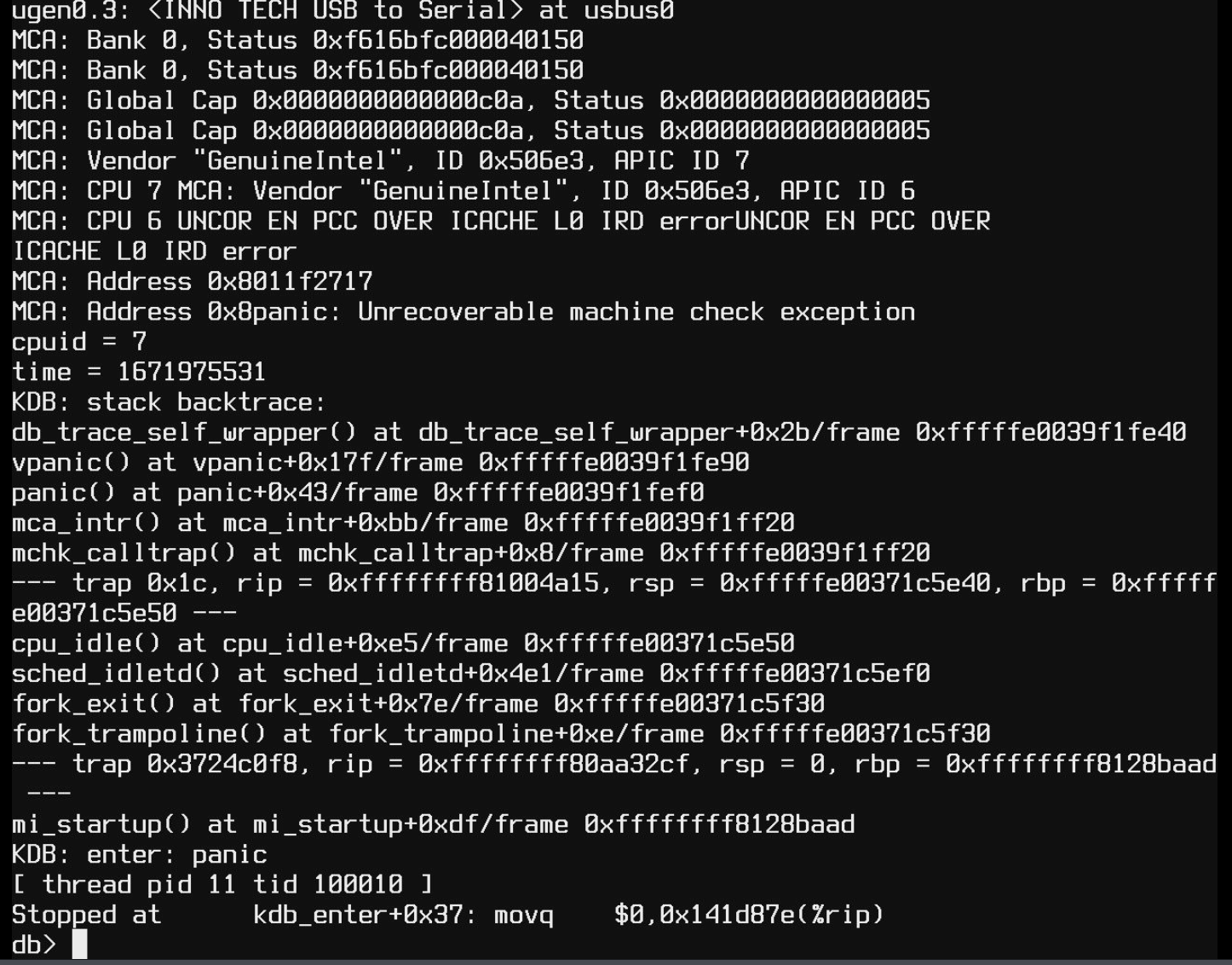

Tried to remove the HBA-card, network card and three RAM sticks and boot it again, no difference. Tried a different RAM-stick, no difference. Moved to a different RAM-slot no difference. Have not yet tried to reseat the cables or CPU since that is a bigger job but will try it.
Seems like it flip flops between complaining about core 6 or 7, not sure if that is relevant.
Tried to install TrueNAS 13 on a different machine and move the drive over, same issue.

As for bent pins, guess you are suspecting the motherboard has a bent pin. I still find that hard to believe since all the other testing you performed worked fine. I did a little research and found that the error message is complaining of a hardware error.
One thing you could do is try to run FreeBSD 13.1 and see what happens. Maybe it will work fine. If it does, then I'd submit a bug report on TrueNAS.
I also assume you are trying to install TrueNAS 13.0-U3.1 (which is built from FreeBSD 13.1-Release-p2. And you did say you tried a clean install I think.
Good idea, I will try that.
Never even got to the install part since the installer itself exits with the error.

Very late update but I only now had the chance to test with different hardware and I can now say that the CPU is broken. So it's quite impressive that it still ran for almost a year and only crashing around 5 times.
