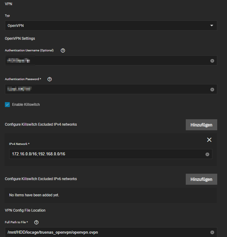

Basically I change the following:
All other settings are by default.
