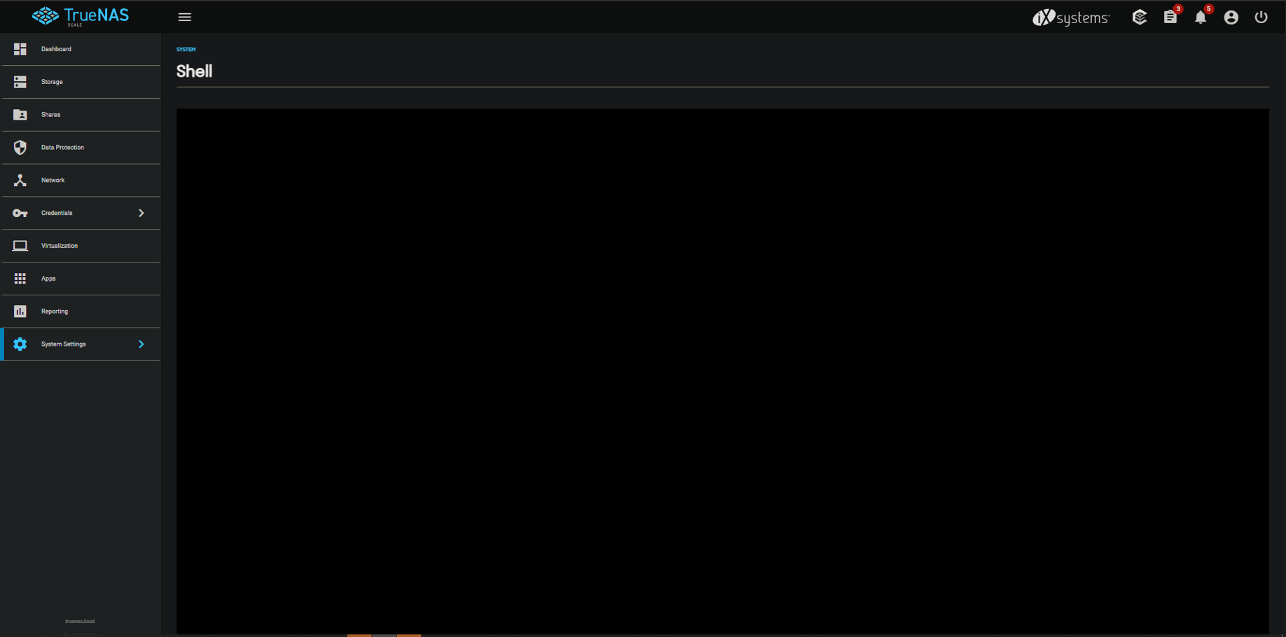

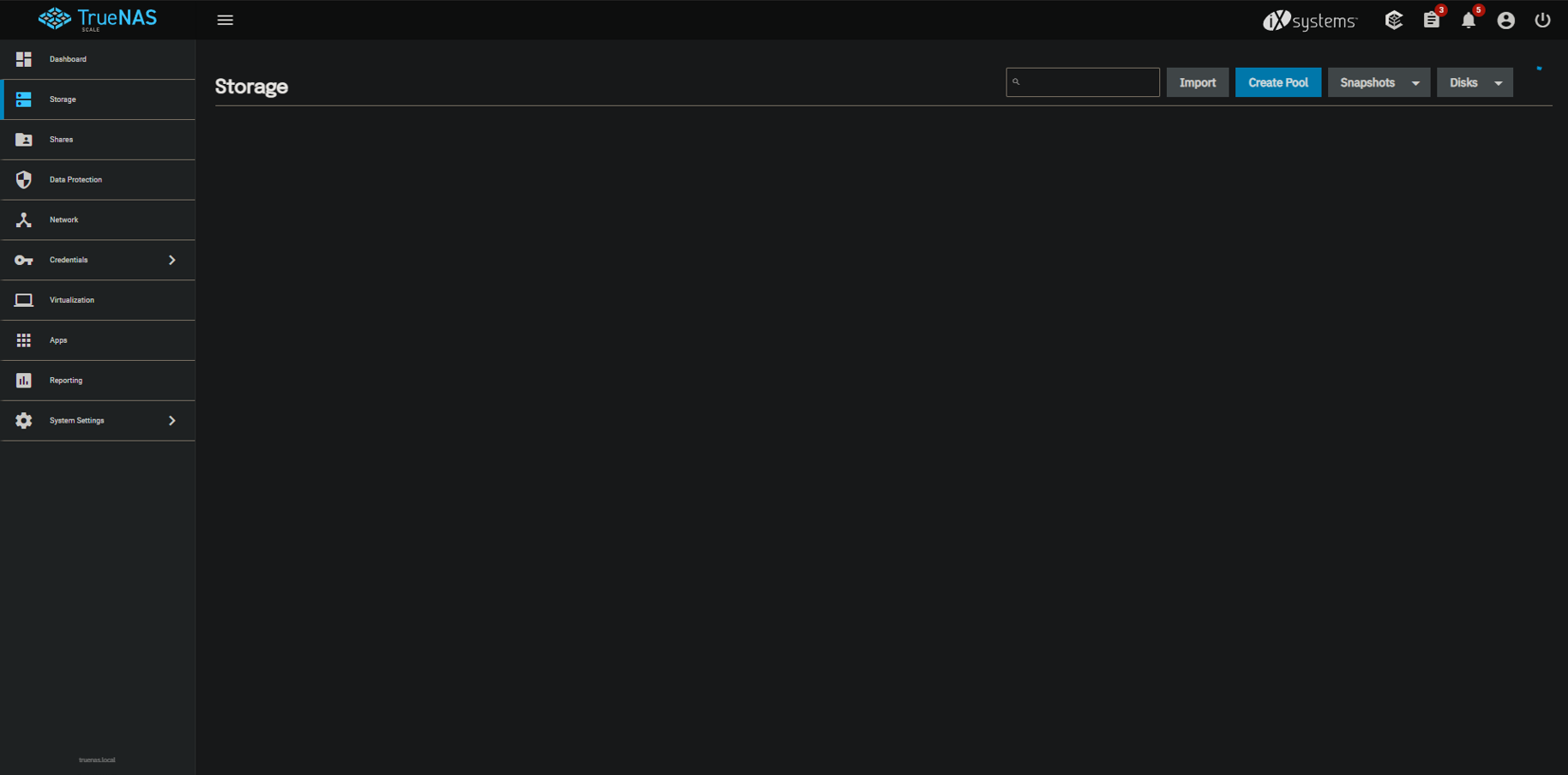

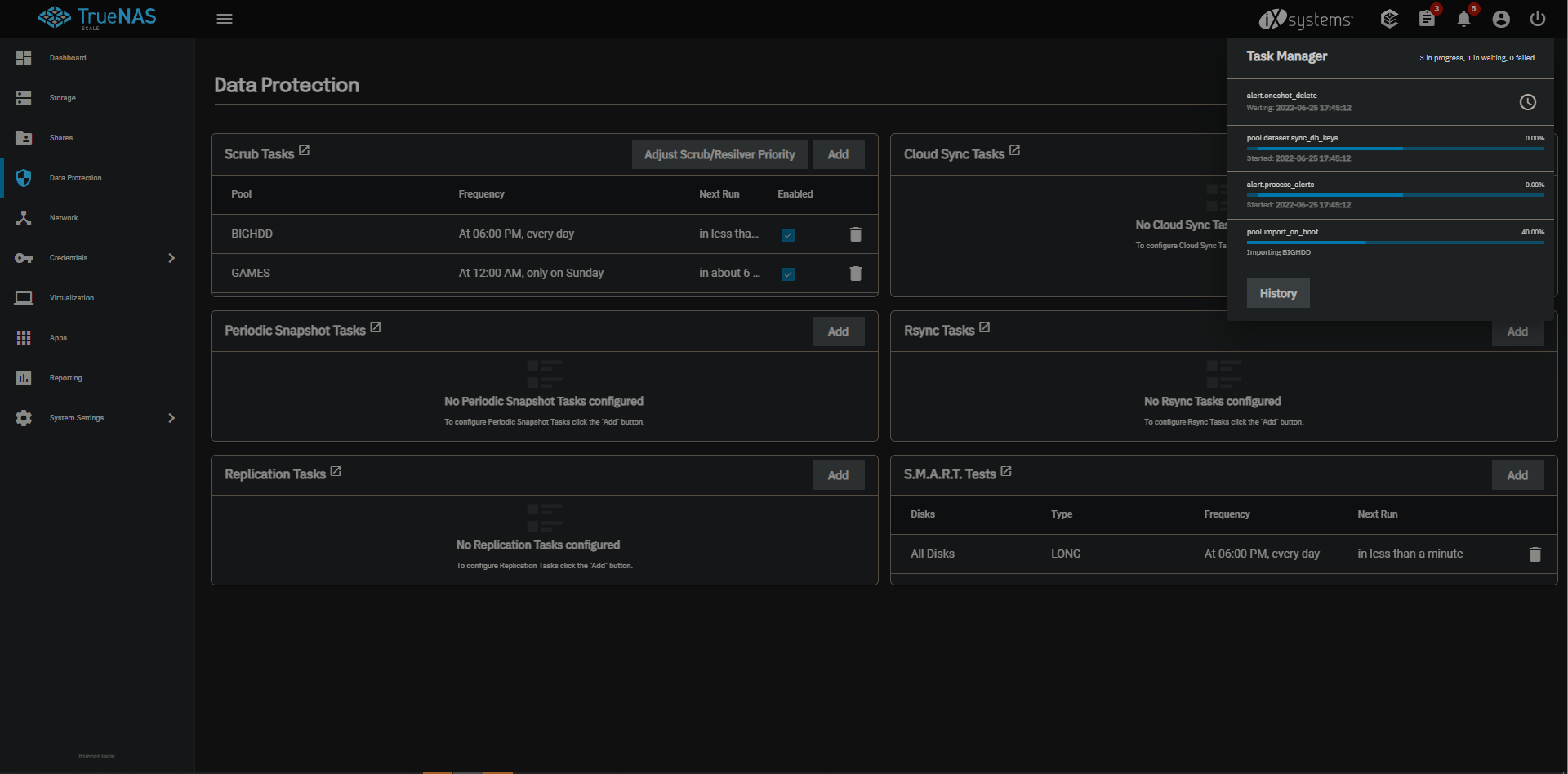

Update:
By selecting: TrueNAS Scale GNU/Linux 22.02.0.1 I am able to boot up into the OS!
However, the system is extremely unresponsive. The shell can be accessed but running [zpool status] yields no response. And other times the shell just shows blank. In some areas, I can see that the pools are still listed but in storage, nothing shows up.
In one of the screenshots that I've attached, you can see one of the pools is trying to import but is hung at 40% (I don't know what those other tasks mean).
I am able to use the CLE shell and I would guess the Linux shell on the main screen but it seems that it uses different commands, so I'm still at a loss on what I can do.

MikeLowry
Nov 20, 2021
27
Update:
Have you tried booting into 22.02 RELEASE?
I updated today to 22.02.2 and the system would not boot - I can only boot into the RELEASE version.
