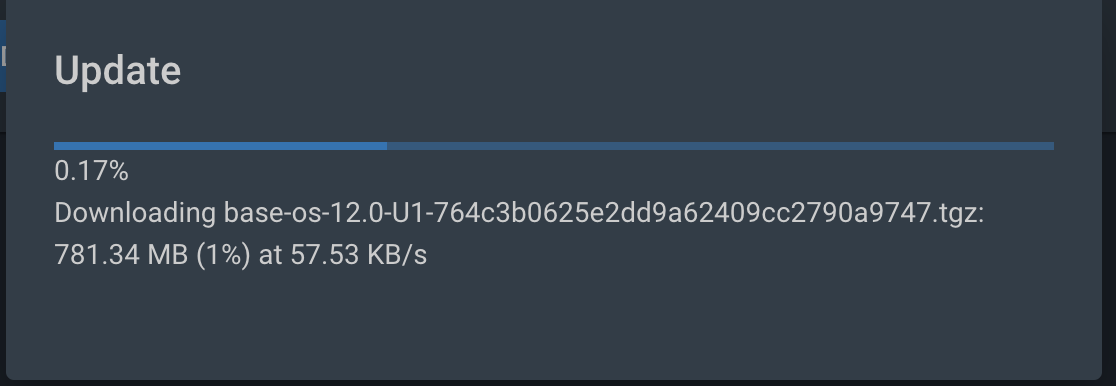

Which was just released.... and is downloading at 1997 modem speeds

1997 modem speeds
That's about twenty times faster than you'd realistically be getting back in 1997.
Source: Was alive and using modems back then, am tickled pink by the idea that I now find my gigabit sync line slow at times. John Carmack's universal truth remains - "the speed of light sucks."
9,703
Well, right, but there would be consequences if it were faster... (not only more dangerous nuclear weapons, but lots of things at quantum and atomic level that would be much more dangerous than they are as it is now...)
Anyway, I saw 57K and was reminded of the dialup modem sound, later seeing that it was K Bytes, not K bits, so I was out by a best case of factor 8 anyway. I know that connecting to a server with that much bandwidth available for each client was no guarantee in those days either. What fun we still had anyway waiting for images to load line by line...
The modern day download failed finally on checksum and when I restarted it, completed at over 50MB/s so nothing to complain about there.
