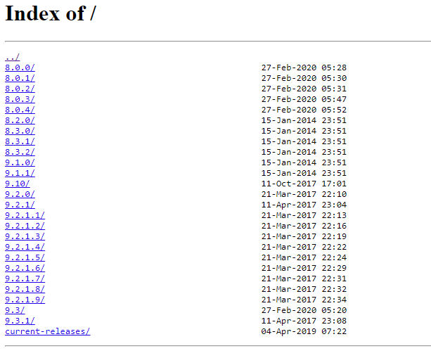

I'm pretty sure older versions can be found somewhere as well, but I'm not sure where at the moment.
Following on for @danb35 here, in case these versions are needed - they're at https://archive.freenas.org
