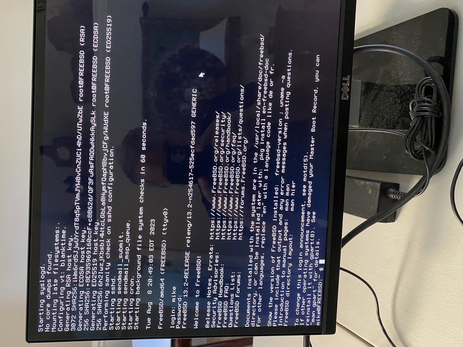

Yes. I put the installation image on the USB and booted and proceeded to install onto my ssd I think this install is successful vs TrueNAS?

I guess you're saying "more successful than TrueNAS" rather than finished successfully with that screenshot.
Are you sure you have followed the installer instructions for TrueNAS to create the boot drive?

I’m not sure what you mean. On freebsd I was able to install onto my ssd disk from usb and now i boot into FreeBSD at will and it asks me to log in Is there more to FreeBSD than that? I’m not familiar with the commands but I was able to get to the manual directory, what additional would you have me do to ensure it is running freeBSD properly?

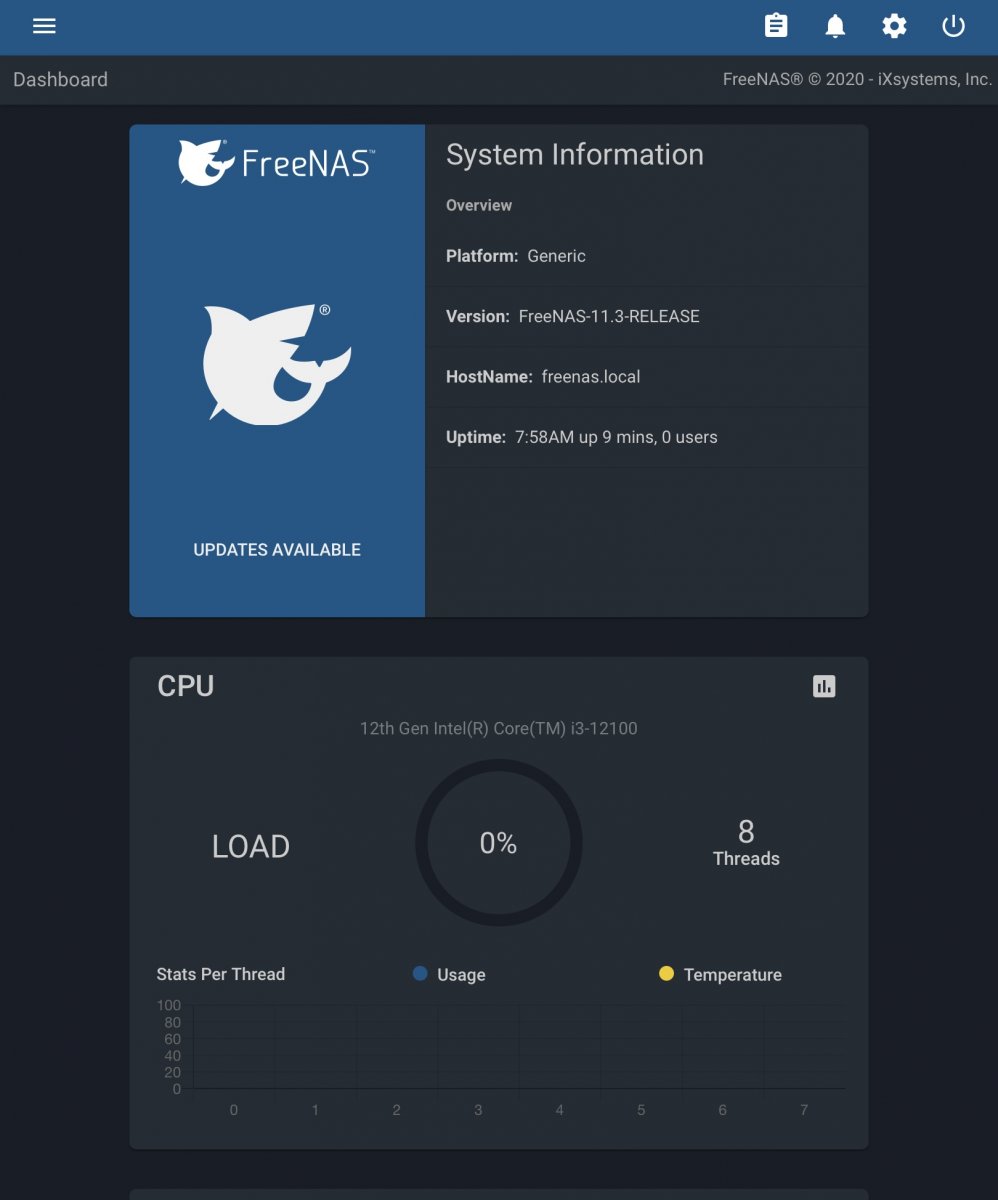

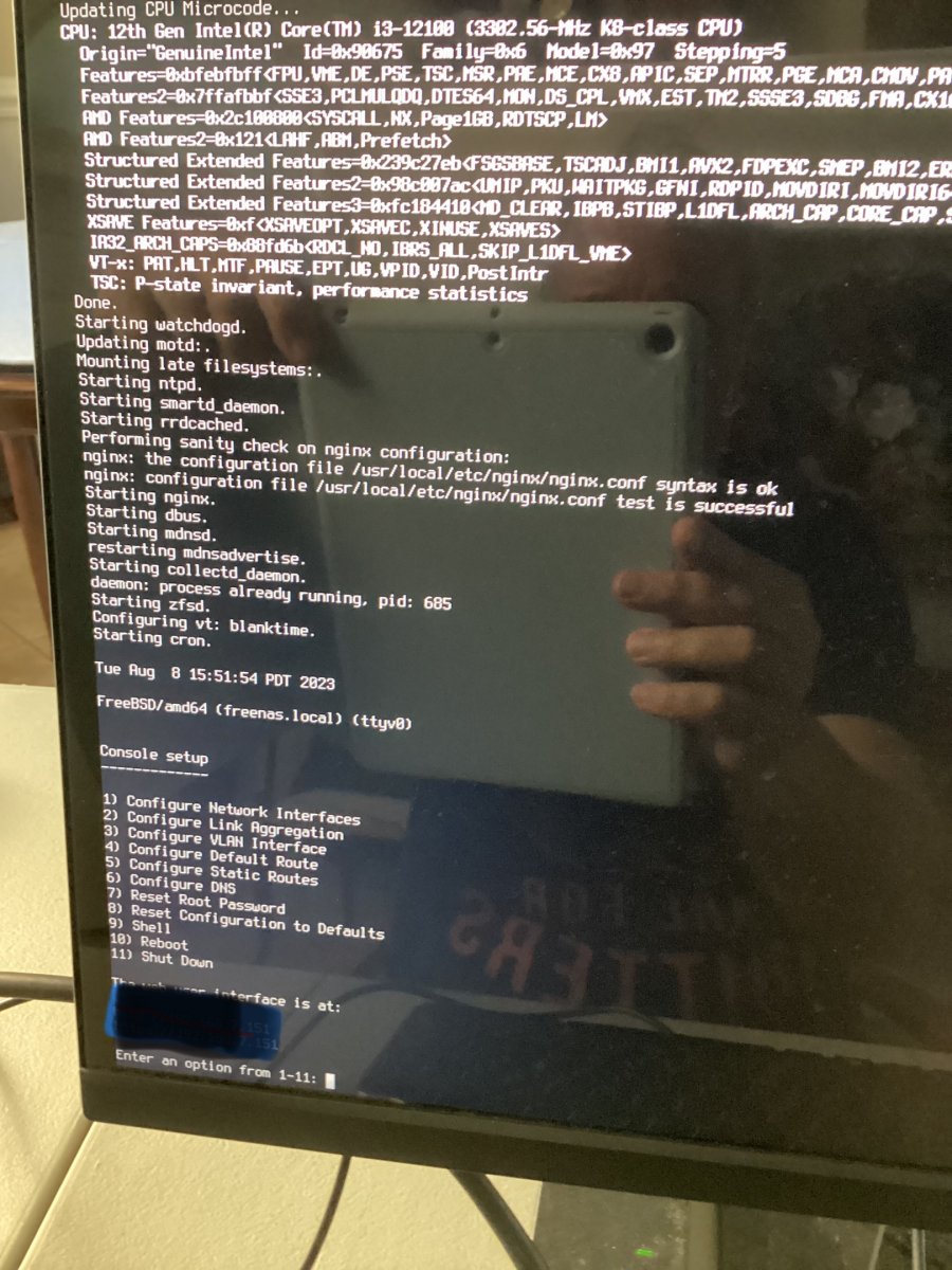

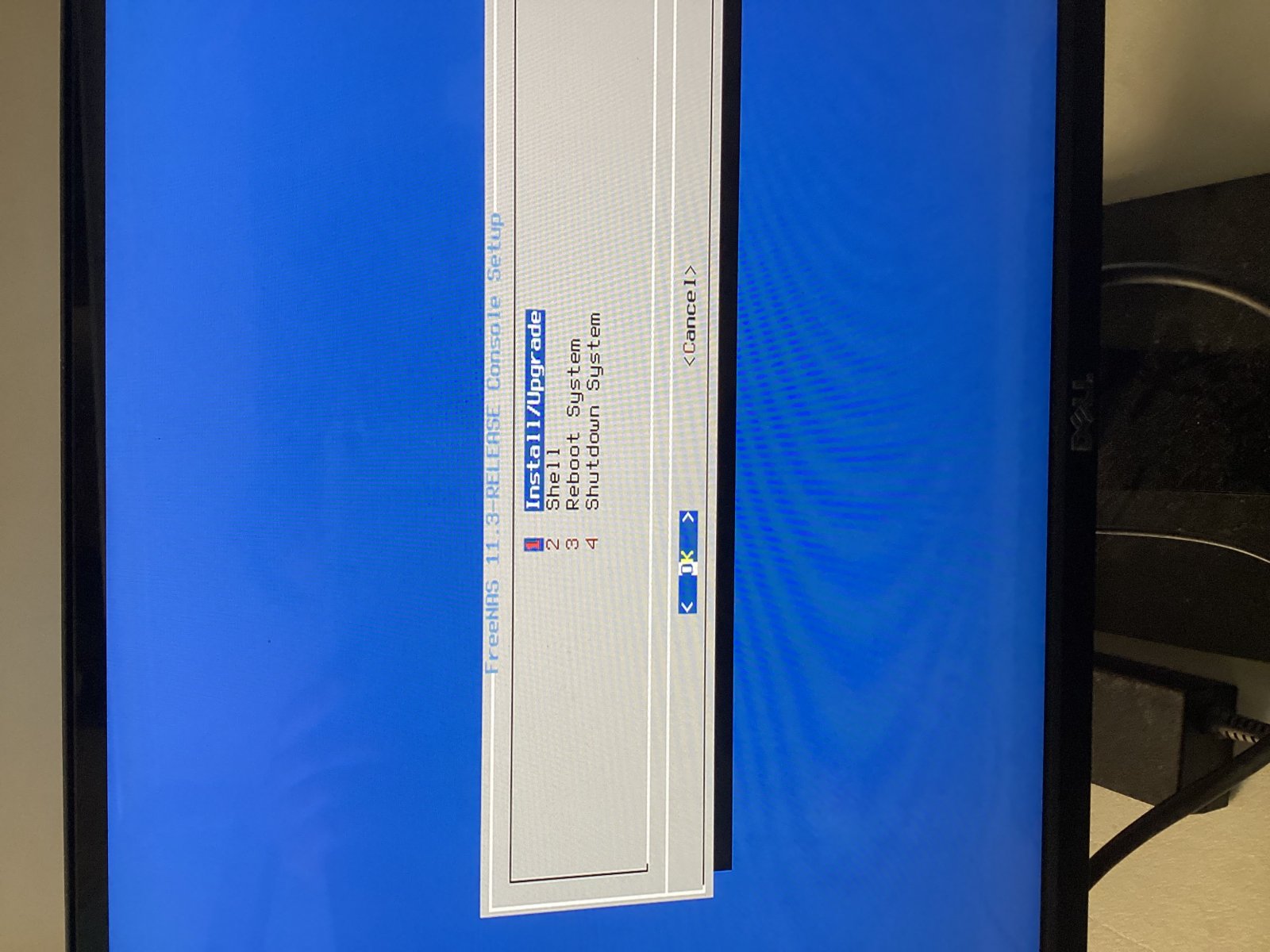

well well. So I just tried FreeNAS 11.3 for laughs and giggles. It works! the installer works flawlessly. I used same exact process for burning the USB stick. Installed on my ssd . So something in TrueNAS build barfs at my core I3 12th gen and Asus mobo hw setup.

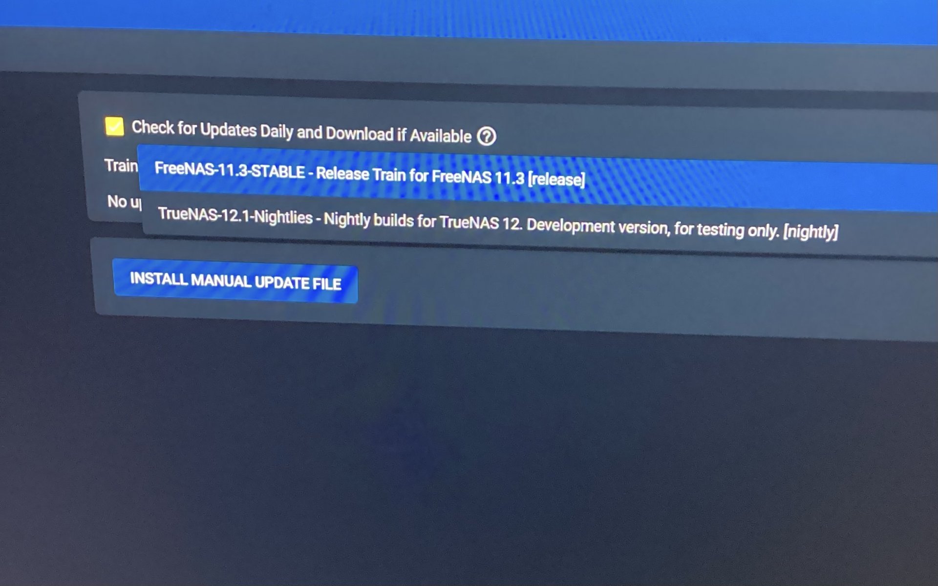

These are my options for updates now after updating with 11.3 stable. Should I accept the trueNAS 12.1 nightly ???

You should probably manually upgrade to a version (the latest one if you can) of 12 first.

The various 13 tar files I’ve tried dont seem to be liked. Getting 12.0 release now
any ideas why it only allows a nightly 12 truenas in the drop down of updates available.? Comes with warning that “nightly” is a one way process

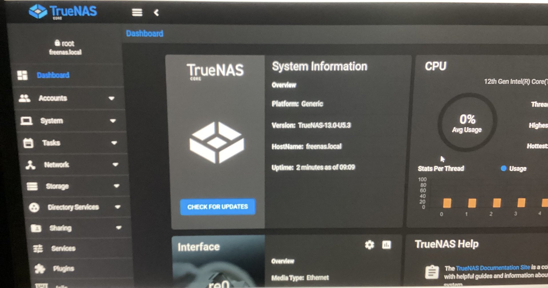

MikeTrainer
Aug 7, 2023
16

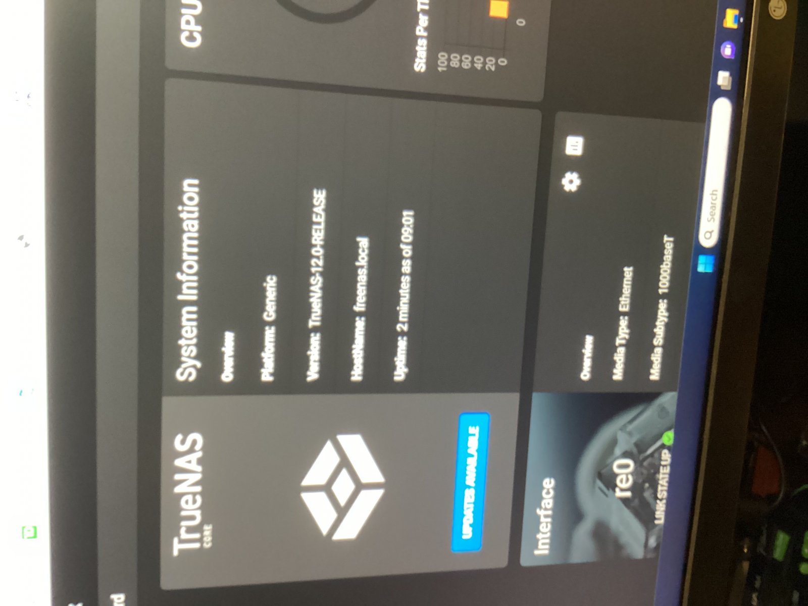

Updating to stable 13 now as it gave me the option to do so on the pull-down. Assuming all works this is a solution to the several users I’ve seen that get berated for using unconventional non server specific hardware if TrueNAS hangs on white square during install 5en try Freenas 11.3 and then update via the web interface to Truenas 12 and then to the latest. Finally restore config file
