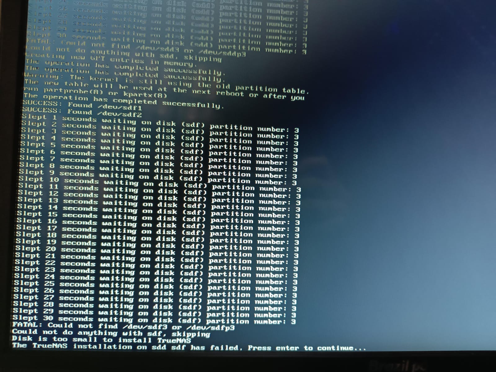

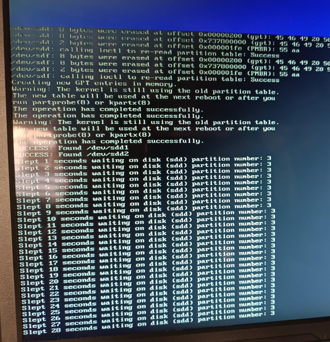

When trying to install, after selecting the 2 mirrored USB Sticks as boot drivers, confirming the wiping of the sticks and setting the root password, the installation never show the "Create 16gb SWAP partition" screen, and proceeds with the process on the images bellow, ending in the error "The TrueNAS instalation on sdd sdf has failed. Press enter to continue..."

Using USB sticks is not recommended but I'll assume you know that already. If there's no reason why you can't, rather invest in a cheap SSD.
In one of the screens it says the drives are too small and if I understand correctly you don't even get to choose whether to create a swap partition or not.
You are using windows. What you could try use something like ease us partition master to wipe all partitions, just to make sure there are no partitions left that interfere with the usable size. I'm not sure the tools shipped with Windows can see / wipe all partitions. What size is displayed in windows for the sticks?
Edit: that beeing said, I don't know whether they changed the minimum size for the boot pool without updating the docs. I doubt 32GB isn't enough and I don't think they did.
I re-read all the screens, and only see now the prompt at the end, thanks for pointing out
It shows as 28.87gb in Windows, in the TrueNAS installer and in TrueNAS running on EMMC.

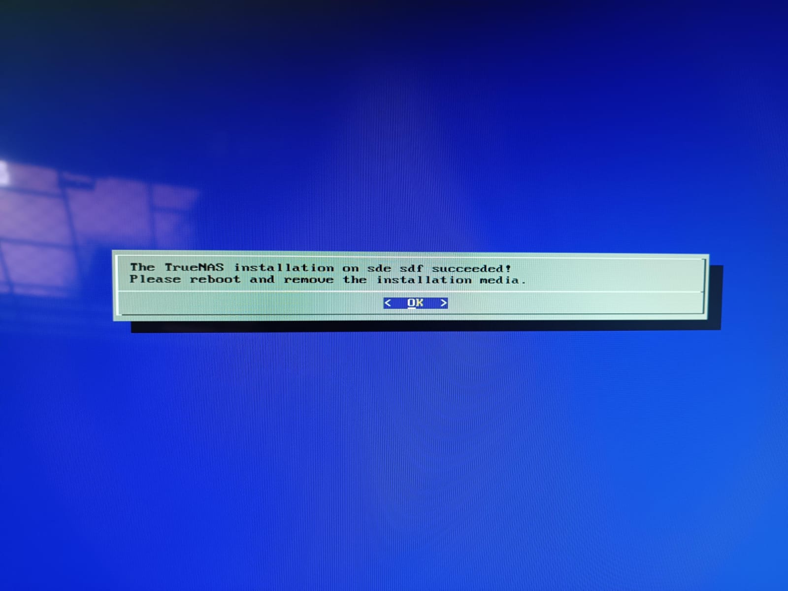

FADK
Jun 20, 2023
7
After wiping both Exodia USB Stick with ease us partition master the installation went normally, thanks for the help!!
