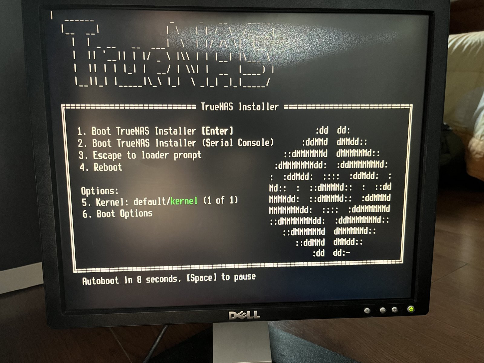

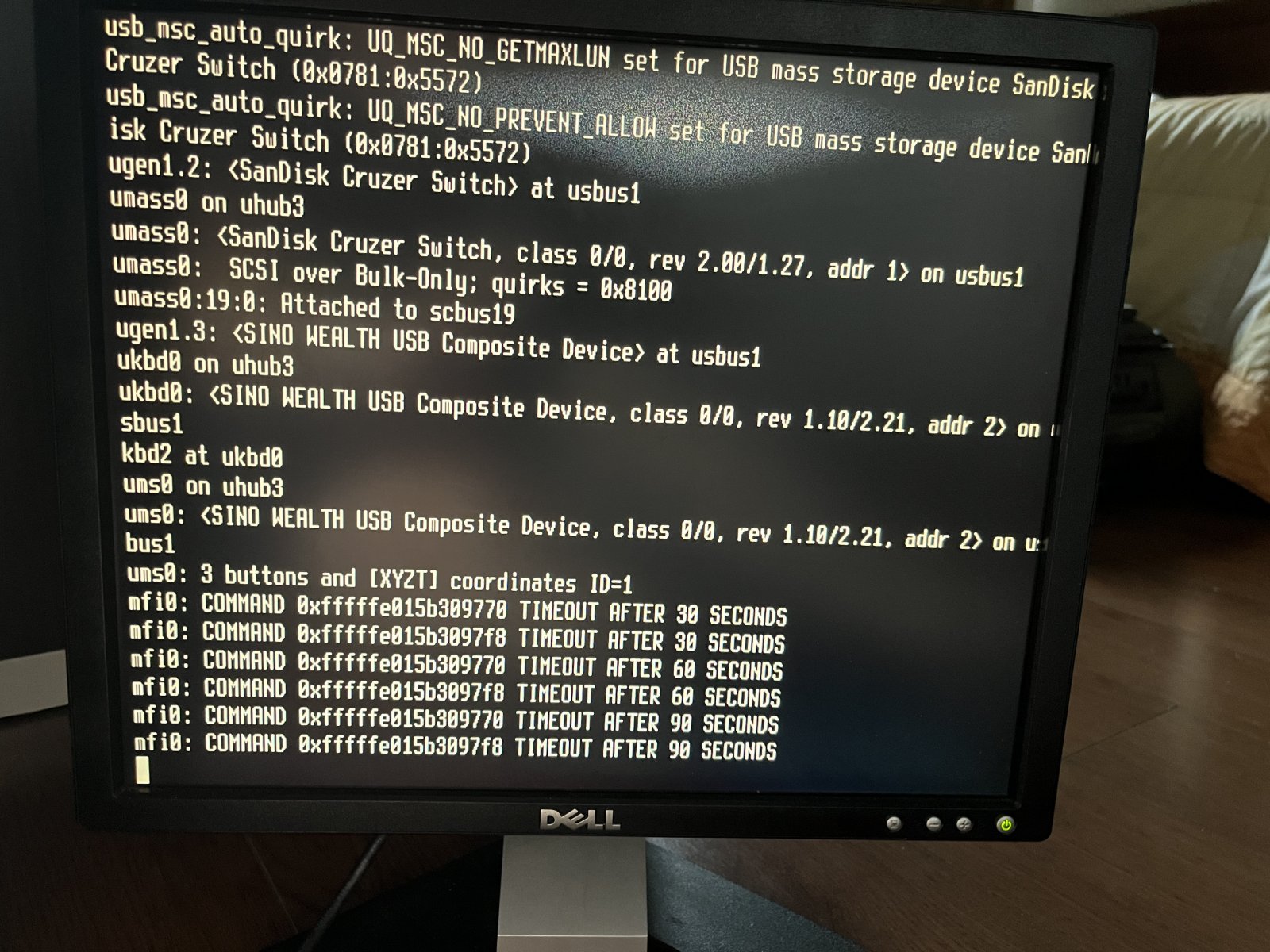

I have set the bios to boot from the Sandisk USB install disk. This boots and displays the TrueNAS Installer (see image below). Whether you select option 1 or leave it to default it scrolls passed various commands until it reaches "ums0: 3 buttons and [XYZT] coordinates ID=1" where the screen pauses and then starts displaying COMMAND xxxxxx TIMEOUT every 30 seconds (See second image bellow). I have waited for up to 420 seconds before giving up and either powering the machine off or using the reset button.
I have no idea what the timed out commands are, but I know from the TrueNAS Core installation video that the installation menu should have appeared relatively quickly.

So what are the 6 external disks plugged into? I understand its an external enclosure of some sort. This error points to an MFI driver issue and usually this is a RAID/PERC card or some sort and are generally considered nuh-uh around here. Is the BIOS of this machine set to handle these external enclosure as JBOD/regular SATA ports or is there some sort of RAID happening at a bios level? Did you flash this HBA to IT mode?
