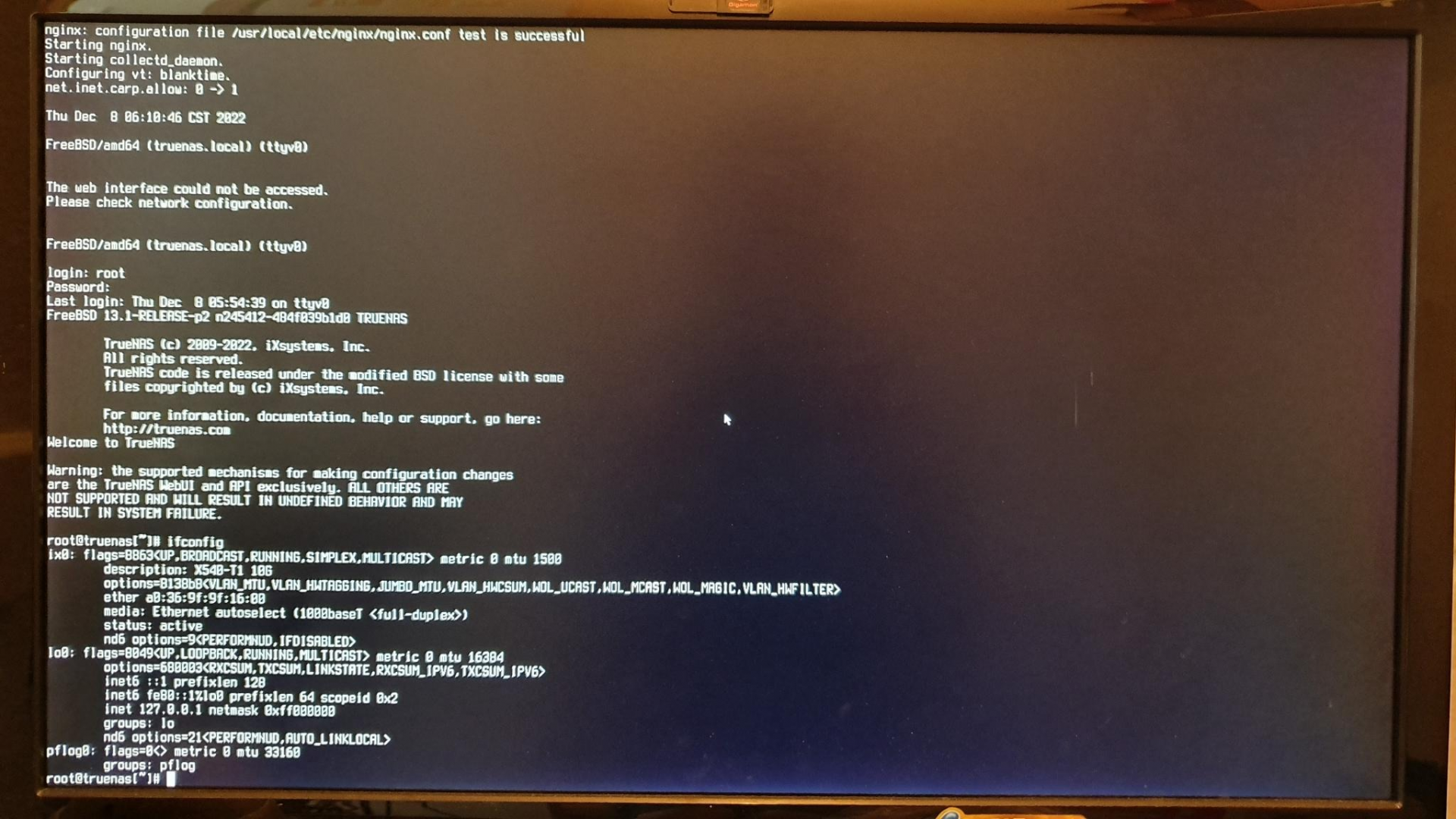

Here is a screenshot with hopefully some relevant information:

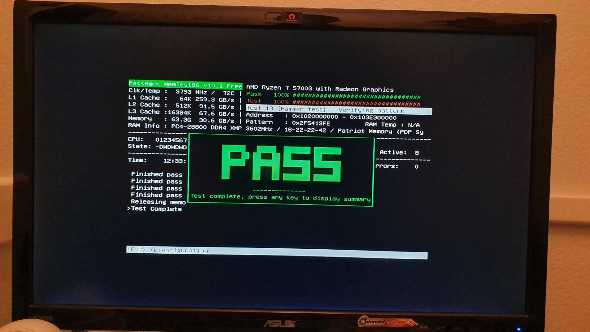

if i understand correctly. It hangs at certain point. You still see something like your picture? But keyboard is not working anymore. Then the first suspect would be the memory. If it is a (kernel) crash you would expect a wall of debug text.

Thanks for the reply. Before upgradign TrueNAS Core to teh version above the interface would come up and web console accessible. After the upgrade the interfaces stopped working. Both then and now, at some point the screen goes blank and the system is unresponsive. Pressing reset or holding power button does nothing. I have to kill the power supply to shut off.
Now, after the upgrade, while the screen is up you see the pic above. The OS seems responsive but neither the onboard LAN (realtek, I think) or the Intel 520 PCIe card seem to work.
If memory was bad I assume I would not get this far, but I don't know. I don't know how to run any self-diagnostics. Any hints are appreciated.

Ok thanks for the tip. Will give that a try before I rebuild, I am really dreading that process.

if you reset your network from the console UI it will accept connections on any interface it finds, similar to first setup
