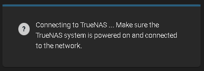

Hello,
I am running a TrueNAS over Hyper-V to storage kubernetes volumes. I am aware this is not a best architecture, we are already installing TrueNAS 13 on a Dell R610 + Perc310 IT mode.
Our tank pool is 95% full. I was logged via SSH when it suddenly freezed. UI is not working too.

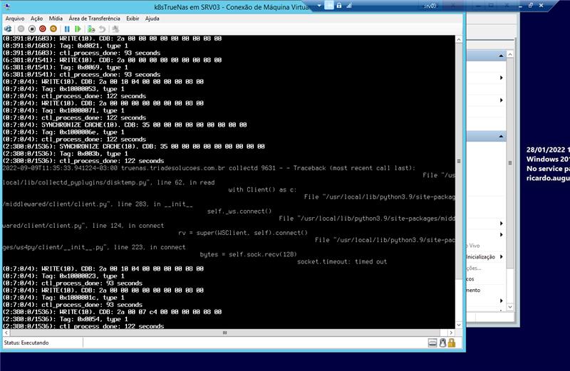

I went to hyper-V console and I saw this message:
Any suggestions? Thanks

You're getting disk timeouts, likely the result of several compounding issues:
1. Your pool is almost completely full (458M free!) so performance will be significantly impacted (free space fragmentation, metaslab allocator working extremely hard) - please post zpool list output in CODE tags, and try to curtail or stop additional writes as filling your pool to 100% will be extremely bad.
tank                                                      539G   458M      104K  /mnt/tank
2. You appear to be presenting a single virtual disk to TrueNAS, and the number of zvols/containers may be flooding the I/O queue (which is made worse by the almost-full status) of a single vdev.
Please describe your Hyper-V host hardware and TrueNAS guest configuration as much as possible.
Sounds like you're taking steps to rectify this problem already. Make sure you flash proper LSI firmware onto the H310 as the stock queue depth is very small (25). This may require special steps if the H310 is a "Mini/Mono" card.
Please post other hardware details if you can as well so we can investigate RAM/CPU amounts (as well as ensure that you're building in a sufficient amount of free space!)

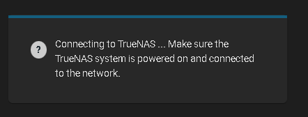

Hello. My TrueNAS 12 freezed again, I cant connect UI.
I connected via ssh:

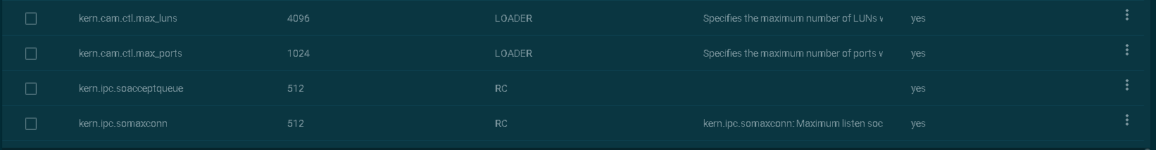

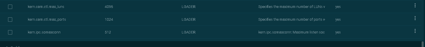

How Can I increase kern.ipc.somaxconn?
9,700
Seems to me that you're using LOADER type tunables for a SYSCTL value... seems a simple solution to that... use the SYSCTL type instead.
sekroots
Feb 28, 2022
61
Hello, thanks for your reply. I did this:
sysctl kern.ipc.somaxconn=512
But it didn´t worked.
9,700
I did this:
And after that, when you type:
sysctl kern.ipc.somaxconn does it show that it's set or not?

sekroots
Feb 28, 2022
61
I change my tunables to this:
But I still cannot set max connections:
