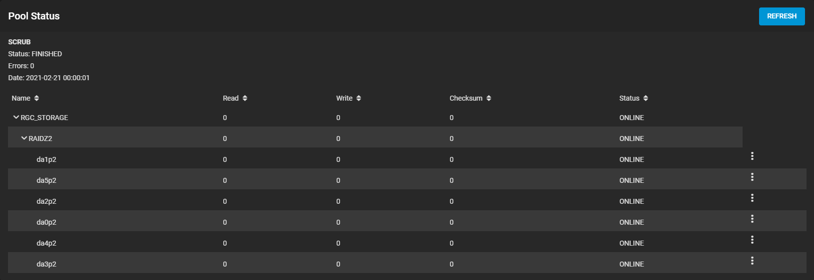

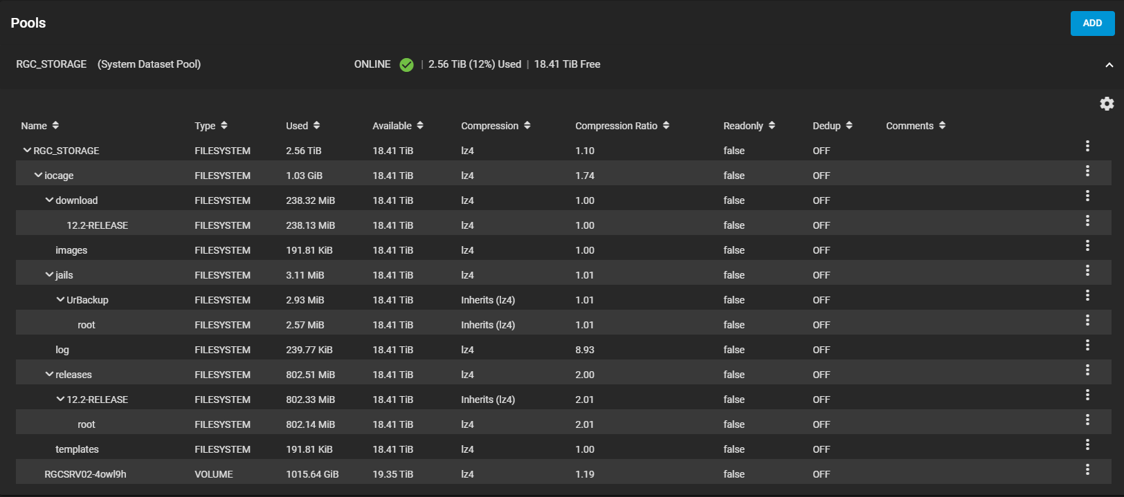

How is your pool RGC_STORAGE constructed?

The disks are virtually brand new, probably 6 months old and only using 2TB. I have 6 disks, 6TB each, and RaidZ2. When you ask how is the RGC_STORAGE constructed, here are two screenshots that hopefully have what you are looking for. Let me know what else you are looking for...

OK, it looks like your CPU doesn't have AES-NI, so the swap partitions are GELI-encrypted using software. I wonder if your HBA just isn't fast enough for this. Could you try moving all your disks to the onboard SATA ports?
