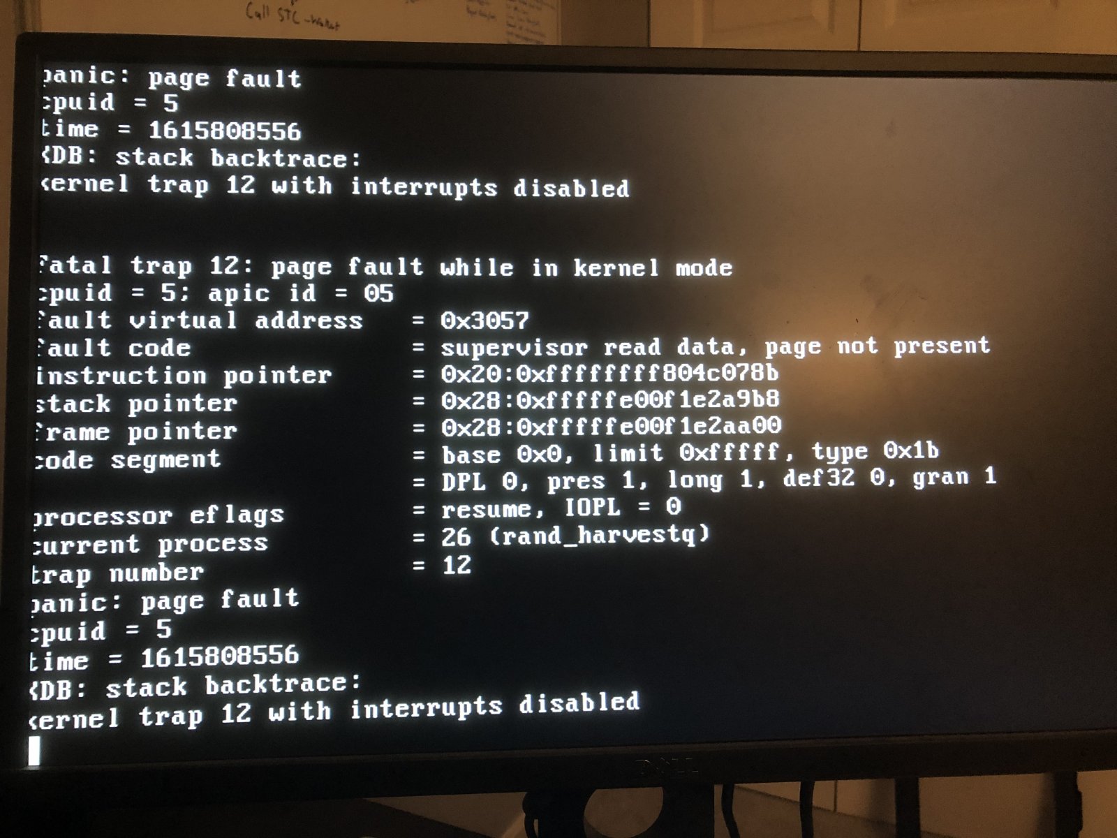

I built a truenas server for our non-profit, see build details below. At some point the server had trouble booting, I now think it might be related after adding a VM or Jail. Most of the time the kernel panics on boot after being unable to start "ntpd". (see screenshots) I replaced the power supply thinking maybe it was a power issue, issue persists. I turned off AutoStart for the jail the last time it was booted successfully, so I am not sure it is jail related - although I had several issues when creating the jail or starting it it would cause a panic.
I need help troubleshooting with a few things...
1) How do turn off my vm (bhyve) from auto starting from single user mode within boot options? - at the moment I haven't been lucky today to get a good boot.
2) How can I turn on capturing the core dumps or panic error? The screen is almost refreshing too fast. (see screenshots below)
FYI - I got a two USB drives, created new install media with 12.0-U2.1 and used the other as a boot media. When I reinstalled Freenas it worked fine, rebooted like 20 times, no issue. When I restored my configuration, issue came back. So it is either the VM, Jail, Pool issue, maybe not hardware at this point since new install worked fine.

When I start the VM I am able to see windows loading screen in VNC and then shortly after I get the following as the error message. It took a little while to reboot so I think it core dumped.
dfalke
Mar 12, 2021
31
Ok one additional plot twist, I was creating a SMB share to get the core dumps off the server and when I started the SMB service I get very similar panic so the issue doesn't seem to be exclusive to the VM. Do I have bios settings incorrect on the SuperMicro?

Attached is from the \data\crash directory for when I started the SMB share, latest panic.
