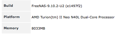

I am using HP ProLiant Micro G7 - http://www8.hp.com/nz/en/pdf/HP_ProLiant_MicroServer_tcm_194_1127013.pdf
It has an expansion slot with two extra interfaces.
I am using the most recent version of FreeNAS 9.10.2-U2
