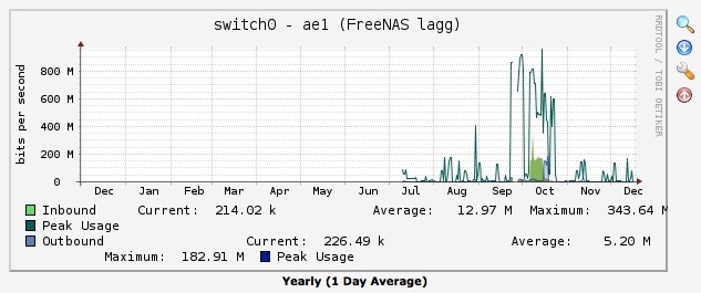

I no longer have a cisco switch to post the configs for. I've switched to Juniper. I haven't noticed any performance problems with LACP with 8.x or 9.x. Tests with a single host regularly achieve up to 900Mbit (have to copy a suitably large file to get that, something several gigs in size. video frequently works well here).
The Juniper config bits look like:
set interfaces ge-0/0/40 description "FreeNAS Trunk port"
set interfaces ge-0/0/40 ether-options 802.3ad ae1
set interfaces ge-0/0/41 description "FreeNAS Trunk port"
set interfaces ge-0/0/41 ether-options 802.3ad ae1
set interfaces ae1 description "FreeNAS lagg"
set interfaces ae1 aggregated-ether-options lacp passive
set interfaces ae1 aggregated-ether-options lacp periodic slow
set interfaces ae1 unit 0 family ethernet-switching
set vlans prod interface ae1.0
louisk@switch0.cmhome> show interfaces ae1
Physical interface: ae1, Enabled, Physical link is Up
Interface index: 130, SNMP ifIndex: 616
Description: FreeNAS lagg
Link-level type: Ethernet, MTU: 1514, Speed: 2Gbps, BPDU Error: None, MAC-REWRITE Error: None, Loopback: Disabled, Source filtering: Disabled,
Flow control: Disabled, Minimum links needed: 1, Minimum bandwidth needed: 0
Device flags : Present Running
Interface flags: SNMP-Traps Internal: 0x0
Current address: 08:81:f4:a2:4d:84, Hardware address: 08:81:f4:a2:4d:84
Last flapped : 2013-09-22 20:00:42 PDT (3w1d 16:15 ago)
Input rate : 7664 bps (9 pps)
Output rate : 80576 bps (10 pps)
Logical interface ae1.0 (Index 69) (SNMP ifIndex 619)
Flags: SNMP-Traps 0x0 Encapsulation: ENET2
Statistics Packets pps Bytes bps
Bundle:
Input : 5724 0 343440 0
Output: 1030416 0 110253212 0
Protocol eth-switch
Flags: None
{master:0}
louisk@switch0.cmhome> show lacp interfaces ae1
Aggregated interface: ae1
LACP state: Role Exp Def Dist Col Syn Aggr Timeout Activity
ge-0/0/40 Actor No No Yes Yes Yes Yes Slow Passive
ge-0/0/40 Partner No No Yes Yes Yes Yes Slow Active
ge-0/0/41 Actor No No Yes Yes Yes Yes Slow Passive
ge-0/0/41 Partner No No Yes Yes Yes Yes Slow Active
LACP protocol: Receive State Transmit State Mux State
ge-0/0/40 Current Slow periodic Collecting distributing
ge-0/0/41 Current Slow periodic Collecting distributing
{master:0}
