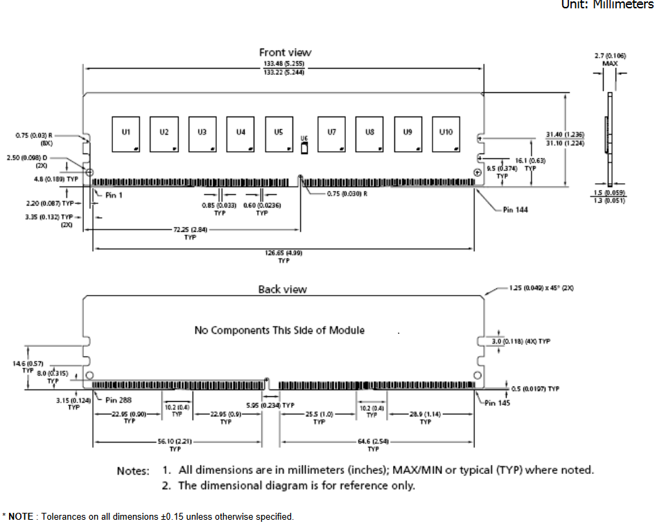

As the paper was for DDR3, you of course need find the pin layout of DDR4, before you can apply it on Ryzen. Following datasheet has pretty clear pin layout of unregistered ECC DDR4 module:
On page 6, 7 and 8 you can see the description per pin and on page 17 you can see a picture of where those pin numbers are on the memory module. I suppose all VSS-pins are ground pins and DQ+number pins are data pins. So if we follow the example of the paper and short DQ0 with a VSS, the corresponds to shorting pin-4 (VSS) with pin-5 (DQ0). But I guess shorting pin-2 (VSS) with pin-3 (DQ4) could work equally fine.
This should help us "understand" a bit better what Diversity has done and how to "safely" reproduce it.

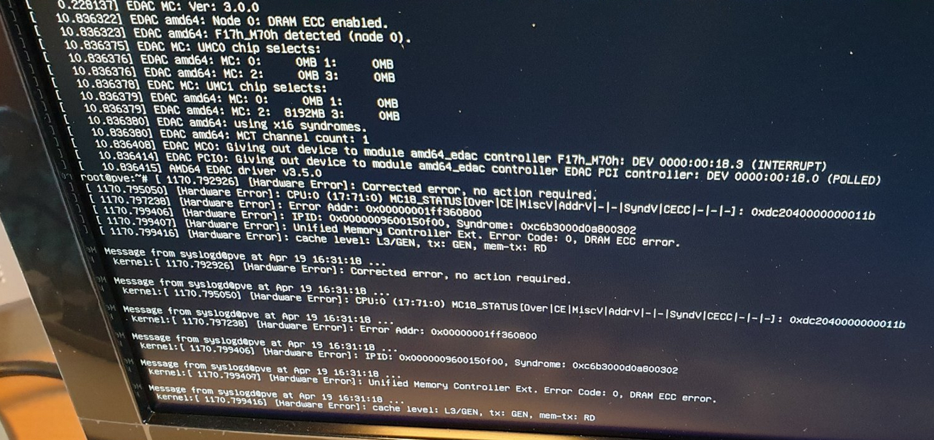

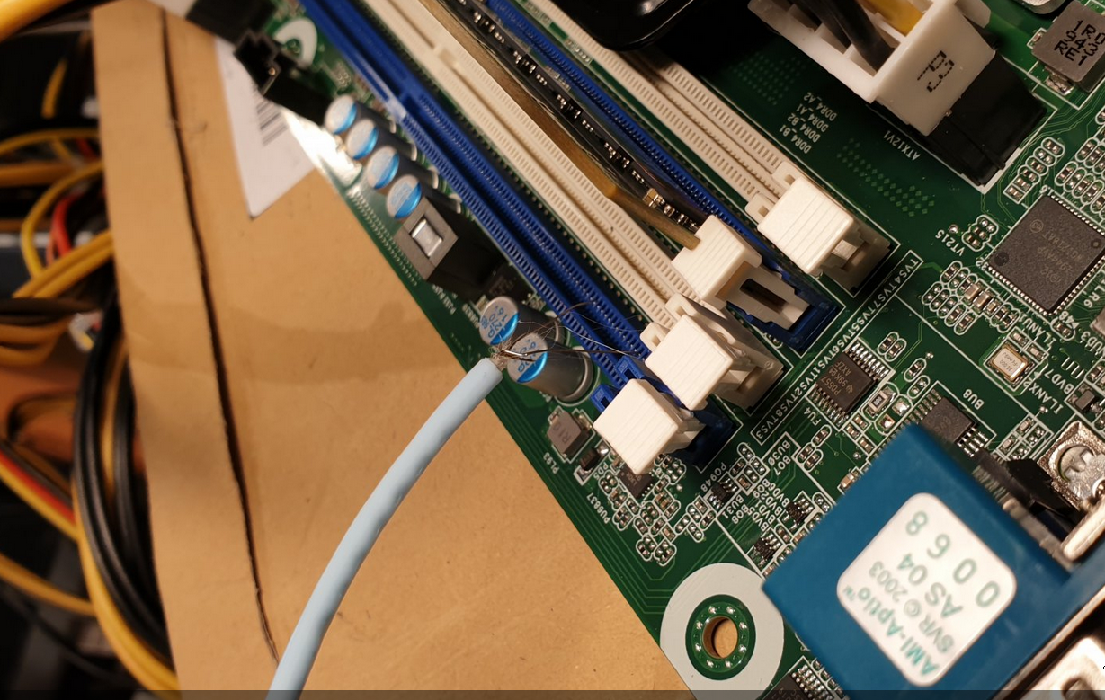

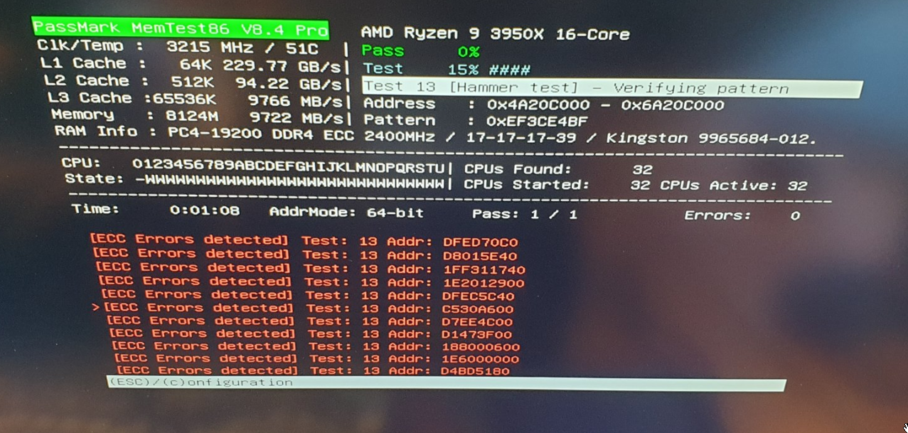

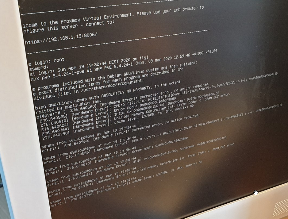

The results from Diversity
I was in contact with Diversity and have some more details on his testing (all pictures in this "chapter" are from Diversity himself). Diversity used the following video: https://www.youtube.com/watch?v=_npcmCxH2Ig. Instead of needles and tweezers, he used a thin wire, as in the picture below.
He was able to trigger "ECC errors" in Memtest86 and "Corrected errors" in Linux (Proxmox).

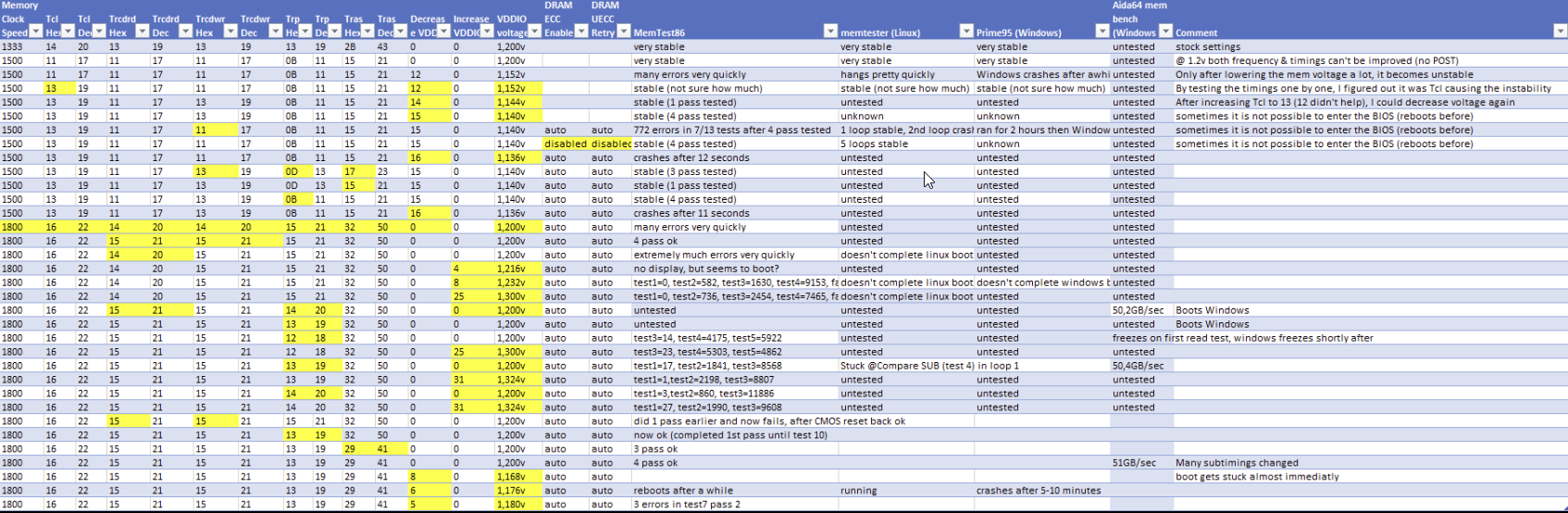

As you know, I also tried triggering reporting of corrected memory errors. I tried this by overclocking / undervolting the memory to the point where it is on the edge of stability. This edge is very "thin", can be hard to reach and can result in the following scenarios in my understanding:
1) Not unstable enough, so no errors at all
2) Only just unstable enough, so that single-bit error occurs only sometimes when stressing the memory enough. These will then be corrected by ECC and will not cause faults or crashes.
3) A little more unstable, so that single-bit errors occur a bit more often and less stress is required on the memory to achieve this. But also (uncorrected) multi-bit errors can occur sometimes, which could cause faults / crashes.
4) Even a little bit more unstable, so that mostly multi-bit errors occur when stressing the memory and single bit errors might be rare. This also makes the system more prone to faults and crashes.
5) Even more unstable, so the multi-bit errors occur even when hardly stressing the memory at all. This makes the system very unstable and probably will not be able to boot into OS all the time.
6) Too unstable, so that it doesn't boot at all.
Both scenario 2) and 3) are "good enough" for testing reporting of corrected memory errors. Perhaps even scenario 4), if you're lucky...
During all my testing I tried 100+ possible memory settings, using all kinds of frequencies, timings and voltages, of which 10-30 were potentially in scenario 2) or 3). I "PARTLY" kept track of all testing in the below (incomplete) Excel:
This convinced me that I should have at least once been in scenario 2) or 3), where I should have seen corrected errors (but didn't). That is why I concluded that it didn't work and I contacted Asrock Rack and AMD to work on this.

In Proxmox screenshots I do read things like "Unified Memory Controller..." and "Cache level: L3/GEN...", but again, I'm not entirely sure if these mean that the errors are in 2) or 3) instead of 1)...

May 20 00:08:59 localhost rasdaemon[995]: rasdaemon: mce_record store: 0x55aaea8a19e8
May 20 00:08:59 localhost kernel: mce_notify_irq: 1 callbacks suppressed
May 20 00:08:59 localhost kernel: mce: [Hardware Error]: Machine check events logged
May 20 00:08:59 localhost kernel: [Hardware Error]: Corrected error, no action required.
May 20 00:08:59 localhost kernel: [Hardware Error]: CPU:0 (17:71:0) MC17_STATUS[Over|CE|MiscV|AddrV|-|-|SyndV|CECC|-|-|-]: 0xdc2040000000011b
May 20 00:08:59 localhost kernel: [Hardware Error]: Error Addr: 0x00000003080ccb40
May 20 00:08:59 localhost kernel: [Hardware Error]: IPID: 0x0000009600050f00, Syndrome: 0xf79c00000b800003
May 20 00:08:59 localhost kernel: [Hardware Error]: Unified Memory Controller Ext. Error Code: 0, DRAM ECC error.
May 20 00:08:59 localhost kernel: EDAC MC0: 1 CE Cannot decode normalized address on mc#0csrow#3channel#0 (csrow:3 channel:0 page:0x0 offset:0x0 grain:64 syndrome:0x0)
May 20 00:08:59 localhost kernel: [Hardware Error]: cache level: L3/GEN, tx: GEN, mem-tx: RD
May 20 00:08:59 localhost kernel: [Hardware Error]: CPU:0 (17:71:0) MC18_STATUS[Over|CE|MiscV|AddrV|-|-|SyndV|CECC|-|-|-]: 0xdc2040000000011b
May 20 00:08:59 localhost kernel: [Hardware Error]: Error Addr: 0x00000003095cc100
May 20 00:08:59 localhost kernel: [Hardware Error]: IPID: 0x0000009600150f00, Syndrome: 0x510600800a800302
May 20 00:08:59 localhost kernel: EDAC MC0: 1 CE Cannot decode normalized address on mc#0csrow#2channel#1 (csrow:2 channel:1 page:0x0 offset:0x0 grain:64 syndrome:0x80)
May 20 00:08:59 localhost rasdaemon[995]: rasdaemon: register inserted at db
May 20 00:08:59 localhost rasdaemon[995]:           <...>-661   [000]     0.000066: mce_record:           2020-04-01 19:34:33 +0200 Unified Memory Controller (bank=17), status= dc2040000000011b, Corrected error, no action required., mci=Error_overflow CECC, mca= DRAM ECC error.
May 20 00:08:59 localhost rasdaemon[995]: Memory Error 'mem-tx: generic read, tx: generic, level: L3/generic', memory_channel=0,csrow=3, cpu_type= AMD Family 17h Zen1, cpu= 0, socketid= 0, misc= d01a0f7c01000000, addr= 3080ccb40, synd= f79c00000b800003, ipid= 9600050f00, mcgstatus=0, mcgcap= 11c, apicid= 0
May 20 00:08:59 localhost rasdaemon[995]: rasdaemon: mc_event store: 0x55aaea8a4418
May 20 00:08:59 localhost rasdaemon[995]:           <...>-661   [000]     0.000066: mc_event:             2020-04-01 19:34:33 +0200 1 Corrected error: Cannot decode normalized address on mc#0csrow#3channel#0 (mc: 0 location: 3:0 grain: 6)
May 20 00:08:59 localhost rasdaemon[995]:           <...>-661   [000]     0.000066: mce_record:           2020-04-01 19:34:33 +0200 Unified Memory Controller (bank=18), status= dc2040000000011b, Corrected error, no action required., mci=Error_overflow CECC, mca= DRAM ECC error.
May 20 00:08:59 localhost rasdaemon[995]: Memory Error 'mem-tx: generic read, tx: generic, level: L3/generic', memory_channel=1,csrow=2, cpu_type= AMD Family 17h Zen1, cpu= 0, socketid= 0, misc= d01a01d301000000, addr= 3095cc100, synd= 510600800a800302, ipid= 9600150f00, mcgstatus=0, mcgcap= 11c, apicid= 0
May 20 00:08:59 localhost rasdaemon[995]:           <...>-661   [000]     0.000066: mc_event:             2020-04-01 19:34:33 +0200 1 Corrected error: Cannot decode normalized address on mc#0csrow#2channel#1 (mc: 0 location: 2:1 grain: 6 syndrome: 0x00000080)
May 20 00:08:59 localhost abrt-server[1611]: Not saving repeating crash in '/boot/vmlinuz-5.6.8-300.fc32.x86_64'
May 20 00:08:59 localhost abrt-server[1614]: Not saving repeating crash in '/boot/vmlinuz-5.6.8-300.fc32.x86_64'
May 20 00:08:59 localhost abrt-server[1618]: Not saving repeating crash in '/boot/vmlinuz-5.6.8-300.fc32.x86_64'
May 20 00:08:59 localhost systemd[1]: Started dbus-:1.3-org.freedesktop.problems@2.service.
May 20 00:08:59 localhost audit[1]: SERVICE_START pid=1 uid=0 auid=4294967295 ses=4294967295 subj=system_u:system_r:init_t:s0 msg='unit=dbus-:1.3-org.freedesktop.problems@2 comm="systemd" exe="/usr/lib/systemd/systemd" hostname=? addr=? terminal=? res=success'
May 20 00:09:00 localhost abrt-dump-journal-oops[1036]: abrt-dump-journal-oops: Found oopses: 1
May 20 00:09:00 localhost abrt-dump-journal-oops[1036]: abrt-dump-journal-oops: Creating problem directories
May 20 00:09:00 localhost abrt-notification[1657]: System encountered a non-fatal error in ??()
May 20 00:09:01 localhost abrt-dump-journal-oops[1036]: Reported 1 kernel oopses to Abrt
May 20 00:11:12 localhost systemd[1]: dbus-:1.3-org.freedesktop.problems@2.service: Succeeded.
May 20 00:11:12 localhost audit[1]: SERVICE_STOP pid=1 uid=0 auid=4294967295 ses=4294967295 subj=system_u:system_r:init_t:s0 msg='unit=dbus-:1.3-org.freedesktop.problems@2 comm="systemd" exe="/usr/lib/systemd/systemd" hostname=? addr=? terminal=? res=success'
May 20 00:12:15 localhost kernel: mce: [Hardware Error]: Machine check events logged
May 20 00:12:15 localhost kernel: [Hardware Error]: Corrected error, no action required.
May 20 00:12:15 localhost kernel: [Hardware Error]: CPU:0 (17:71:0) MC17_STATUS[Over|CE|MiscV|AddrV|-|-|SyndV|CECC|-|-|-]: 0xdc2040000000011b
May 20 00:12:15 localhost kernel: [Hardware Error]: Error Addr: 0x0000000301a4ef80
May 20 00:12:15 localhost kernel: [Hardware Error]: IPID: 0x0000009600050f00, Syndrome: 0xf79c00000b800003
May 20 00:12:15 localhost kernel: [Hardware Error]: Unified Memory Controller Ext. Error Code: 0, DRAM ECC error.
May 20 00:12:15 localhost kernel: EDAC MC0: 1 CE Cannot decode normalized address on mc#0csrow#3channel#0 (csrow:3 channel:0 page:0x0 offset:0x0 grain:64 syndrome:0x0)
May 20 00:12:15 localhost kernel: [Hardware Error]: cache level: L3/GEN, tx: GEN, mem-tx: RD
May 20 00:12:15 localhost rasdaemon[995]: rasdaemon: mce_record store: 0x55aaea8a19e8
May 20 00:12:15 localhost rasdaemon[995]: rasdaemon: register inserted at db
May 20 00:12:15 localhost rasdaemon[995]:           <...>-661   [000]     0.000086: mce_record:           2020-04-01 19:37:49 +0200 Unified Memory Controller (bank=17), status= dc2040000000011b, Corrected error, no action required., mci=Error_overflow CECC, mca= DRAM ECC error.
May 20 00:12:15 localhost rasdaemon[995]: Memory Error 'mem-tx: generic read, tx: generic, level: L3/generic', memory_channel=0,csrow=3, cpu_type= AMD Family 17h Zen1, cpu= 0, socketid= 0, misc= d01b0fff01000000, addr= 301a4ef80, synd= f79c00000b800003, ipid= 9600050f00, mcgstatus=0, mcgcap= 11c, apicid= 0
May 20 00:12:15 localhost rasdaemon[995]: rasdaemon: mc_event store: 0x55aaea8a4418
May 20 00:12:15 localhost rasdaemon[995]:           <...>-661   [000]     0.000086: mc_event:             2020-04-01 19:37:49 +0200 1 Corrected error: Cannot decode normalized address on mc#0csrow#3channel#0 (mc: 0 location: 3:0 grain: 6)
May 20 00:12:15 localhost abrt-server[1674]: Not saving repeating crash in '/boot/vmlinuz-5.6.8-300.fc32.x86_64'
May 20 00:12:15 localhost systemd[1]: Started dbus-:1.3-org.freedesktop.problems@3.service.
May 20 00:12:15 localhost audit[1]: SERVICE_START pid=1 uid=0 auid=4294967295 ses=4294967295 subj=system_u:system_r:init_t:s0 msg='unit=dbus-:1.3-org.freedesktop.problems@3 comm="systemd" exe="/usr/lib/systemd/systemd" hostname=? addr=? terminal=? res=success'
May 20 00:12:17 localhost abrt-dump-journal-oops[1036]: abrt-dump-journal-oops: Found oopses: 1
May 20 00:12:17 localhost abrt-dump-journal-oops[1036]: abrt-dump-journal-oops: Creating problem directories
May 20 00:12:17 localhost abrt-notification[1710]: System encountered a non-fatal error in ??()
May 20 00:12:18 localhost abrt-dump-journal-oops[1036]: Reported 1 kernel oopses to Abrt
May 20 00:12:59 localhost systemd[1]: Starting Cleanup of Temporary Directories...
May 20 00:12:59 localhost systemd-tmpfiles[1712]: /usr/lib/tmpfiles.d/BackupPC.conf:1: Line references path below legacy directory /var/run/, updating /var/run/BackupPC → /run/BackupPC; please update the tmpfiles.d/ drop-in file accordingly.
May 20 00:12:59 localhost systemd-tmpfiles[1712]: /etc/tmpfiles.d/tpm2-tss-fapi.conf:3: Line references path below legacy directory /var/run/, updating /var/run/tpm2-tss/eventlog → /run/tpm2-tss/eventlog; please update the tmpfiles.d/ drop-in file accordingly.
May 20 00:12:59 localhost systemd[1]: systemd-tmpfiles-clean.service: Succeeded.
May 20 00:12:59 localhost systemd[1]: Finished Cleanup of Temporary Directories.
May 20 00:12:59 localhost audit[1]: SERVICE_START pid=1 uid=0 auid=4294967295 ses=4294967295 subj=system_u:system_r:init_t:s0 msg='unit=systemd-tmpfiles-clean comm="systemd" exe="/usr/lib/systemd/systemd" hostname=? addr=? terminal=? res=success'
May 20 00:12:59 localhost audit[1]: SERVICE_STOP pid=1 uid=0 auid=4294967295 ses=4294967295 subj=system_u:system_r:init_t:s0 msg='unit=systemd-tmpfiles-clean comm="systemd" exe="/usr/lib/systemd/systemd" hostname=? addr=? terminal=? res=success'
May 20 00:14:26 localhost rasdaemon[995]: rasdaemon: mce_record store: 0x55aaea8a19e8
May 20 00:14:26 localhost kernel: mce: [Hardware Error]: Machine check events logged
May 20 00:14:26 localhost kernel: [Hardware Error]: Corrected error, no action required.
May 20 00:14:26 localhost kernel: [Hardware Error]: CPU:0 (17:71:0) MC17_STATUS[Over|CE|MiscV|AddrV|-|-|SyndV|CECC|-|-|-]: 0xdc2040000000011b
May 20 00:14:26 localhost kernel: [Hardware Error]: Error Addr: 0x0000000395164300
May 20 00:14:26 localhost kernel: [Hardware Error]: IPID: 0x0000009600050f00, Syndrome: 0xf79c00000b800003
May 20 00:14:26 localhost kernel: [Hardware Error]: Unified Memory Controller Ext. Error Code: 0, DRAM ECC error.
May 20 00:14:26 localhost kernel: EDAC MC0: 1 CE Cannot decode normalized address on mc#0csrow#3channel#0 (csrow:3 channel:0 page:0x0 offset:0x0 grain:64 syndrome:0x0)
May 20 00:14:26 localhost kernel: [Hardware Error]: cache level: L3/GEN, tx: GEN, mem-tx: RD
May 20 00:14:26 localhost kernel: [Hardware Error]: CPU:0 (17:71:0) MC18_STATUS[Over|CE|MiscV|AddrV|-|-|SyndV|CECC|-|-|-]: 0xdc2040000000011b
May 20 00:14:26 localhost kernel: [Hardware Error]: Error Addr: 0x000000030088c100
May 20 00:14:26 localhost kernel: [Hardware Error]: IPID: 0x0000009600150f00, Syndrome: 0x510600800a800302
May 20 00:14:26 localhost kernel: EDAC MC0: 1 CE Cannot decode normalized address on mc#0csrow#2channel#1 (csrow:2 channel:1 page:0x0 offset:0x0 grain:64 syndrome:0x80)
May 20 00:14:26 localhost rasdaemon[995]: rasdaemon: register inserted at db
May 20 00:14:26 localhost rasdaemon[995]:           <...>-661   [000]     0.000099: mce_record:           2020-04-01 19:40:01 +0200 Unified Memory Controller (bank=17), status= dc2040000000011b, Corrected error, no action required., mci=Error_overflow CECC, mca= DRAM ECC error.
May 20 00:14:26 localhost rasdaemon[995]: Memory Error 'mem-tx: generic read, tx: generic, level: L3/generic', memory_channel=0,csrow=3, cpu_type= AMD Family 17h Zen1, cpu= 0, socketid= 0, misc= d01b0fff01000000, addr= 395164300, synd= f79c00000b800003, ipid= 9600050f00, mcgstatus=0, mcgcap= 11c, apicid= 0
May 20 00:14:26 localhost rasdaemon[995]: rasdaemon: mc_event store: 0x55aaea8a4418
May 20 00:14:26 localhost rasdaemon[995]:           <...>-661   [000]     0.000099: mc_event:             2020-04-01 19:40:01 +0200 1 Corrected error: Cannot decode normalized address on mc#0csrow#3channel#0 (mc: 0 location: 3:0 grain: 6)
May 20 00:14:26 localhost rasdaemon[995]:           <...>-661   [000]     0.000099: mce_record:           2020-04-01 19:40:01 +0200 Unified Memory Controller (bank=18), status= dc2040000000011b, Corrected error, no action required., mci=Error_overflow CECC, mca= DRAM ECC error.
May 20 00:14:26 localhost rasdaemon[995]: Memory Error 'mem-tx: generic read, tx: generic, level: L3/generic', memory_channel=1,csrow=2, cpu_type= AMD Family 17h Zen1, cpu= 0, socketid= 0, misc= d01a033c01000000, addr= 30088c100, synd= 510600800a800302, ipid= 9600150f00, mcgstatus=0, mcgcap= 11c, apicid= 0
May 20 00:14:26 localhost rasdaemon[995]:           <...>-661   [000]     0.000099: mc_event:             2020-04-01 19:40:01 +0200 1 Corrected error: Cannot decode normalized address on mc#0csrow#2channel#1 (mc: 0 location: 2:1 grain: 6 syndrome: 0x00000080)
May 20 00:14:26 localhost abrt-server[1729]: Not saving repeating crash in '/boot/vmlinuz-5.6.8-300.fc32.x86_64'
May 20 00:14:26 localhost abrt-server[1732]: Not saving repeating crash in '/boot/vmlinuz-5.6.8-300.fc32.x86_64'
May 20 00:14:26 localhost abrt-server[1735]: Not saving repeating crash in '/boot/vmlinuz-5.6.8-300.fc32.x86_64'
May 20 00:14:28 localhost abrt-dump-journal-oops[1036]: abrt-dump-journal-oops: Found oopses: 1
May 20 00:14:28 localhost abrt-dump-journal-oops[1036]: abrt-dump-journal-oops: Creating problem directories
May 20 00:14:28 localhost abrt-notification[1772]: System encountered a non-fatal error in ??()
May 20 00:14:28 localhost systemd[1]: dbus-:1.3-org.freedesktop.problems@3.service: Succeeded.
May 20 00:14:28 localhost audit[1]: SERVICE_STOP pid=1 uid=0 auid=4294967295 ses=4294967295 subj=system_u:system_r:init_t:s0 msg='unit=dbus-:1.3-org.freedesktop.problems@3 comm="systemd" exe="/usr/lib/systemd/systemd" hostname=? addr=? terminal=? res=success'
May 20 00:14:29 localhost abrt-dump-journal-oops[1036]: Reported 1 kernel oopses to Abrt
May 20 00:17:03 localhost rasdaemon[995]: rasdaemon: mce_record store: 0x55aaea8a19e8
May 20 00:17:03 localhost kernel: mce: Uncorrected hardware memory error in user-access at 621211640
May 20 00:17:03 localhost kernel: mce: [Hardware Error]: Machine check events logged
May 20 00:17:03 localhost kernel: [Hardware Error]: Uncorrected, software restartable error.
May 20 00:17:03 localhost kernel: [Hardware Error]: CPU:9 (17:71:0) MC0_STATUS[-|UE|MiscV|AddrV|-|-|-|UECC|-|Poison|-]: 0xbc002800000c0135
May 20 00:17:03 localhost kernel: [Hardware Error]: Error Addr: 0x0000000621211640
May 20 00:17:03 localhost kernel: [Hardware Error]: IPID: 0x000000b000000000
May 20 00:17:03 localhost kernel: [Hardware Error]: Load Store Unit Ext. Error Code: 12, DC Data error type 1 and poison consumption.
May 20 00:17:03 localhost kernel: [Hardware Error]: cache level: L1, tx: DATA, mem-tx: DRD
May 20 00:17:03 localhost kernel: Memory failure: 0x621211: Sending SIGBUS to memtester:1666 due to hardware memory corruption
May 20 00:17:03 localhost kernel: Memory failure: 0x621211: recovery action for dirty LRU page: Recovered
May 20 00:17:03 localhost audit[1666]: ANOM_ABEND auid=0 uid=0 gid=0 ses=1 subj=unconfined_u:unconfined_r:unconfined_t:s0-s0:c0.c1023 pid=1666 comm="memtester" exe="/usr/bin/memtester" sig=7 res=1
May 20 00:17:03 localhost rasdaemon[995]: rasdaemon: register inserted at db
May 20 00:17:03 localhost rasdaemon[995]:           <...>-213   [009]     0.000114: mce_record:           2020-04-01 19:42:37 +0200 Load Store Unit (bank=0), status= bc002800000c0135, Uncorrected, software containable error., mci=UECC Poison consumed, mca= DC data error type 1 (poison consumption).
May 20 00:17:03 localhost rasdaemon[995]: Memory Error 'mem-tx: data read, tx: data, level: L1', cpu_type= AMD Family 17h Zen1, cpu= 9, socketid= 0, ip= 401e81, cs= 33, misc= d01a000000000000, addr= 621211640, ipid= b000000000, mcgstatus=7 RIPV EIPV MCIP, mcgcap= 11c, apicid= 9
May 20 00:17:03 localhost audit: BPF prog-id=44 op=LOAD
May 20 00:17:03 localhost audit: BPF prog-id=45 op=LOAD
May 20 00:17:03 localhost audit: BPF prog-id=46 op=LOAD
May 20 00:17:03 localhost systemd[1]: Started Process Core Dump (PID 1790/UID 0).
May 20 00:17:03 localhost audit[1]: SERVICE_START pid=1 uid=0 auid=4294967295 ses=4294967295 subj=system_u:system_r:init_t:s0 msg='unit=systemd-coredump@1-1790-0 comm="systemd" exe="/usr/lib/systemd/systemd" hostname=? addr=? terminal=? res=success'
May 20 00:17:03 localhost systemd[1]: Started dbus-:1.3-org.freedesktop.problems@4.service.
May 20 00:17:03 localhost audit[1]: SERVICE_START pid=1 uid=0 auid=4294967295 ses=4294967295 subj=system_u:system_r:init_t:s0 msg='unit=dbus-:1.3-org.freedesktop.problems@4 comm="systemd" exe="/usr/lib/systemd/systemd" hostname=? addr=? terminal=? res=success'
May 20 00:17:04 localhost abrt-dump-journal-oops[1036]: abrt-dump-journal-oops: Found oopses: 1
May 20 00:17:04 localhost abrt-dump-journal-oops[1036]: abrt-dump-journal-oops: Creating problem directories
May 20 00:17:05 localhost abrt-dump-journal-oops[1036]: Reported 1 kernel oopses to Abrt
May 20 00:17:06 localhost abrt-notification[1833]: System encountered a non-fatal error in ??()
May 20 00:17:07 localhost systemd-coredump[1792]: Core file was truncated to 2147483648 bytes.
May 20 00:17:08 localhost abrt-dump-journal-core[1035]: Failed to obtain all required information from journald
May 20 00:17:12 localhost systemd-coredump[1792]: Process 1666 (memtester) of user 0 dumped core.#012#012Stack trace of thread 1666:#012#0  0x0000000000401e81 compare_regions (/usr/bin/memtester + 0x1e81)
May 20 00:17:12 localhost systemd[1]: systemd-coredump@1-1790-0.service: Succeeded.
May 20 00:17:12 localhost audit[1]: SERVICE_STOP pid=1 uid=0 auid=4294967295 ses=4294967295 subj=system_u:system_r:init_t:s0 msg='unit=systemd-coredump@1-1790-0 comm="systemd" exe="/usr/lib/systemd/systemd" hostname=? addr=? terminal=? res=success'
May 20 00:17:12 localhost systemd[1]: systemd-coredump@1-1790-0.service: Consumed 1.976s CPU time.
May 20 00:17:12 localhost audit: BPF prog-id=46 op=UNLOAD
May 20 00:17:12 localhost audit: BPF prog-id=45 op=UNLOAD
May 20 00:17:12 localhost audit: BPF prog-id=44 op=UNLOAD
May 20 00:17:17 localhost abrtd[1003]: Size of '/var/spool/abrt' >= 5000 MB (MaxCrashReportsSize), deleting old directory 'oops-2020-05-20-00:17:04-1036-0'
May 20 00:17:17 localhost abrtd[1003]: Size of '/var/spool/abrt' >= 5000 MB (MaxCrashReportsSize), deleting old directory 'oops-2020-05-20-00:14:28-1036-0'
May 20 00:17:17 localhost abrtd[1003]: Size of '/var/spool/abrt' >= 5000 MB (MaxCrashReportsSize), deleting old directory 'oops-2020-05-20-00:12:17-1036-0'
May 20 00:17:17 localhost abrtd[1003]: Size of '/var/spool/abrt' >= 5000 MB (MaxCrashReportsSize), deleting old directory 'oops-2020-05-20-00:09:00-1036-0'
May 20 00:17:17 localhost abrtd[1003]: Size of '/var/spool/abrt' >= 5000 MB (MaxCrashReportsSize), deleting old directory 'oops-2020-05-20-00:03:33-1036-0'
May 20 00:17:17 localhost abrtd[1003]: Size of '/var/spool/abrt' >= 5000 MB (MaxCrashReportsSize), deleting old directory 'ras-2020-05-20-00:03:31-995'
May 20 00:17:17 localhost abrtd[1003]: Size of '/var/spool/abrt' >= 5000 MB (MaxCrashReportsSize), deleting old directory 'ras-2020-05-20-00:17:03-995'
May 20 00:17:17 localhost abrtd[1003]: Size of '/var/spool/abrt' >= 5000 MB (MaxCrashReportsSize), deleting old directory 'ras-2020-05-20-00:12:15-995'
May 20 00:17:17 localhost abrtd[1003]: Size of '/var/spool/abrt' >= 5000 MB (MaxCrashReportsSize), deleting old directory 'ras-2020-05-20-00:14:26-995'

Mastakilla
Jul 18, 2019
203
FreeNAS / TrueNAS testing
I've also done some brief testing in FreeNAS / TrueNAS. For this I've created a Fedora 32 virtual machine inside FreeNAS / TrueNAS, allocating 20GB of the 32GB of RAM to the VM and then ran "memtester 18gb" in the Fedora VM to stress the memory. Below are the results:
  • FreeNAS 11.3 U3.2 (and probably earlier as well) does not detect anything at all. It just crashes after awhile (probably when an uncorrected error occurs). I couldn't find anything in the logs.
  • TrueNAS 12.0 beta 1 properly detects the corrected errors and shows the following on the console and in /var/log/messages

I tried to decode them using mcelog, but it seems the CPU currently isn't supported. I am in contact with maintainer of the mcelog code to get this fixed...
mcelog: Unknown CPU type vendor 2 family 23 model 1

CPUID Vendor AMD Family 23 Model 1 Step 0
  • I haven't been able to trigger uncorrected errors yet on TrueNAS 12.0 beta 1, I think. The corrected errors have the same status code on FreeBSD, as on Linux. And I couldn't find any error in FreeBSD with the status code of the uncorrected errors in Linux. I suspect that uncorrected errors occur when the system crashes after awhile. But I couldn't find anything about this in the log files. Not sure if this is a bug or not. Please let me know if I need to submit this...
  • TrueNAS 12.0 beta 1 doesn't seem to send any email when MCA errors occur. If I remember well, this is a "known bug" (please correct me if I'm wrong). This does seem very troublesome and I hope this gets fixed soon!

A couple days ago I've asked Asrock Rack for an update on fixing the IPMI ECC reporting and they responded:
  1. We check ASPEED but they said ECC function need AMD BIOS support.
  2. We then check with TW AMD if they can provide BIOS code? But there is no such code.
I've just replied them that I find it strange the OS, like Linux / Windows / TrueNAS / Memtest86, all can report ECC memory errors perfectly fine with the BIOS as it is, so I don't really understand why "a piece" is missing in the BIOS? I've asked them to ask ASPEED for more details on what exactly is missing and why they can't use the same methods as the OS...
Mastakilla
Jul 18, 2019
203
Regarding TrueNAS not alerting for ECC errors:
I found this bug that is planned to be fixed in TrueNAS 12 beta 2:
However, it does mention a dependency on mcelog, which currently does not support any Ryzen CPU at all. One of the people working the FreeBSD mcelog told me:
After some debugging, my initial analysis was incorrect. The k8 CPU's line was the last supported AMD CPU supported by mcelog. AMD needs to supply patches to mcelog in order to gain this support in mcelog.
Mcelog is an intel-driven project, the devs that contribute are intel employees so it is possible amd doesn't want to be associated with the project but I'm not really positive. There is an upstream bug[1] report that may make things a bit more clear.
[1] https://github.com/andikleen/mcelog/issues/62
Hope this helps,
Richard Gallamore
So probably support wont come soon...
So I hope TrueNAS can perhaps switch from mcelog to rasdaemon (which does already support AMD) for decoding the MCA messages

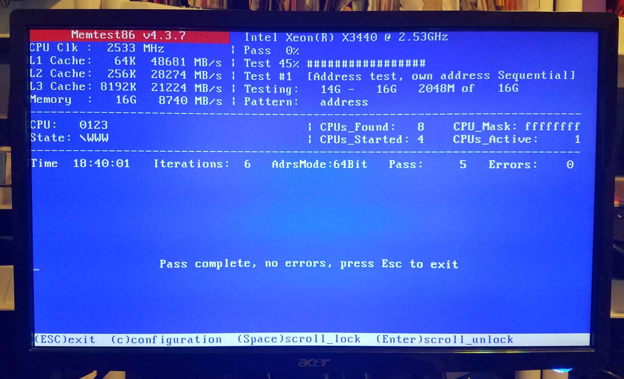

I'm testing my ECC RAM at the moment. I've been running Memtest86 for a while now just to let it do it's thing. So far I'm on pass #5 after 18+ hours or so and it reports 0 (zero) errors. I had to run an older version (V4) because it's an old board (X8SIL-F) that doesn't support UEFI booting.
However, when I went to my event log on my motherboard via IPMI I found an event alert by chance just being nosy:
I tried looking this up, but basically, this is a total real error that was not corrected by ECC. So my understanding is, this would have resulted in corruption or lost some data if it were not already backed up, correct?
Can't be good to see this error in such a small period of time (less than a day) right? I'm still confused how Memtest doesn't see an error but the IPMI event log did?
DIMM4B, does that mean it's the DIMM 4 slot on the board to help identity which stick it is?

I'm trying to get ECC running on the new board with a Zen 2 CPU but I'm not sure if it works. ASRockRack X470D4U with Ryzen 3 3100.
Memtest 8.4 free says:
ECC Enabled: Yes (ECC correction)
ECC Polling: Disabled
ECC Injection: Disabled (even if I change the ECC error injection option)
BUT:
In FreeNAS (11.3) "dmidecode -t memory" says the data with is still 64 bit but it should be 72.
I'm not able to install the beta version 12.0 of freenas.
Before, in another test system (Intel, very unstable but ECC was running), it was 72 with the same RAM.
Do I need another CPU for ECC? The website does not say which CPU supports ECC, even for the Epyc's this is not listed.
I tried resetting the BIOS to default values, deactivating or activating PFEH. Nothing changes.
Any suggestions? Should I go with Intel at the moment?
