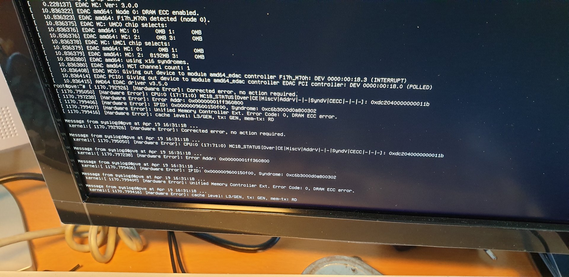

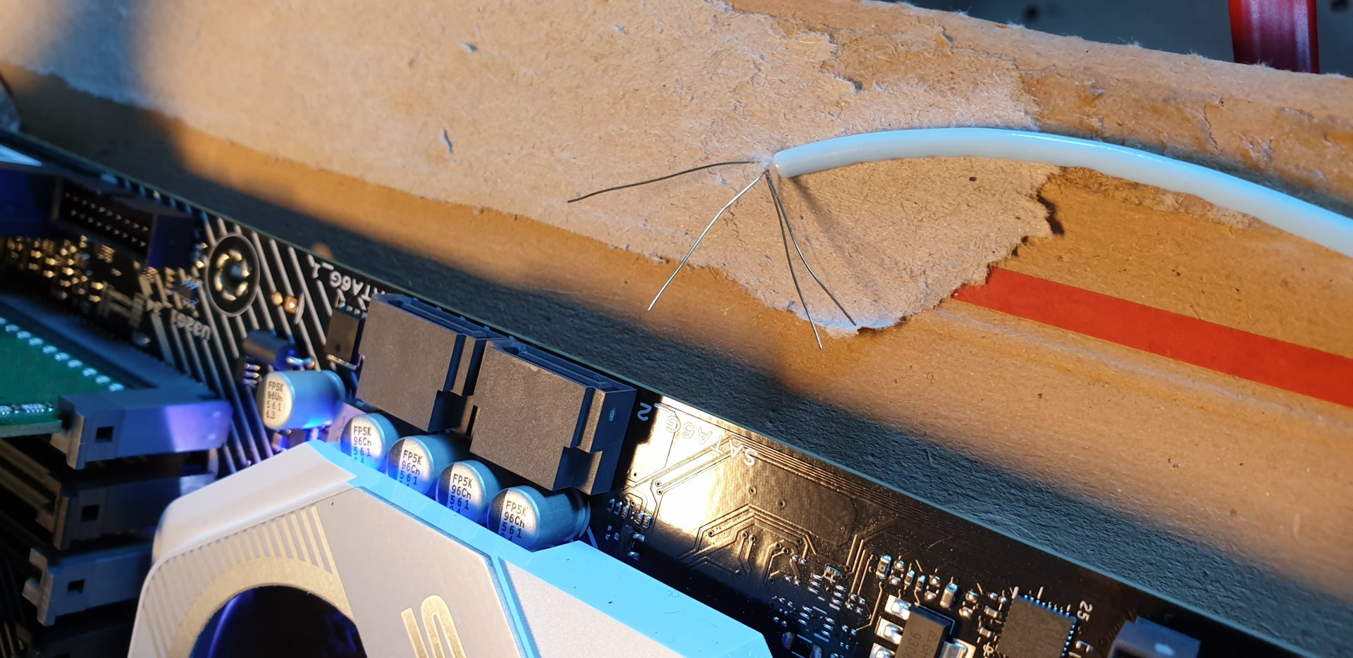

I am happy to report that it is actually really easy to generate ecc mem errors. Thanks all for motivating me to go in head first.
The method I used was to use the inner wires of some electrical cable rather than syringes and stick it in the memory bank with 8GB ECC UDIMM in it.
First try success. I saw errors being corrected using proxmox 6.1 with a 5.4 kernal and also memtest86 pro 8.4 rc 2 build 1001.
I don't have a mobo yet with IPMI that logs and alerts on ecc errors so could not test that yet but that would be my solution for FreeNAS then.
Have not tested yet on TrueNAS 12 to see if OS reporting has made it in yet but as soon as I can I'll test that as well. Might take a while though.
Memory seems still intact.
Now the icing on the cake would be if ecc error injection would be available for recent setups and part of monthly (or what ever period is reasonable) health check.
