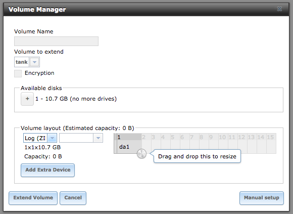

You could do this:
# create 6GB memory drive, at /dev/md1
mdconfig -a -t swap -s 6g -u 1
# add the ramdisk md1 as slog to pool tank
zpool add tank log md1

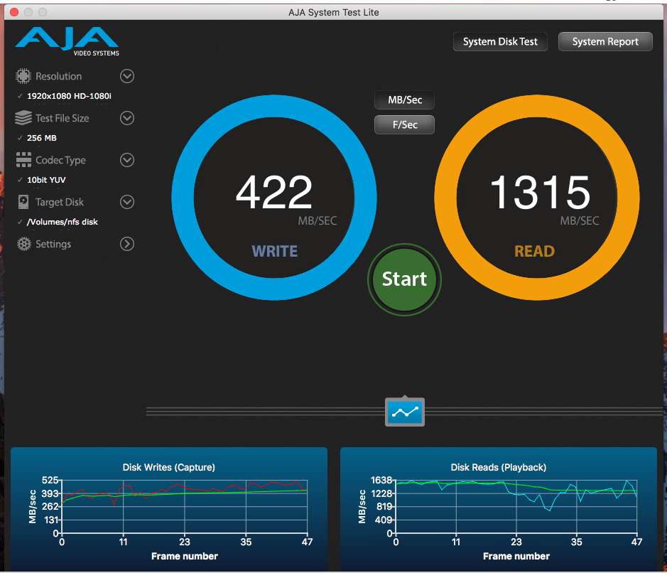

So, it works quite well for 256MB... what about 16GB.

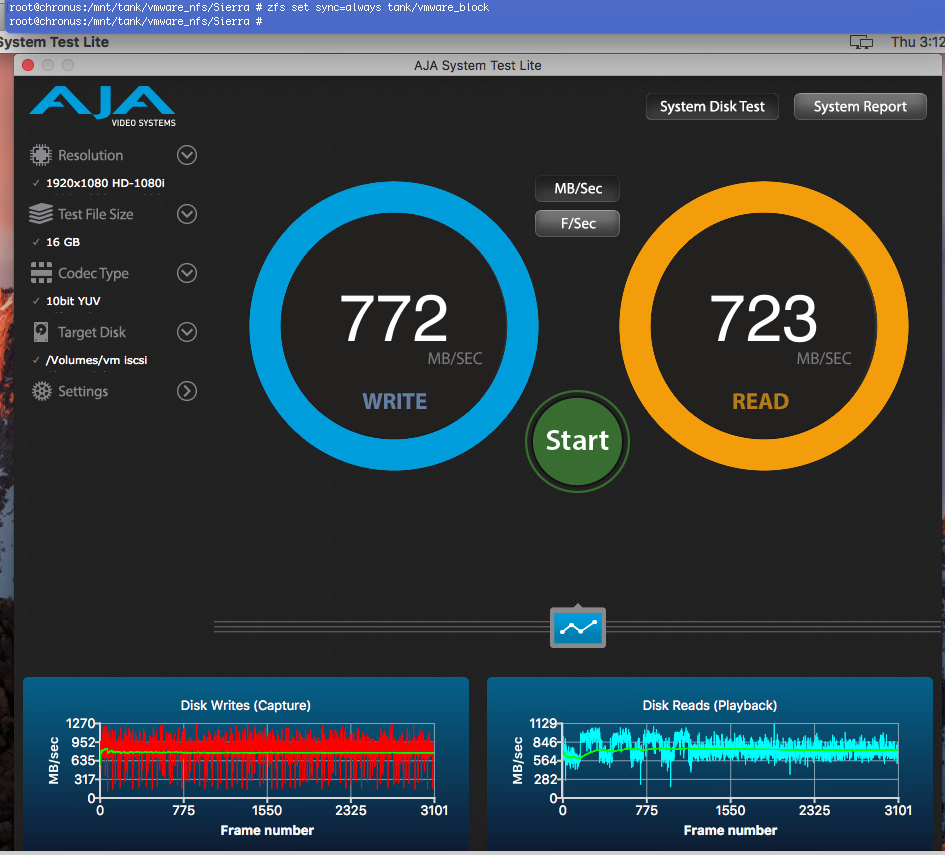

Now lets try with an actual SLOG...
Not bad I think. And remember, without the SLOG its 5MB/s.

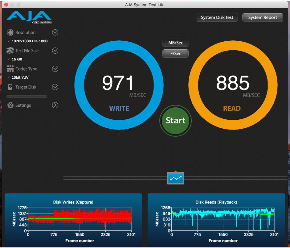

Now, many people suggest simulating a SLOG by simply disabling sync on the dataset...
First, lets remove the slog,
1) click Storage
2) click on your pool
3) click on Volume Status at the bottom
4) click on the slog volume...
5) click remove at the bottom...
# now, lets disable sync on the vmware nfs dataset...
zfs set sync=disabled tank/vmware_nfs
Not bad... but also twice the speed of the RAM slog and 3x the speed of the actual SLOG. So, not actually a realistic display. Basically my system only seems capable of writing about a GB/s, and when sync is enabled, it has to write half a gig/s to the slog AND half a gig/s to the pool. Worth remembering.

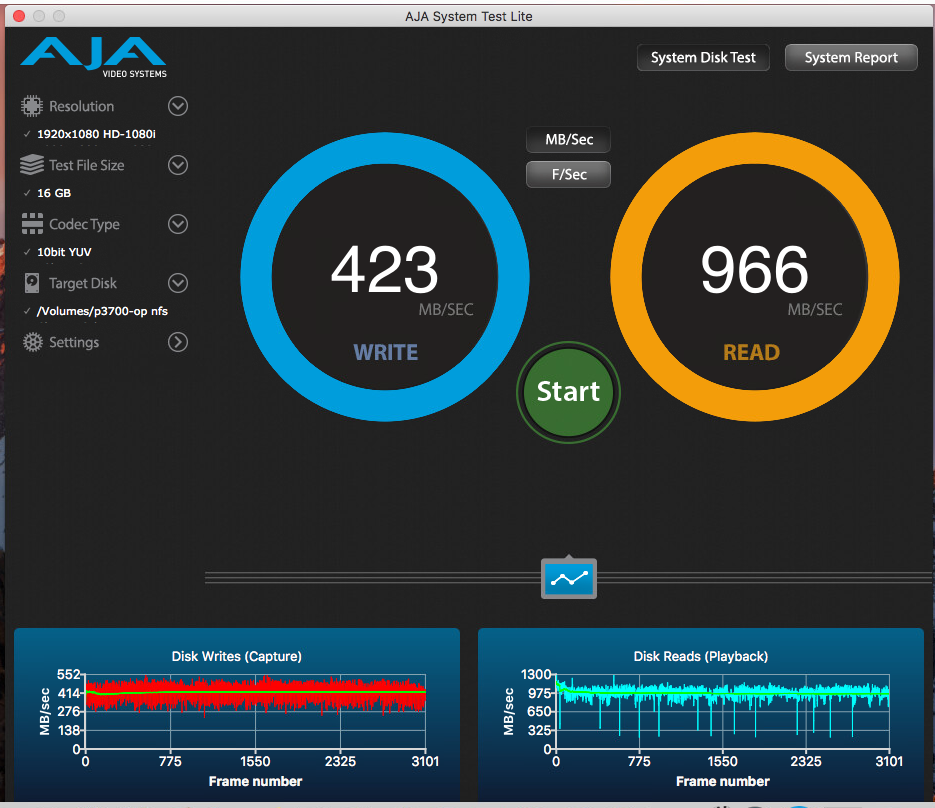

Stux
Wizened Sage
Jun 2, 2016
4,163

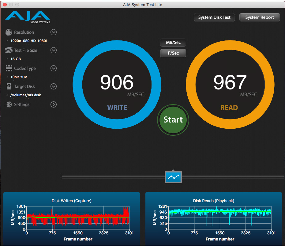

So... somebody bought a stupid fast SLOG...
Intel P3700 400GB. Good for 10DWPD and can sustain about 1GB/s write. With a crazy 450,000 IOPS and full PLP. I couldn't justify the expense of the P4800X.
Been doing some testing. One of the first things I did was switch it to 4K sectors.
Anyway, making a pool on the device... no SLOG, but sync=standard (ie enabled for NFS) provides:
Now, 400MB/s make sense, since its essentially writing twice. Once for the ZIL and again when it flushes the TXG.

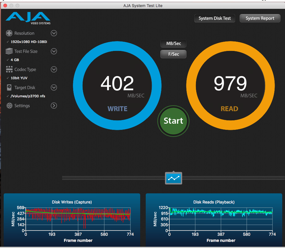

sync=disabled, means its only writing once...
And then you get circa double the speed... but even though the SSD has PLP, this is not safe, as anything in the TXG will be lost. I suspect faster performance would be had by using the P3700 as SLOG, and a bog standard NVMe as the pool...

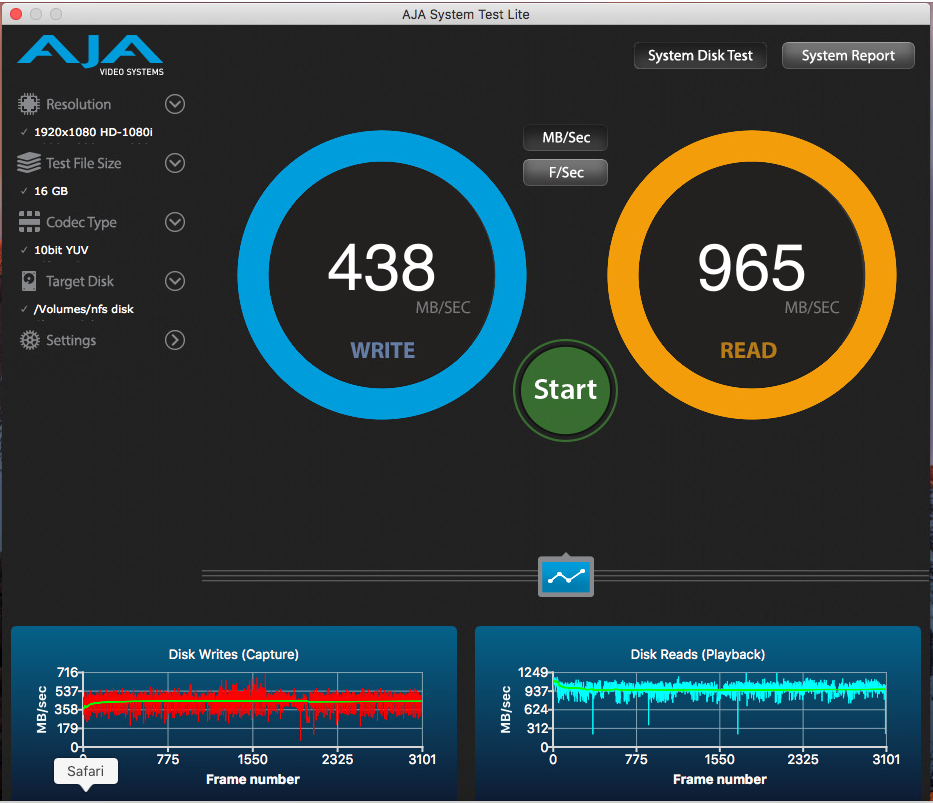

Now, this is using the entirety of the P3700 as a slog for a 40GB pool, which is actually a slice of a Samsung 960 evo, which has been shared into the FreeNAS VM via ESXI.
For those keeping score at home... That's just 10% below my speeds using a ram disk.

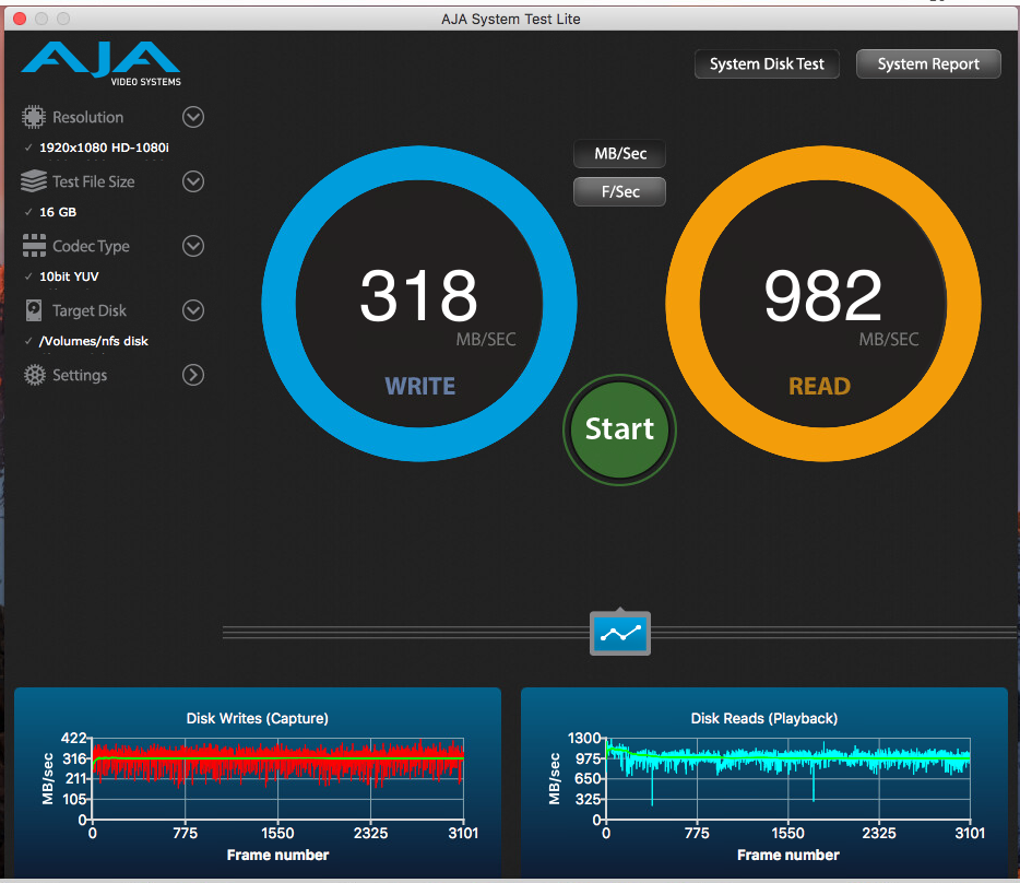

And then I should just be able to use FreeNAS to add the nvme to my pool... and it should just magically work as a 20GB OP SLOG.
And yes... it appears as exactly a 20.0GB drive.
Stux
Wizened Sage
Jun 2, 2016
4,163
And with the OP we now have beautiful consistent performance....
Again, very close performance to the RAMdisk.

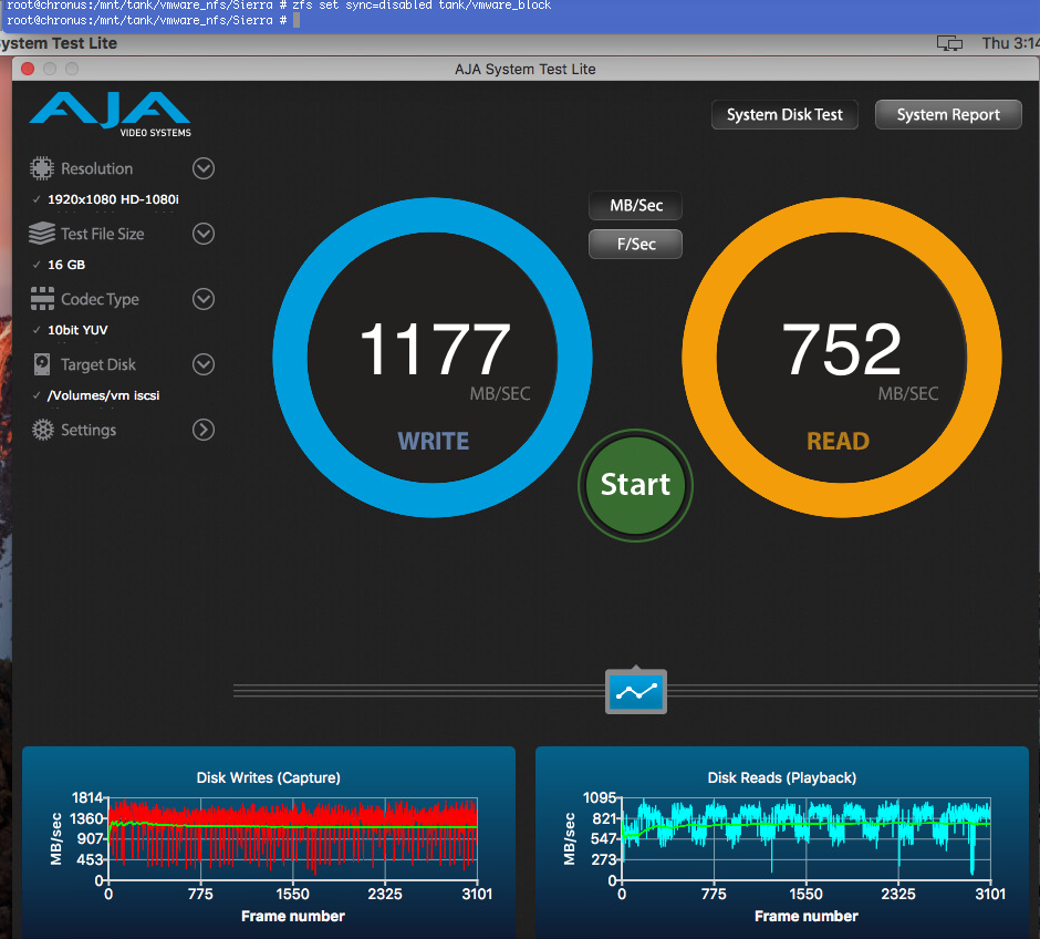

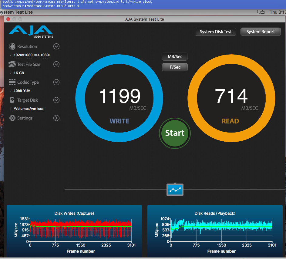

And now for iSCSI.
P3700 pci passthrough, OP to 20GB, as SLOG.
6xIronWolf 8TB SATA pci passthrough, RAIDZ2.
VMware ESXi 6.5 AIO config. VMXNET3 for Storage.
sync=always
sync=standard
sync=disabled
