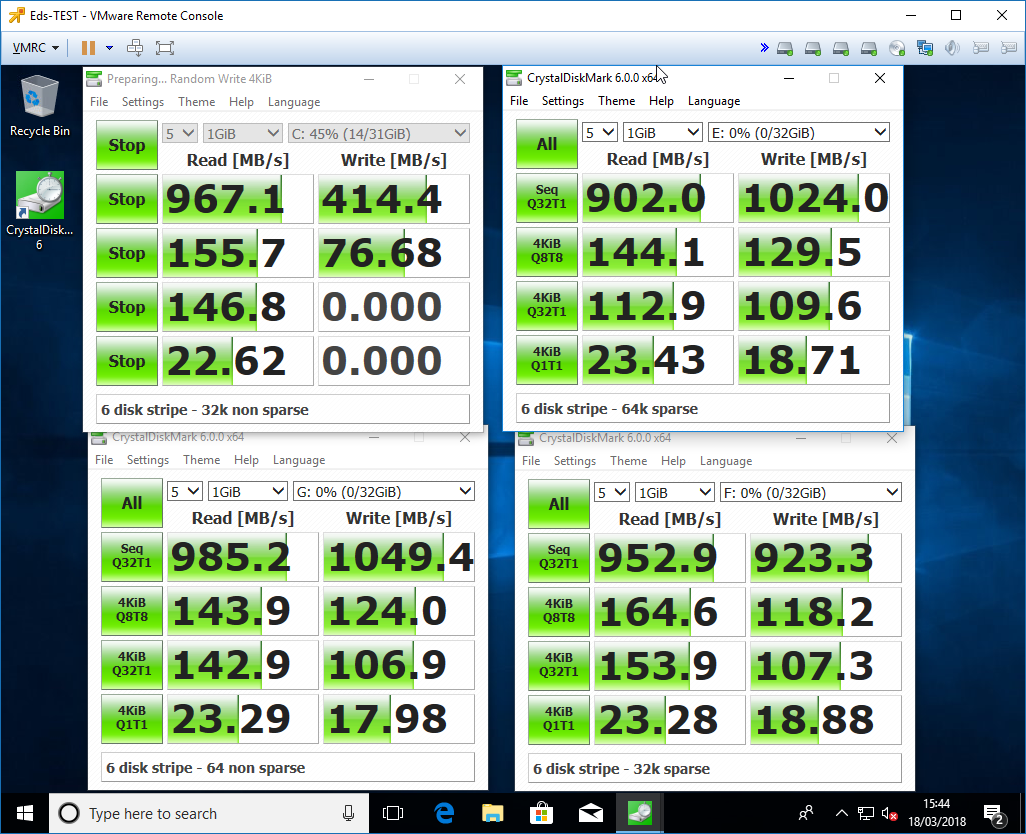

What kind of impact would people expect the block size and sparse option to have on throughput?
Default options is non sparse and 32k. This is where I see my above mentioned numbers.
I have then tried 32k sparse, 64k sparse and 64k non sparse, and all give me more like what I would expect with about 900MB/s read and 1GB/s writes.
Screenshot uploaded of these results. All zvols on the same physical 6 disk stripe.
Honestly, I think your (enviable!) results are about as good as you're going to get here in the 'Real World'. :D

This is what's tripping you up. When the VM issues a write, sync or not, it will not continue until the the write request is fulfilled. In the case of async, this happens in the write cache (typically RAM). In the case of a VM level async write with underlying ZFS sync always, the host will not get the green light until that write hits the ZIL, yes that write stays in RAM and that's your working copy but in sync mode, it always waits for the ZIL. No matter what you will not sustain writes faster than your spinning disks can do sequentially or your network link whichever is slower. There are other bottlenecks but with what your doing, its not relevant.
EDIT: the 64/32 32k has double to overhead at every step of the way. Try doing the same test with 16k. I would bet its roughly half the speed. This is where you need to look at IOPS. It may be processing the same number of IOPS but the packets are smaller. And yes I said packets. Storage and networking performance have WAY more in common than most people realize. PPS and IOPS are basically the same thing just like throughput and throughput haha der. Networking you have buffers measured in bits and storage you have IO queues based on the number of IO operations instead of IO size.
You can tune your TXG size/time to accommodate larger bursts of traffic but that get fairly deep into the weeds as you MUST have an total understanding of your workloads exact characteristics to even think about this otherwise you will destroy your performance and potentially leave yourself open to lots of data loss.
This is one case where VAAI shows some real benefit. When writing sparse blocks ESXi is telling FreeNAS "Write a block with all 0s" instead of Write a block '0000000000000000.......'". All the work is being done on FreeNAS and there is no host/network IO overhead. Again your not writing out the entire file, just saying "Here's the pattern, do the work for me."
Edit2: This may even extend into the disk controller and disk themselves though that may be SAS and not SATA. I usually don't go that far down the storage stack.
Ok, so if 32k maxes writes at 450MB/s, the only reason that writes are faster when still at 32k but sparse, is because ESXi has less to do? If my 32k sparse and 64k sparse/non-sparse all produce the same results, is it better to stick to 32k for better IOPs?
