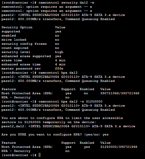

To clarify parts for under provisioning. The newly added 3710 SSD is not in a pool and just listed in the view disks list as da12.
Use the shell / Putty to perform the under provisioning steps as listed before via camcontrol on da12
  1. camcontrol security da12 -e
  2. camcontrol hpa da12 #to view current HPA settings
  3. camcontrol hpa da12 -s 31250000 # x 512B sectors = 16G
Then use volume manager to extend the volume called "Tank". Add the available da12 disk as 200GB under provisioned as above, change the volume layout to Log (ZIL), and extend the volume to add the ZIL.

When provisioned via camcontrol, the SLOG should show up as 16GB correct? I did the same process above on a PE R510 with the same hardware Build 1 setup and it displays 16GB. The R515 and the 3710 above showed up as 200GB not 16GB. I will reboot and re-issue the camcontrol commands.
depasseg
FreeNAS Replicant
Sep 16, 2014
2,873
That's right - the disk will look like it's 16GB. Assuming you did the math correctly. :smile:

I believe that one additional reboot was needed. Here is the summary of all the steps taken.
In regard to the setting up the R515 & R510 volume with a SLOG;
  • Installed 9.3.1 stable
  • Updated to 9.3.1 version that was same as backed up configuration file. System rebooted as part of upgrade.
  • Uploaded config, system rebooted as part of upload.
  • updated SLOG SSD device provisioning via camcontrol - SSD in disk list still showed 200GB. camcontrol showed that revised sector count was in place.
  • Rebooted server,
  • now disk list shows SSD at 16GB as a different da## listing
  • Expanded main volume / pool with ZIL LOG using 16GB SSD.
  • Did not need to reboot to see in reporting or other disk based lists.
I hope that this helps some others.

Does anyone know if the 3710 SSD will reset back to 200GB from under provisioned 16GB if the system is rebooted? I had to re-run the commands and re-attach via volume manager.
depasseg
FreeNAS Replicant
Sep 16, 2014
2,873
The camcontrol settings survive reboots and power loss.

I was curious as I moved my freenas main setup from an AMD R515 server to a Xeon R510. The 12 pool disks, HBA, NIC, and SLOG SSD components were powered down and moved from box to another. The SATA backplanes were different in each box. After reboot, the SSD came up in the disk list as 200GB. I wanted to point out that the freenas 9.3.1 version did not require an update in this case.
My replication freenas box R510 #2 which had no hardware moves or changes was powered down to physically move it and clean it. Both power supplies were disconnected in this case. When I rebooted the device, the SLOG disk reverted to 200GB from 16G. As on the server above, I had to remove the SLOG device from the pool, re-run camcontrol commands and then re-extend the main pool. It then showed as 16GB after a reboot. I will keep an eye on it. This box had an update performed on it before I checked the SLOG, but I did not think that would effect the SLOG.
I will update the post if anything definitive is noticed. The specs on the units are in the footer.
webpilot
Nov 9, 2015
27
I can confirm that on both units running 9.3-STABLE-201512121950 the under provisioned intel 3710 SSD reverted back to the full capacity after a reboot.
Is it possible that the last upgrade did something to keeping camcontrol commands from being left in place? What is the next step? Contact intel or can anyone offer something else to try. I try not to reboot that often. See the output of camcontrol below:

It probably doesn't matter if the device reverts in size. As long as the partition that's been created by FreeNAS is the smaller size, this implies that most of the pages on the SSD will never be allocated to LBA's, meaning that the large bucket of free pages (which is mostly what we're trying to accomplish with underprovisioning) is achieved anyways.
