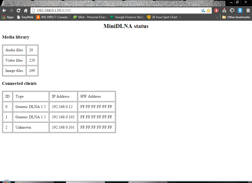

I havent had any problems testing 113_11 yet.. When I drag and drop new content into a test dir it works!.. Now to see if it can make it through my standard setup.. Previously on the test version while scanning it would crash at some point.. I posted details of this previously.. Hopefully will suceed with a scan..
