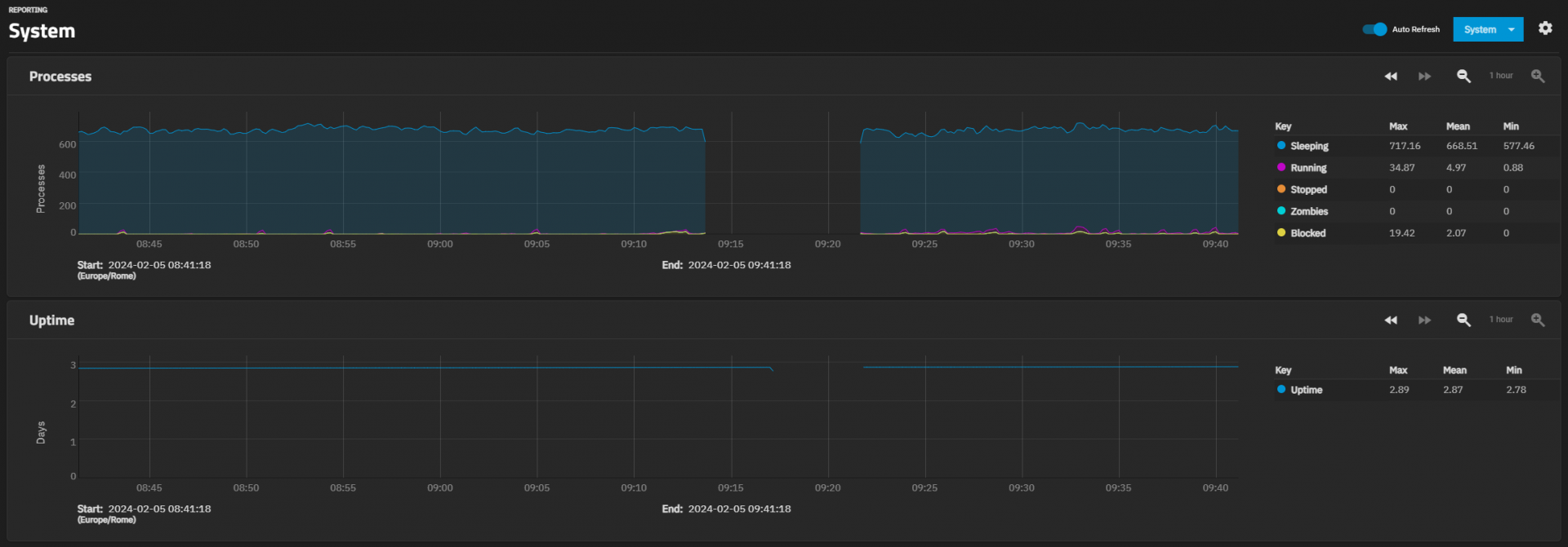

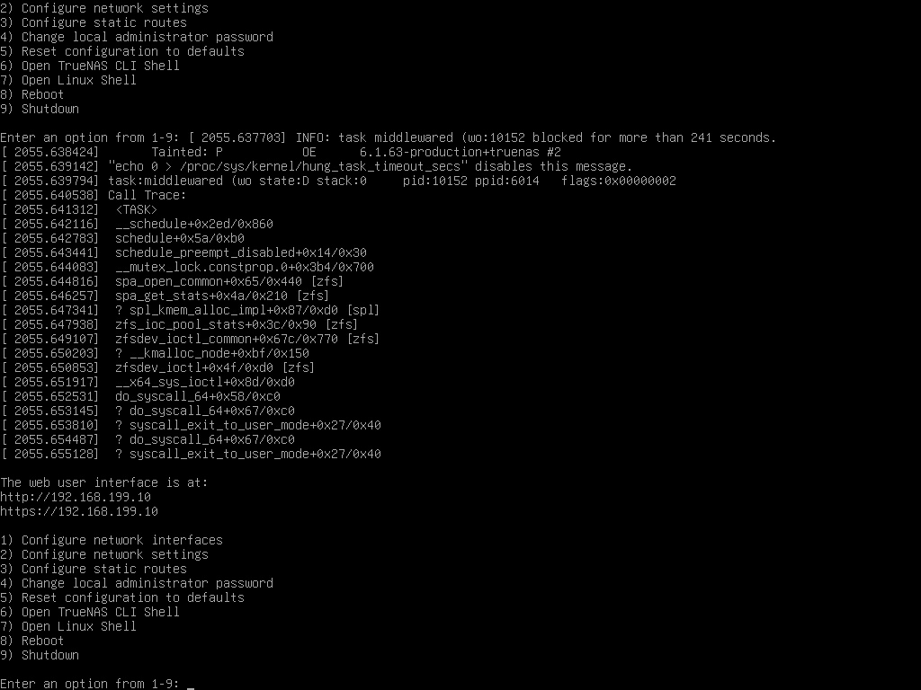

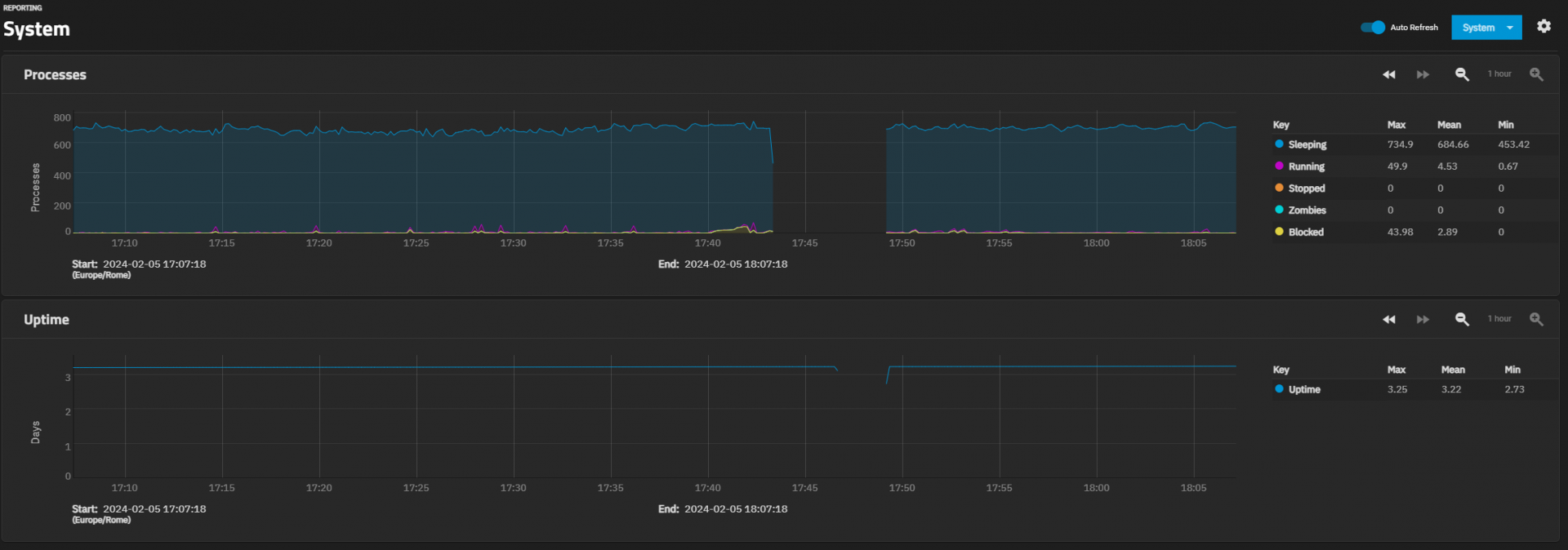

Twice today the system was unreachable for several minutes.
I report the screen and journalctl of those minutes.
Can you give me information on what causes them and how to prevent them from happening again?

This is very likely related to the deduplication issue
That's what I thought too but in the previous blocks the whole system didn't block.
In these last two blocks not even the WebGUI was reachable.
It could be a worsening of the situation.

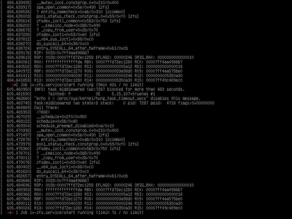

Because I had to reboot and rebooting gives this error
Did you reboot the TrueNAS system because it was no longer responsive? This is likely because the underlying disks are busy with the I/O for deduplication.
As mentioned in the other thread, I'd like to see an additional zpool status -D and zpool iostat -v if possible during the times of non-responsiveness.
Apr 8, 2018
44
Even with a fresh installation of TrueNAS I get this error.
It is currently in the import phase.
What does the middleware process do?
