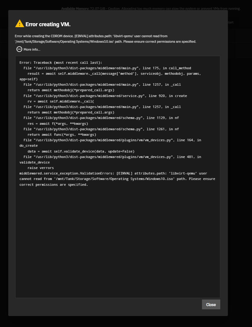

However I have a quick question, again regarding VM. So I am setting up a new VM install to read from the same Windows10 ISO as I used recently, when on CORE.
However when finalizing my settings to install the VM, I get a permissions error from TrueNas as below.
I am logged in as the root user, I in fact just added root with full read permissions of the directory where the ISO is sitting (Just in case). So I must be missing something. Any ideas ?

@panzerscope, forum search is your friend.
panzerscope
May 30, 2022
146
That it is! Thanks for pointing that topic out, that fixed my issue

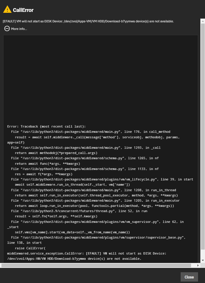

Ironically I am in the process of installing a second VM. I set up everything just fine, allocate the VM its storage space via the initial setup, but when I go to start the VM I get
I have tried numerous times but for some reason it stops being able to access the disk space assigned to it ?

I always dislike "spaces in names".... eg "VM HDD"
There are so many layers in the stack that can interpret them wrong.
Can we remove and check.
panzerscope
May 30, 2022
146
Good catch! My original VM is using a Dataset with the name "VM HDD". This VM works right now, but as you cannot rename a dataset (at least not from the UI), is there a way for me to create a new "VM-HDD" named dataset and move a ZVOL from the old dataset "VM HDD" to the new dataset?

Why not just zfs rename path/to/VM\ HDD path/to/VM-HDD in the Shell, and then adjust the device property to the new path?

Before doing that... is it necessary to rename the path/dataset? Knowing the 1st VM worked makes me doubt this is the issue.
Are there other permissions checks to be done?
