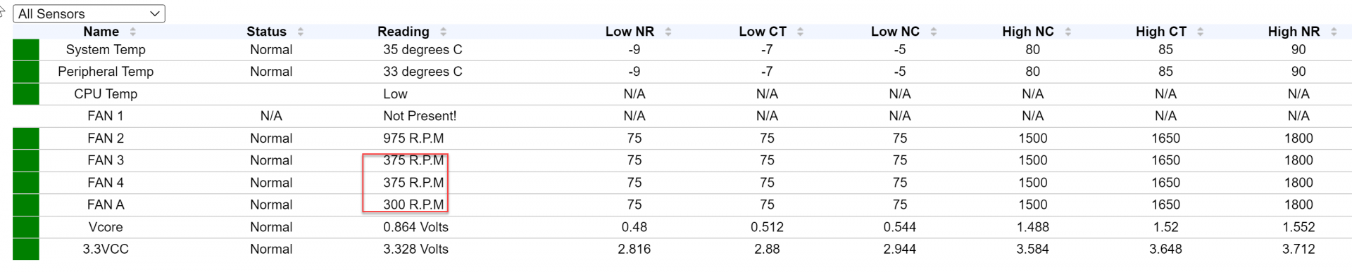

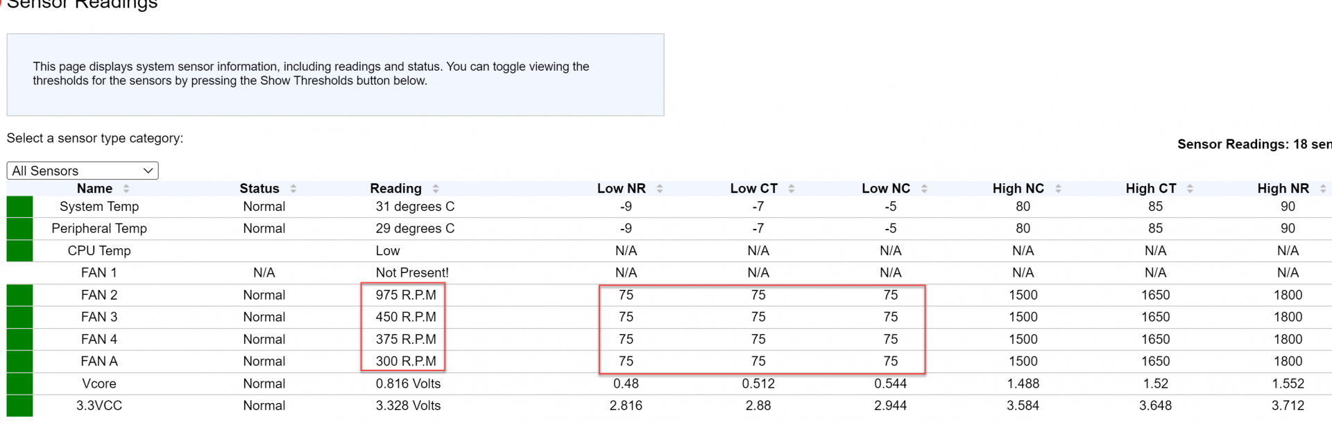

I have lowered the thresholds significantly (see below) and yet fans ramp up every 20 seconds.
Readings-snapshot below was taken right before the fans ramp up - you can see that "FAN A" was the slowest running fan at 300 RPM.
I have no clue why is this happening.

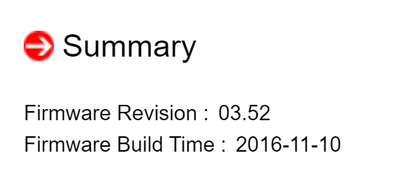

Firmware Revision 03.52 (latest)

I have read multiple "IPMI things fans are stalling" posts and followed the advice to lower the "lower" values - see picture above - they are all "75".
Is there anything in there that I have missed ?

right, initially I had created lower 200 400 600, nothing worked, so lastly (out of desperation) I set all to 75 75 75.
So, I hear what you are saying but still mystery remains about "why IPMI think fans are stalled given that thresholds are not reached"

"ramp up" came back for no reason (no restart, no changes in configurations, etc).
"Lower" values (75 75 75) are far from reached - (300, 375 RPM, ... )
IMPI does NOT appear to pay much attention to "lower" values
