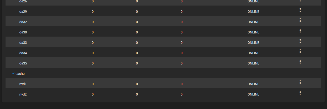

As for SSD cache, sorry I was wrong, it's actually 2x 3 TB, they are INTEL SSDPECKE064T8

As for SSD cache, this is what I mean

AndroidBot
Apr 25, 2021
28
So you think I should move my 70T data to some temporary storage, delete entire pool, re-create it with 3 devs, each dev to have 12 disks in it and this would solve my issue?
Davvo
Jul 12, 2022
3,222
I am confident you will see a performance improvement.
Arwen
May 17, 2014
3,611
I mean everything was working fine up to couple weeks ago
That is part of the problem with too wide RAID-Zx vDevs. With 36 disk wide RAID-Zx vDev, the performance problems will likely just get worse.
We have had people that have had too wide RAID-Zx vDevs end up with performance problems so bad that they can barely get their data off the pool. So be prepared for performance problems copying the data off.
It will help, maybe a lot. On occasion a person runs across other performance limiting items, like single thread CPU speed. (Faster cores are better for Samba / SMB, than more, slower cores.)
The way ZFS works with vDevs, is that a pool with more than one data vDev, data is normally striped across them. (Special vDevs, like L2ARC / Cache are not part of "data vDevs"...)
Last, using 2 x 3TByte NVMe for L2ARC / Cache drives, is still 12 times the size of RAM. Probably still too much. A single 3TByte would be about ideal.
