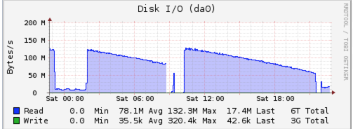

I've added an image of da0 here which shows the low parallel stress test read.

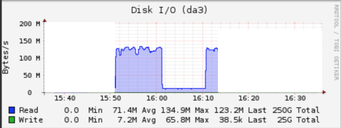

I'm also going and test one drive with two parallel dd threads and see if I see the results which were reported here
https://forums.freenas.org/index.ph...server-performance-tests-weird-results.30142/
EDIT: tested with dual 'dd' reads on a disk in the array.
Single 'dd if=/dev/da3 of=/dev/null bs=8M' reads at 120MB/s all day long.
Start a second 'dd if=/dev/da3 of=/dev/null bs=8M' and read speed plummets to circa 12MB/s.
Cancel one 'dd' and speed returns to 120MB/s
I'm not using a multiplexing backing, a plain '216A' model with 3*9207 HBA with correct firmware.
I'll try iozone and see if it sheds any light.

Is it just the one drive that has the issue?
wtfR6a
Jan 9, 2016
88
nope, all of them.
Stux
Jun 2, 2016
4,419
Wait a sec...
You're reading from the same disk at 2 different locations.
That's expected behaviour on an HD.
Do it via ZFS/ARC and it would be fine (providing the ARC was big enough) ;)

Parallel seek stress shows lowe MB/s
Performing initial parallel seek-stress array read
Sat Oct 22 21:59:47 EDT 2016
The disk da0 appears to be 3815447 MB.
Disk is reading at about 17 MB/sec
This suggests that this pass may take around 3792 minutes
				   Serial Parall % of
Disk	Disk Size  MB/sec MB/sec Serial
da0	  3815447MB	124	 16	 13
da1	  3815447MB	125	 16	 13
da2	  3815447MB	125	 18	 14
da3	  3815447MB	124	 17	 13
da4	  3815447MB	125	 15	 12
da5	  3815447MB	117	 16	 13
da6	  3815447MB	124	 17	 14
da7	  3815447MB	124	 15	 12
da8	  3815447MB	124	 15	 12
da9	  3815447MB	127	 15	 12
da10	 3815447MB	125	 19	 15
da11	 3815447MB	122	 16	 13
da12	 3815447MB	122	 16	 13
da13	 3815447MB	126	 13	 11
da14	 3815447MB	126	 17	 14
da15	 3815447MB	121	 15	 13
da16	 3815447MB	129	 17	 13
da17	 3815447MB	126	 14	 11
da18	 3815447MB	122	 16	 13
da19	 3815447MB	118	 17	 14
da20	 3815447MB	129	 17	 13
da21	 3815447MB	123	 16	 13
da22	 3815447MB	128	 16	 13
da23	 3815447MB	100	 16	 16

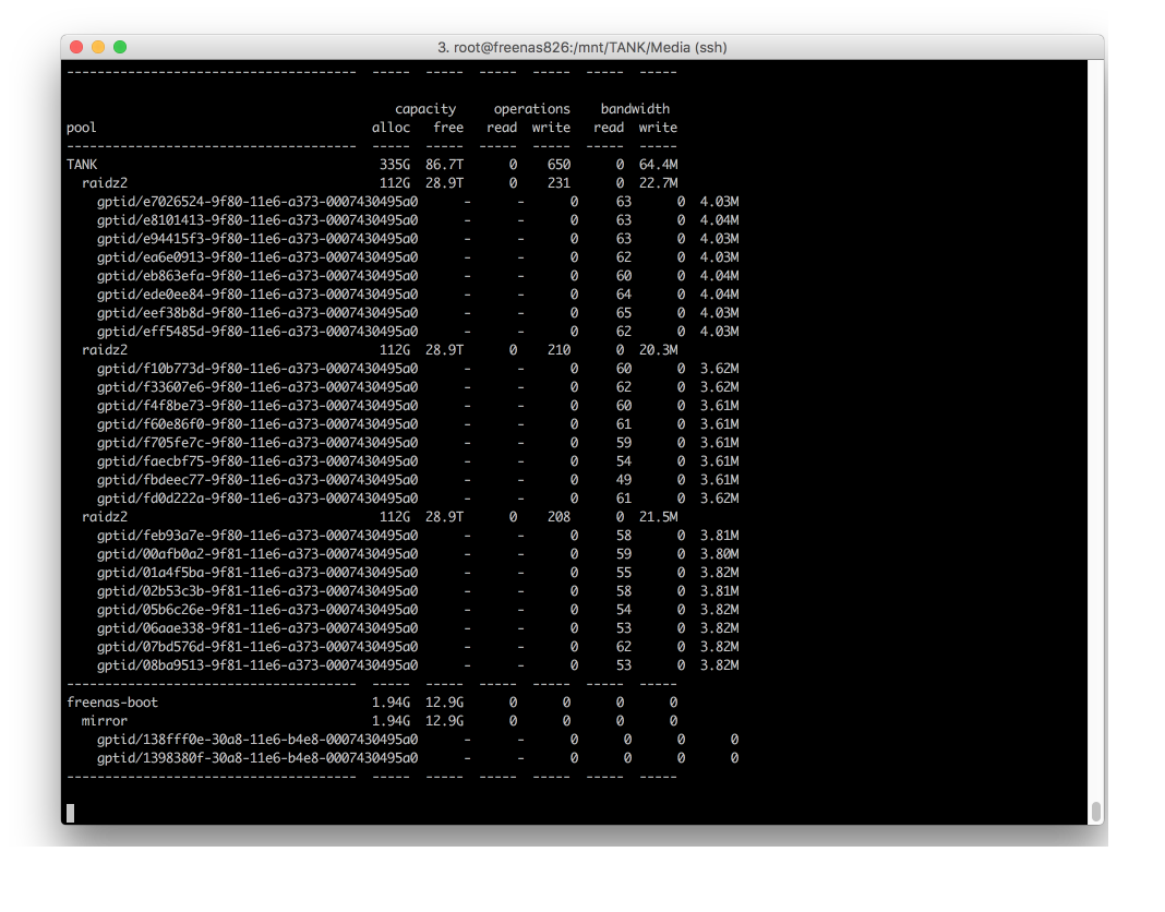

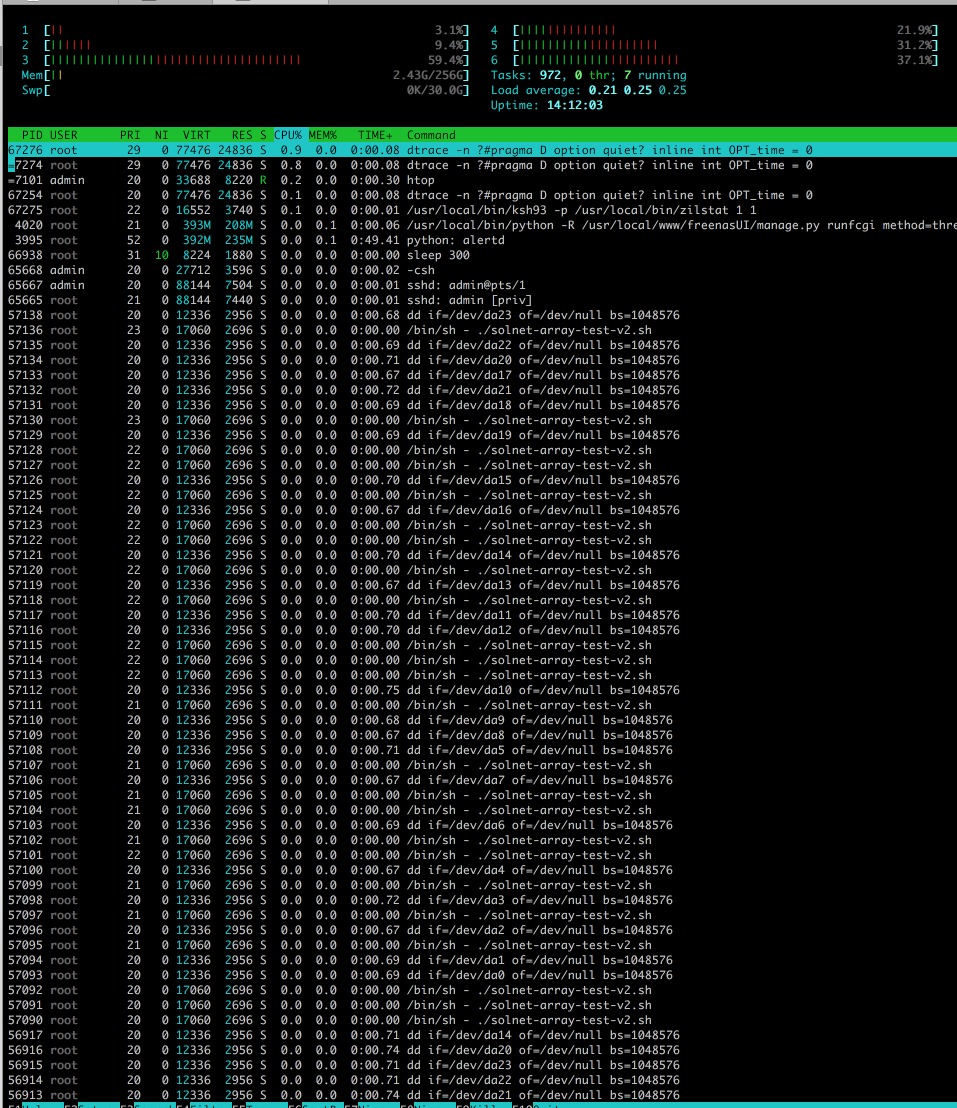

CPU load is low, RAM use is low....
With regular black magic speed tests, Im seeing a read write from this array over 10gig networking of 250MB/s read and write. My 10g networking iperf 's at 9.xgbps so thats not the limitation here.
any pointers appreciated.....thanks in adv.
