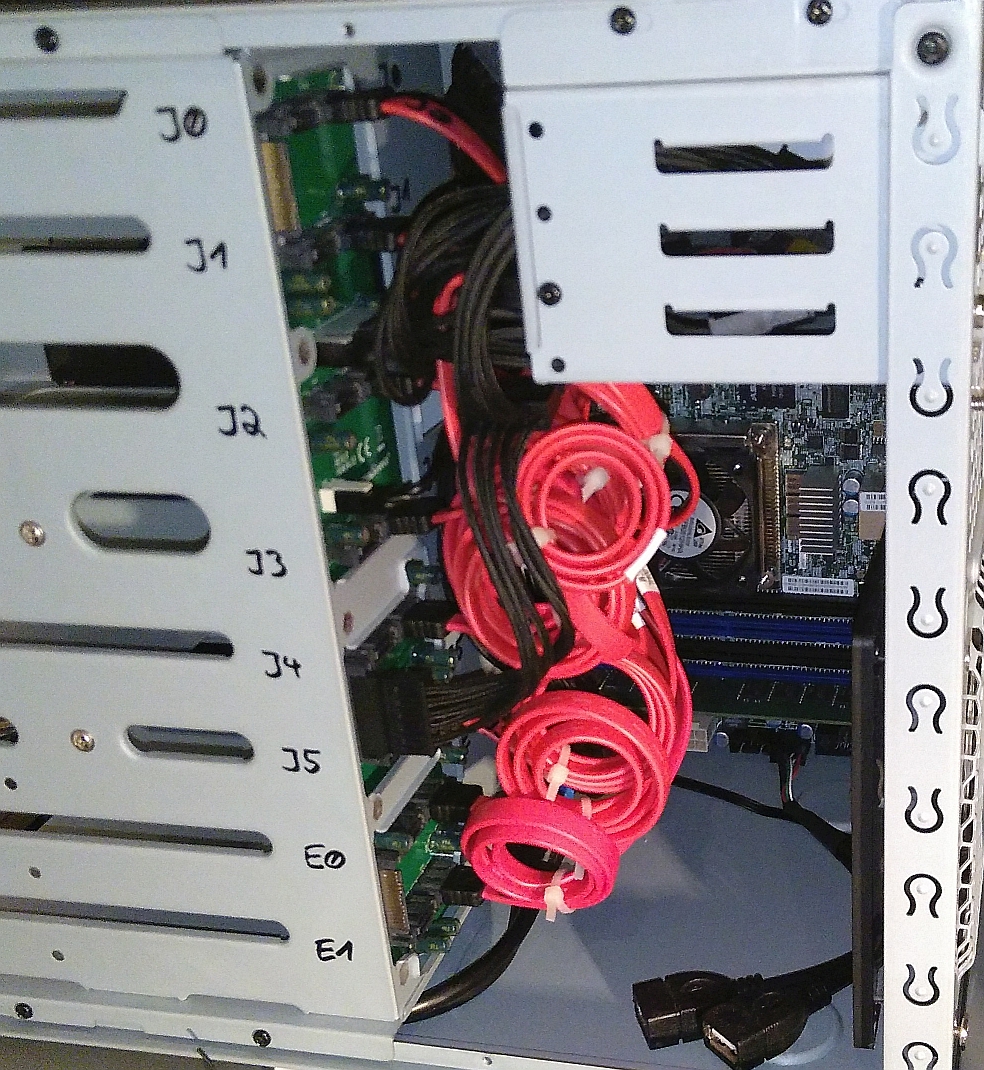

    On the image, you can (not) see the SSD in the right cage.

When looking at the picture I posted under "What I did so far", would you say I've been too violent against these cables, or is it just a bad cable? I am asking since it would already be the second bad cable out of 9.
Samuel Tai
Apr 24, 2020
5,399
You should try to get shorter cables. Those loops are a lot of weight to be hanging off the SATA ports on both the drive backplane and motherboard sides. Barring that, some kind of weight relief would be warranted, like a short vertical stick to which you could velcro all the loops.

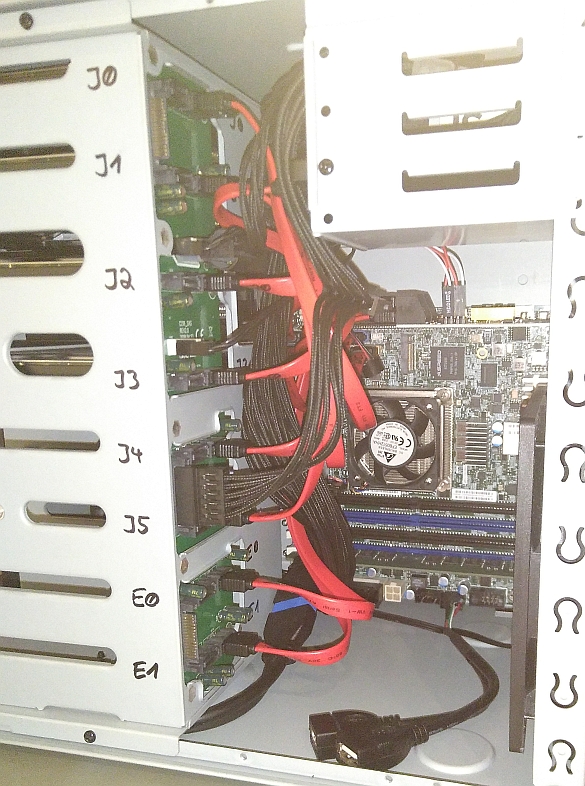

I got new ones! That looks better, right?
Yes, much cleaner and better for airflow.
