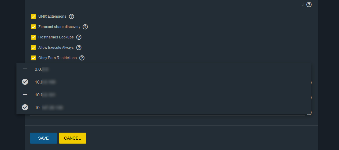

So scratch the above it looks to be a bug in FreeNAS where by (I think) if you re-join FreeNAS to a ZeroTeir network (even if you assign it the same IP it had before) you will have to go in and remove the SMB bind and re-add it
so from the screenshot below you would need to uncheck one and save and recheck and save (doesn't seem to matter which one you change just as long as it updates)
Hope this helps anyone who stumbles upon this post
