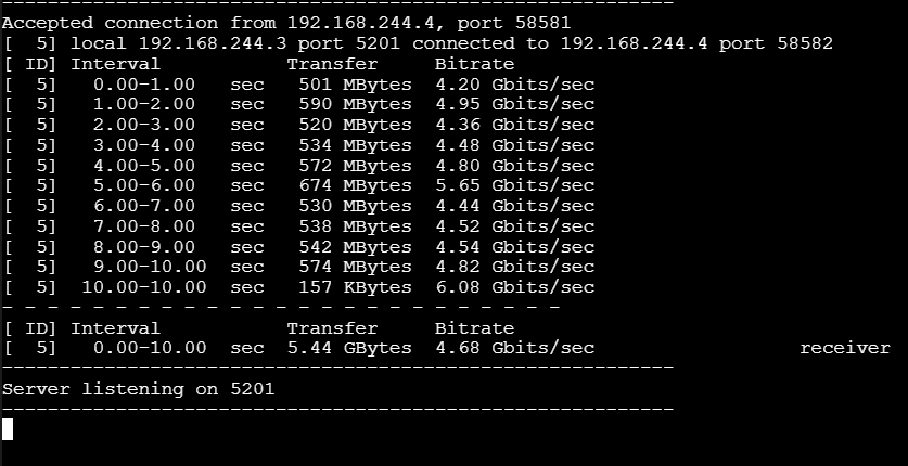

Oh and also i get around 5 gbps if that matters. Shouldn't bottleneck it though

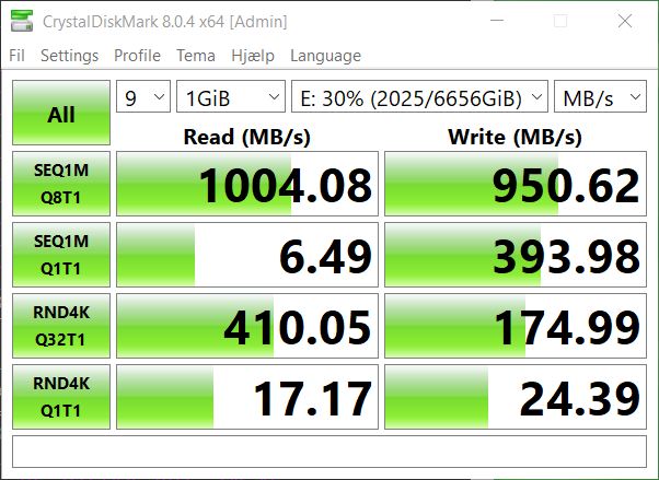

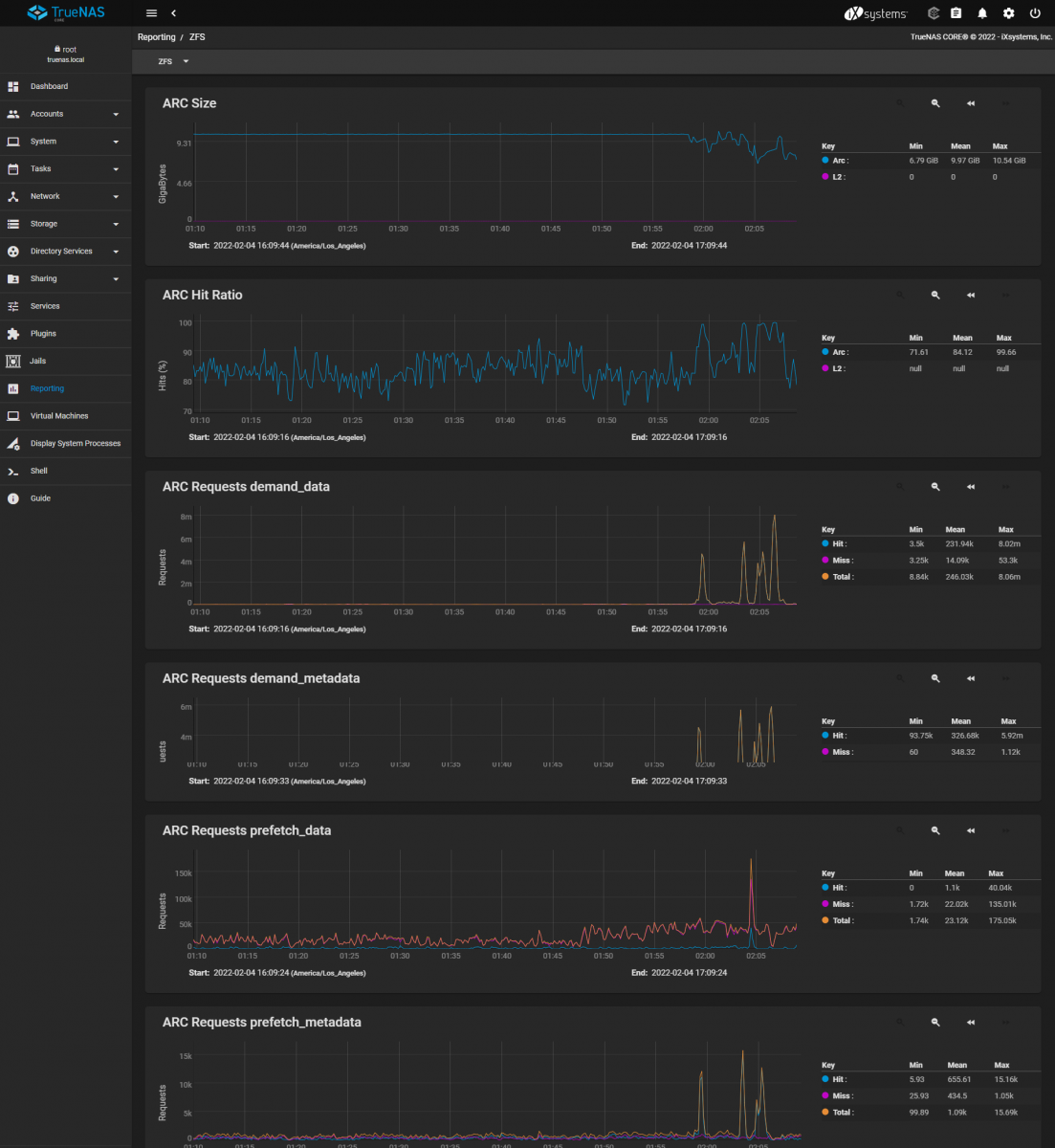

Uhh.

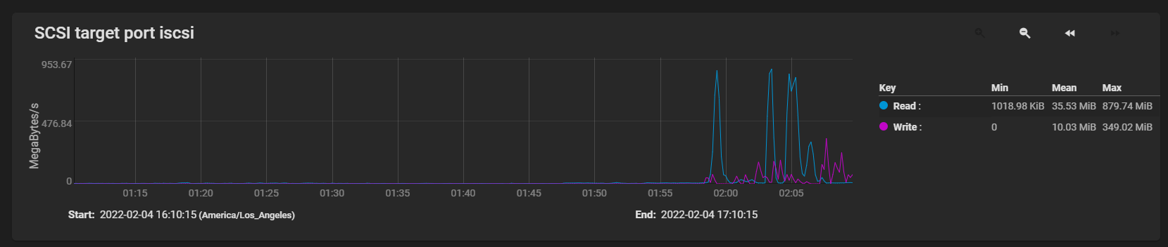

Updated earlier today and ran a test. Same results. Now I run the test and consistently get this? Also my graphs work now, so ill drop this here if anyone recognises this behaviour.
Right after update:

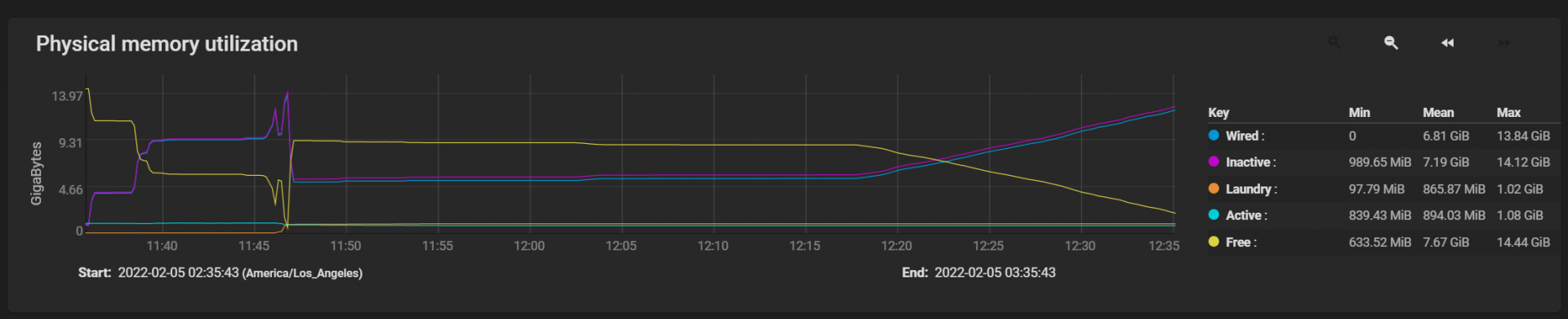

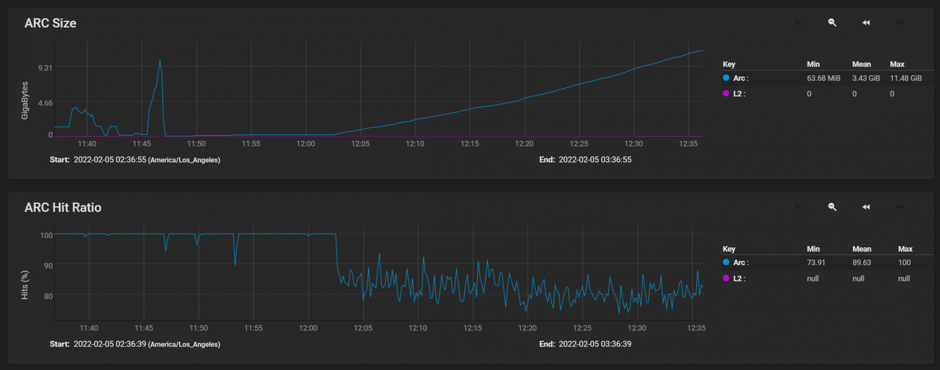

Askejm
Feb 2, 2022
34

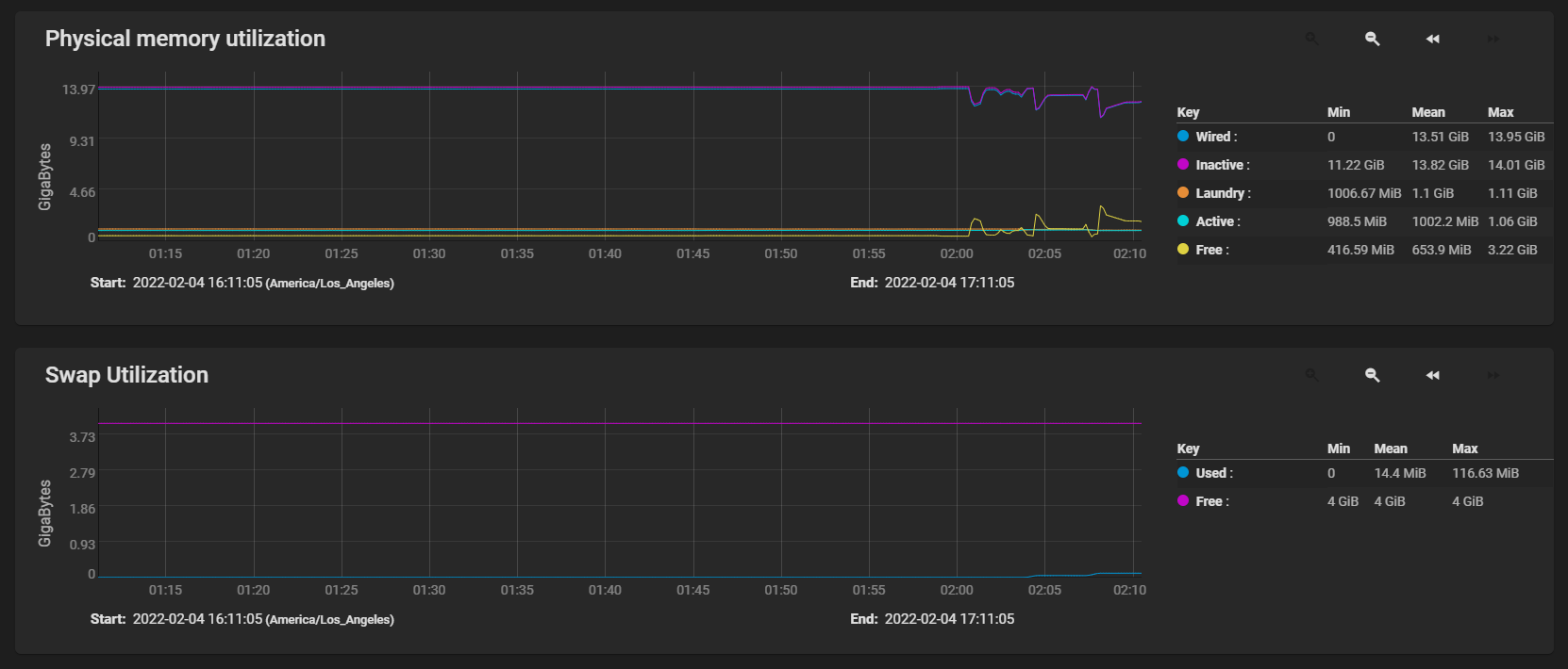

Could it be that the ARC size just increases until it fills all the ram? When I run the test now I get an ARC hit ratio of almost 100% and you can see it slowly increasing as well as being far more bumpy when I start my torrent
HoneyBadger
actually does care
Administrator
Feb 6, 2014
5,112
Did you reboot the TrueNAS VM and then run the test right away? If you restarted, you'll have a whole lot of empty RAM looking for a viable target, and the freshly-created CrystalDiskMark test file will get put there, resulting in the amplified read speeds.
