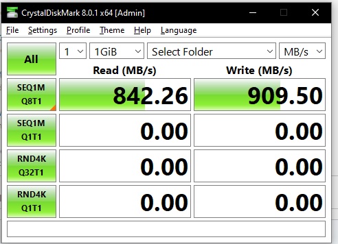

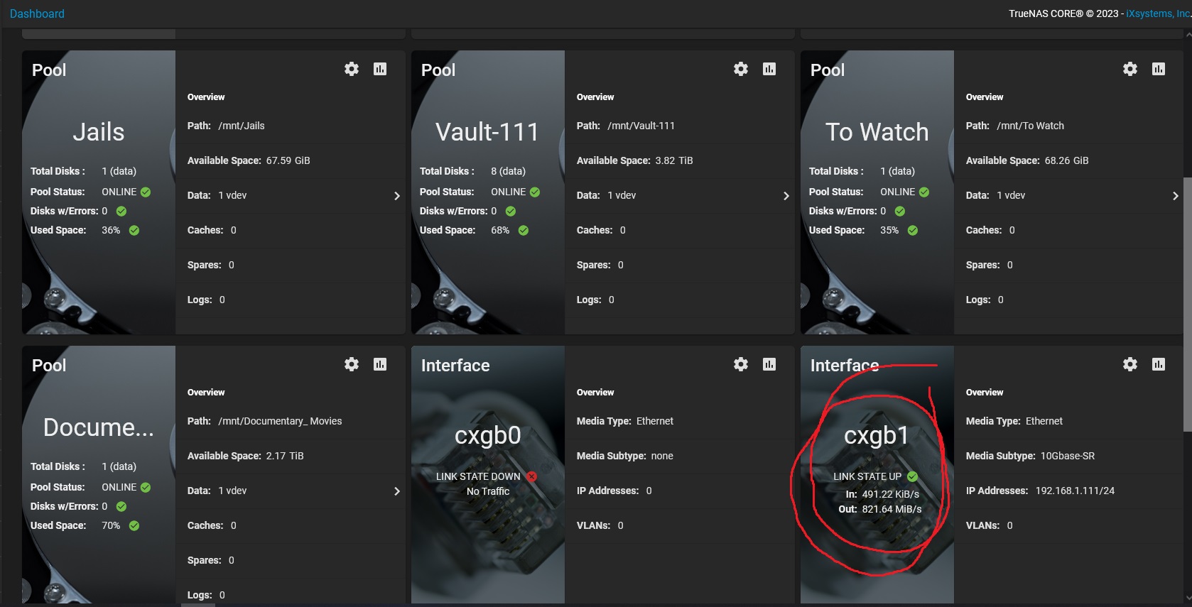

Now for you people who have 10GB nic On you NAS server and and PC. This is how i solved my problem with low read speed from the nas on an SMB share.
My read speed from the nas file server to pc was 100-114 MB/s and the write speeds on my HDD mechanical was 925 to 1100 MB/S.
PS if you want higher speeds of 925 to 1100MB/s you have to enable drive settings on your nas box HDD always on and use maximum power for performance.

NIC Old Intel x250 10Gb SpF+ dual fiber cable.

I have solved the problem by going into network settings, adapter properties,
and enabling ipv6/tcp protocol.
also I have installed/enabled Microsoft network Adapter Multiplexor Protocol.
I hope it can helps you .
