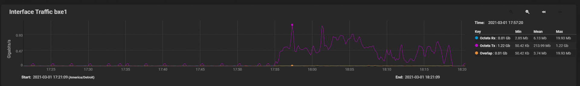

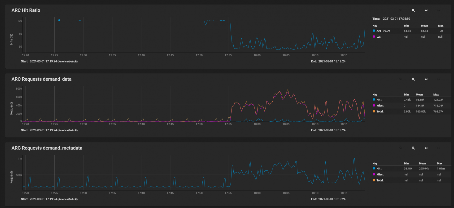

Attached are screenshots of svMotion from iSCSI SAN to local M.2. I am svMotioning my vCenter and it is about 100GB right now. The first screenshots are from iSCSI mirror pool to local M.2.
I then performed a test of svMotioning from local M.2 to test samsung 850 pro ssd via ISCSI. This was weird because it transferred at like 50Mb/sec to this test iscsi share. Not sure if this pro is a failing drive or what. (This 850 pro used to be my l2arc). I then svMotioned back to local M.2 and transfers were about 150-300MB/sec.
I then svMotioned the vCenter back to the standard ISCSI SAN mirror pool and transfers were anywhere from 300-700 MB/sec.

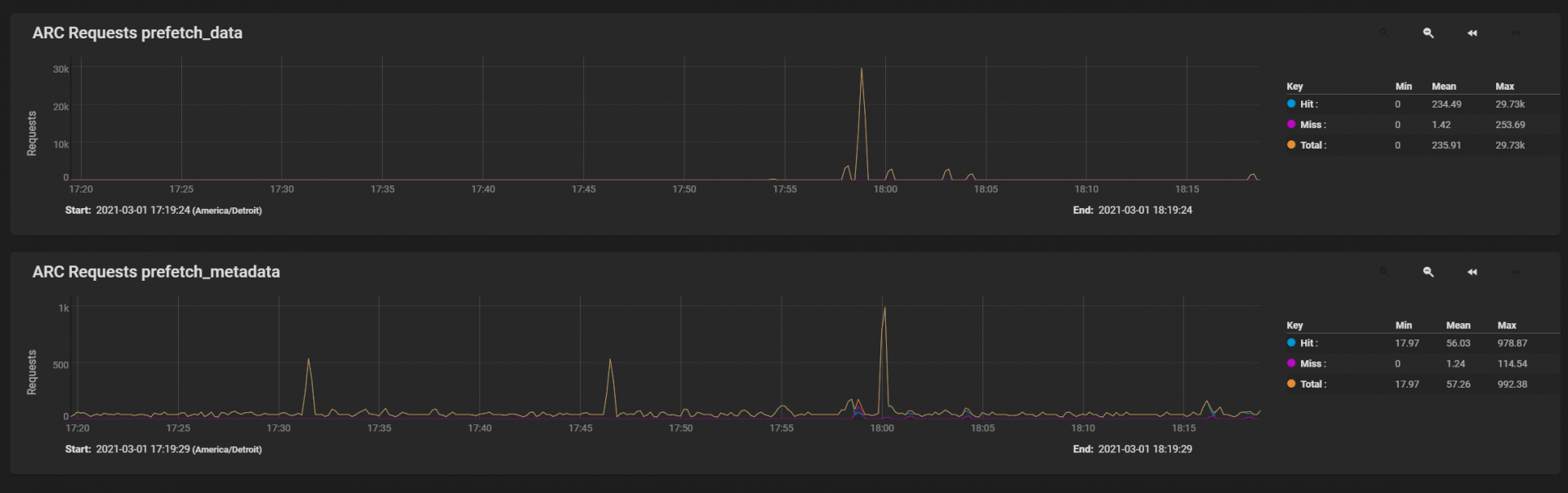

The ARC hitrate diving under svMotion is expected, because it's pulling data that isn't touched normally. The prefetch algorithm almost seems to take one crack at it and then almost give up, as if it says "I'm not helping here" and shuts down. However, more RAM isn't an option here I assume looking at the hardware.

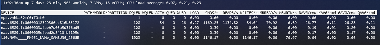

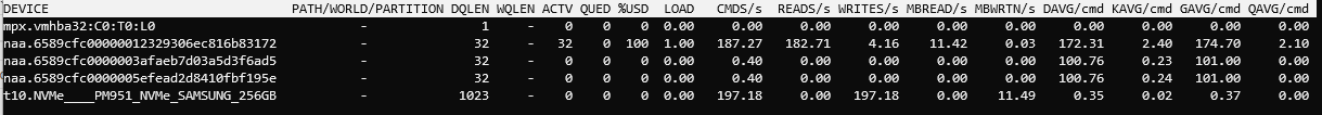

Not exactly sure what I am looking for, but here are some screenshots when I am doing an svMotion.
clifford64
Aug 18, 2019
87
Looks like you're pulling in about 70MB/s of svMotion speed there. DAVG/cmd (driver average latency) values of 26.77ms are pretty rough though. What's the network configuration/pathing for the ESXi host to TrueNAS?
