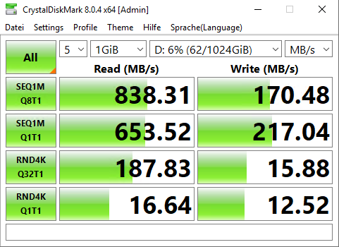

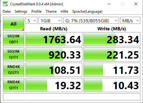

And apparently, doesn't matter what I do, I get half the speed. About 100-150MB/s.
I tried following iSCSI setups:
1) Over VMXNET3, same as NFS (basically both have an IP, and Windows iSCSI connects to Truenas)
2) Connecting ESXi to TrueNAS and VM via RDM (ESXi has a VMkernel Adapter and PortGroup on the same vSwitch, PG is assigned to the TrueNAS VM, VMK and TrueNAS have IPs from the same subnet, ESXi connects the iSCSI, then I use RDM to directly assign iSCSI to the VM, in windows create local ReFS/64 disk and locally save backups)
3) iSCSI ESXi->TrueNAS, VMDK for Backup-Server (basically same as 2nd way, with the exception that I create a Datastore on TrueNAS-iSCSI, then create VMDK on the datastore and assign it to the VM).
Additionally, I tried in 1st configuration to set MTU to 9000 in TrueNAS and vSwitch. Absolutely no change.
Any ideas what the problem might be?
