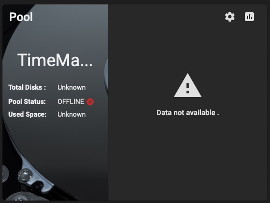

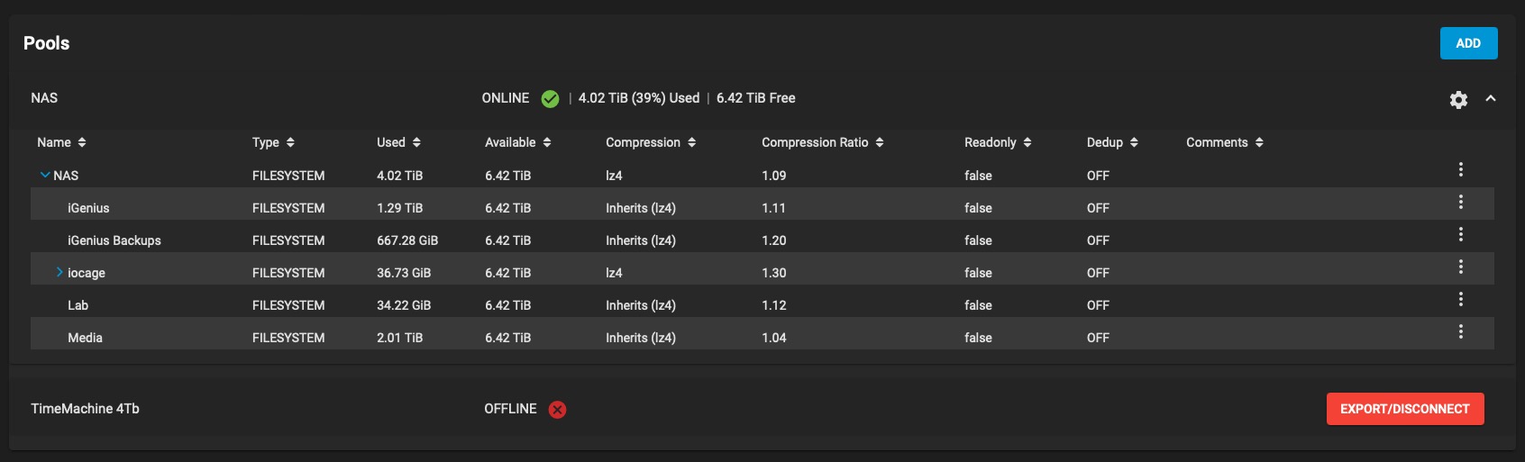

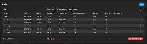

I know this is weird, here are a couple screen shots:
