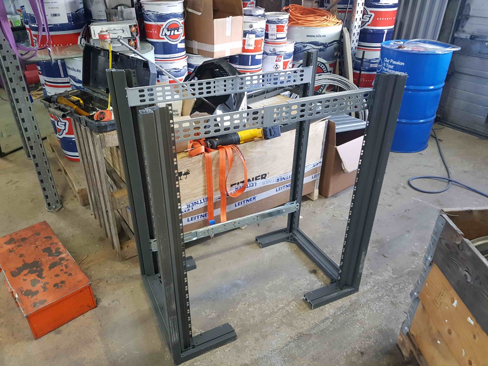

I have a new plan now.

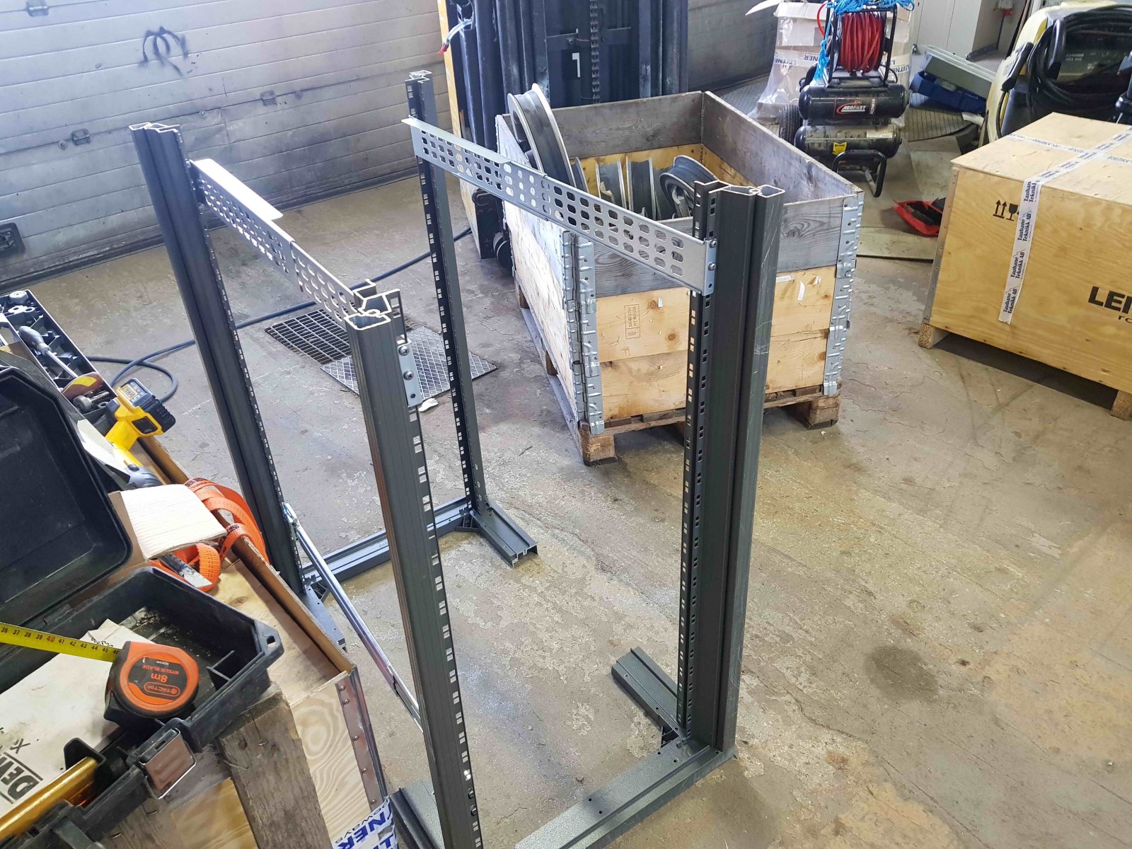

the attic is small therefor the air is heated up by the pc. yea you get the picture.
so
i am rebuilding my server rack 60X60x220 to 60x100x120 and am going to close it off on all sides, top and bottom.
then all the air will go through the servers in the front and out back.
I will make a box on the back and then connect that to the ventilation system in the house,
then i get enough static pressure/Suction and as an added bonus i can reuse the heat in the rest of the house.
and a lover ambient temperature means slower spinning fans = less noise.
problem solved.

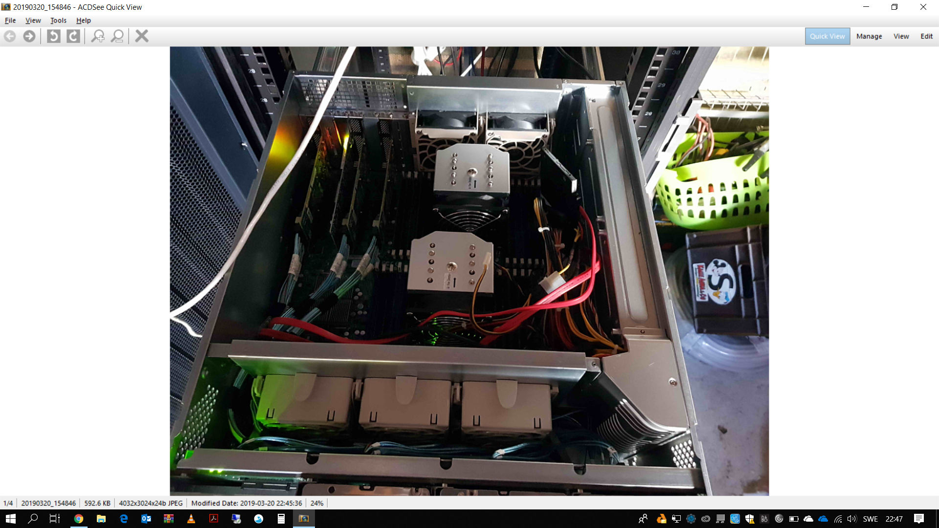

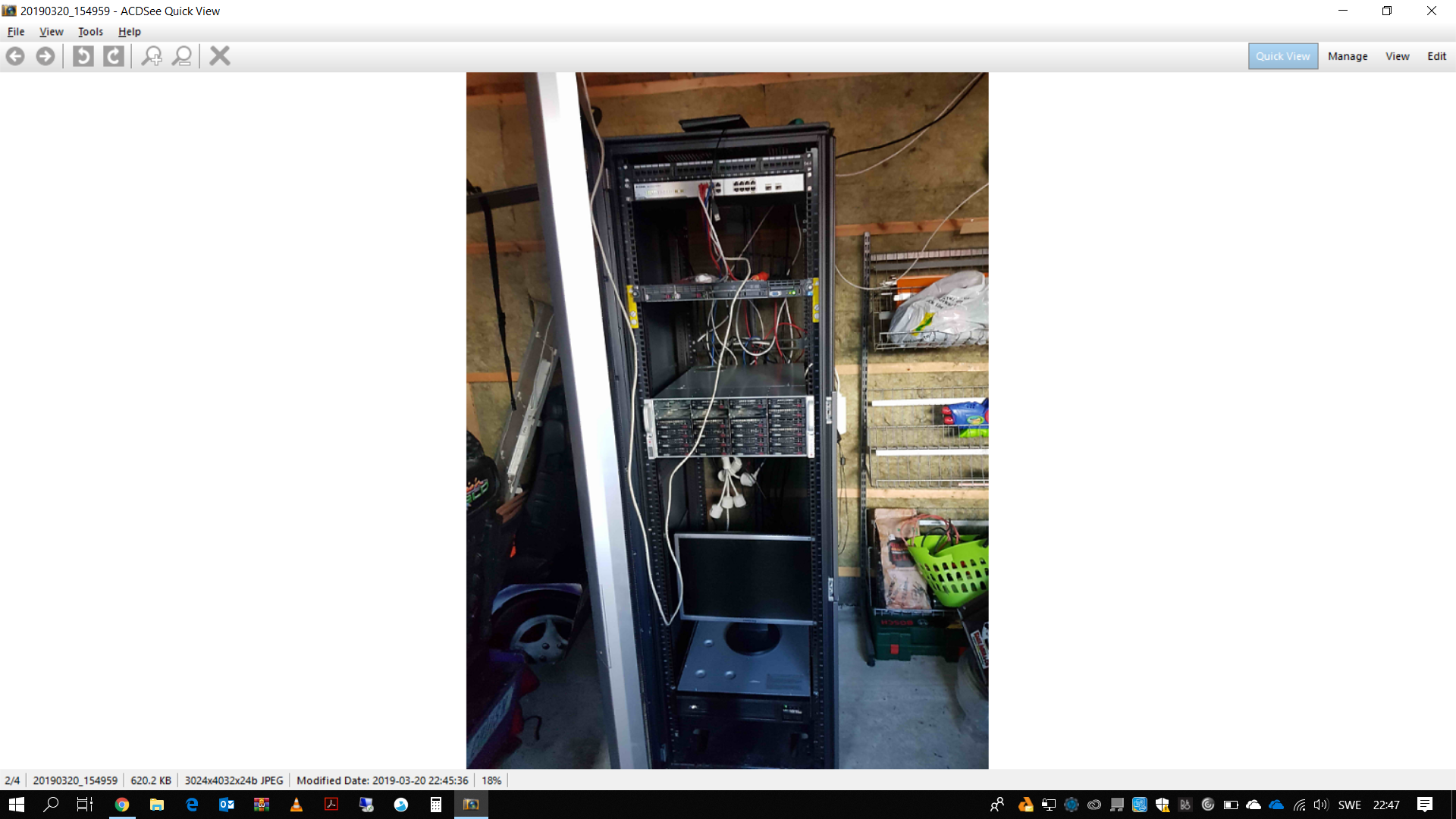

so i changed my mind again :smile:
new HP rack and out of the house
2 new coolers for the CPU.
now i dont have any issues with high temperatures
now it might even be to low temperatures

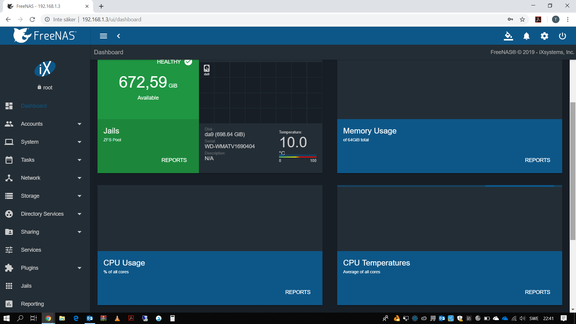

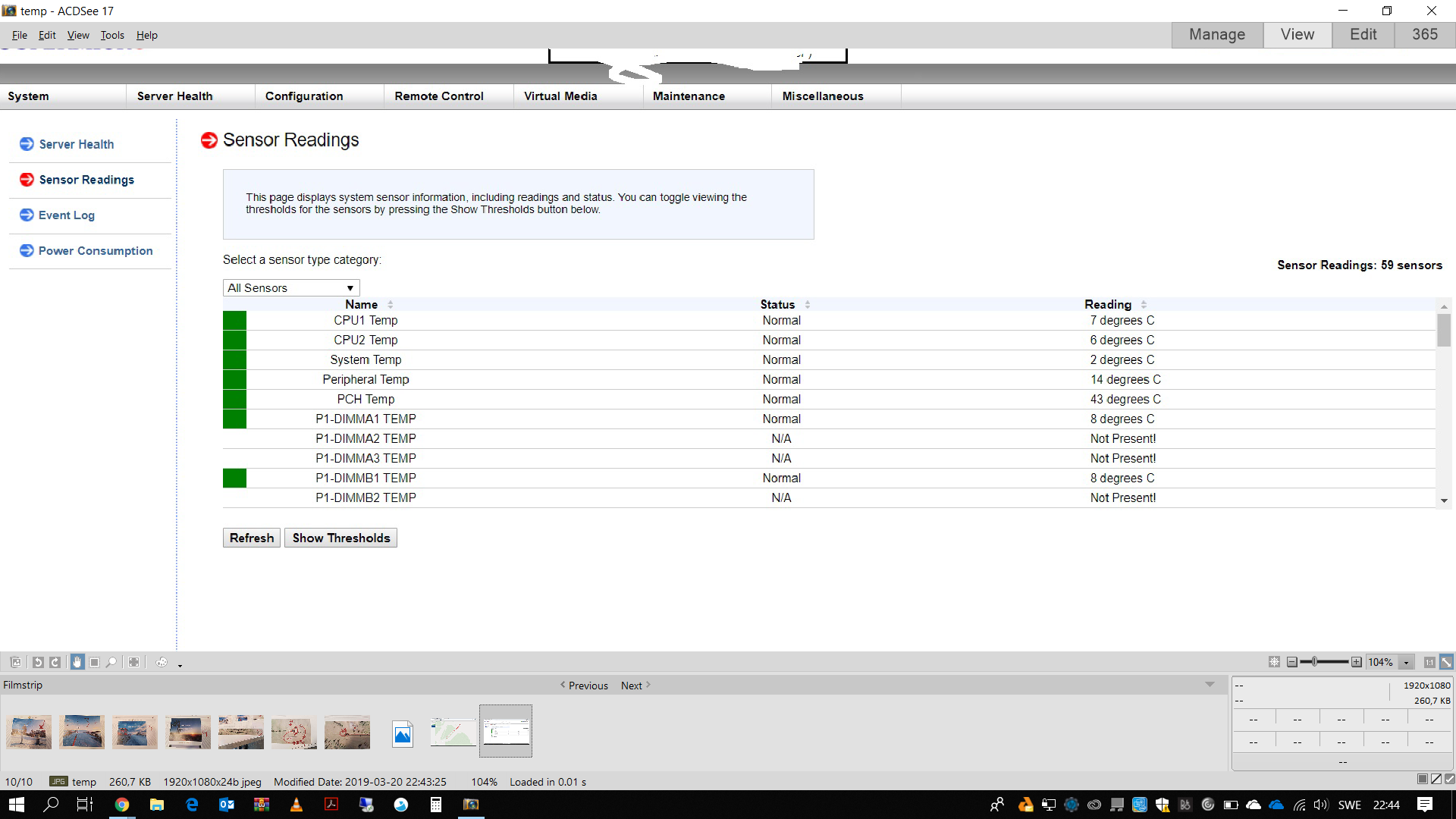

do i have to use UEFI to get temp readings in Freenas or is the problem the temp is to low now for the sensors to work ?

What is the temperature in the room where the server is located? I am asking because that is quite low for all those temperatures. Near freezing.
The rated operating temperature range for the drives is above 0°C to (depending on model) as much as 65°C or 70°C.
https://www.wd.com/content/dam/wdc/website/downloadable_assets/eng/spec_data_sheet/2879-800002.pdf
Processors can be happy much hotter, but the most reliable operation for the drives is around 35°C and that is what you should focus on getting to.

The air going in the front of the chassis should not be below freezing. Also there is a possibility of condensation inside the server if the temperature difference is significant.

Also, you can't have empty bays. You need to fill those with trays with spacers. This is an integral part of the design that forces airflow around the drives. Especially with such extreme temperature differentials, you've got all sorts of problem potential.

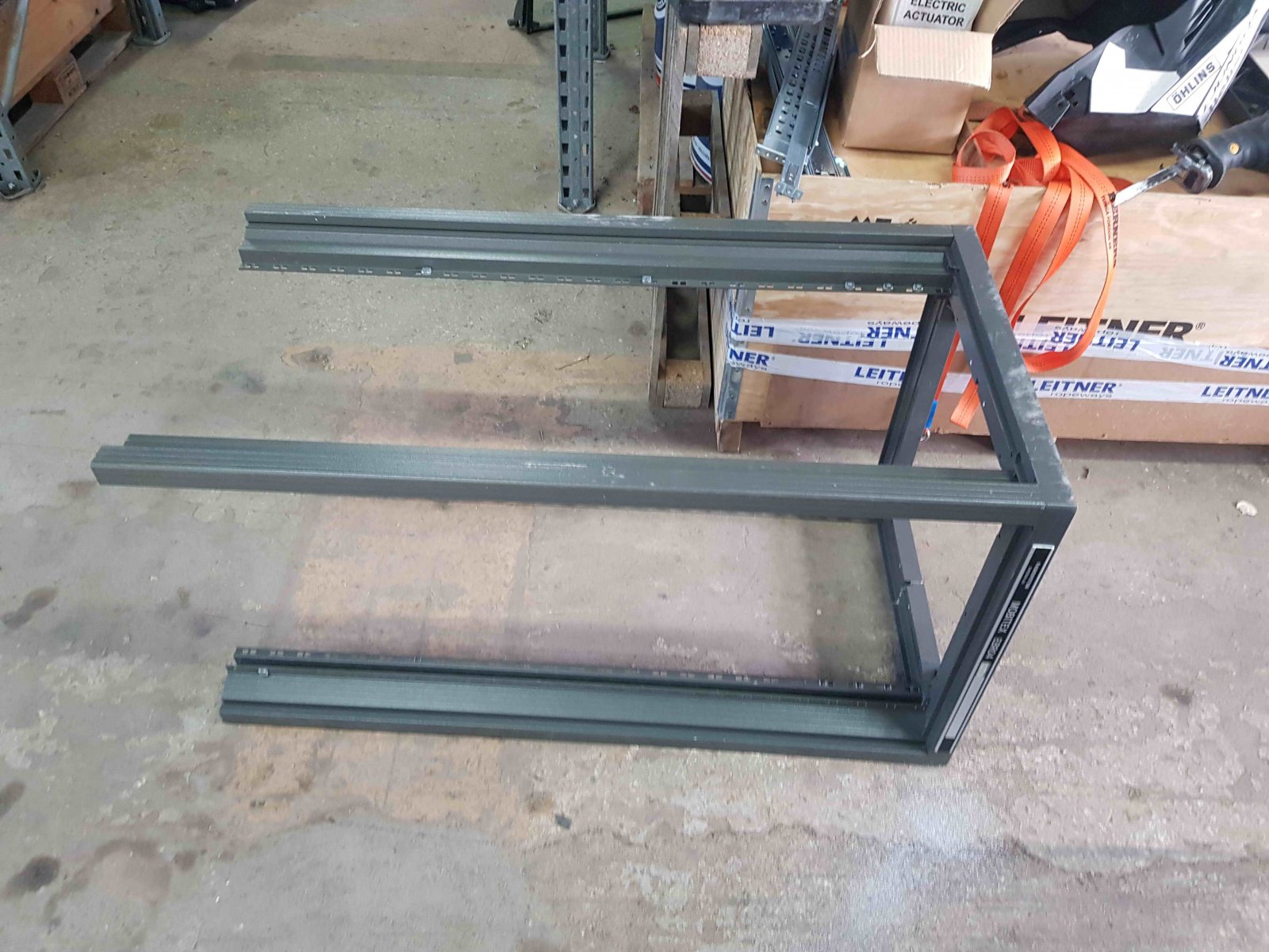

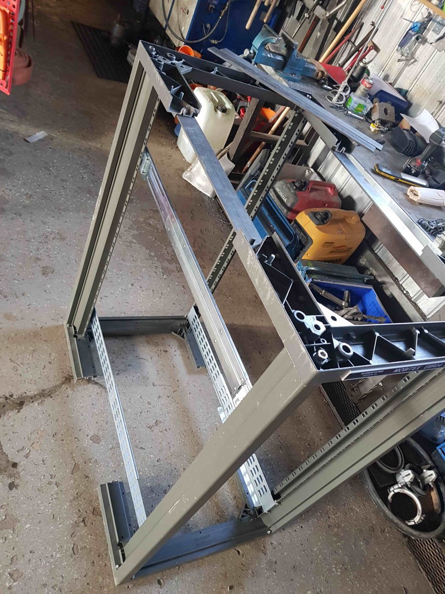

i know about the bays :smile: at the moment i done need any fans because of the stupid cold enviroment the server is in
i have new bays for ssd's comming in 2 days and i have to rebuild the rack again so the servers can keep warm
i have my projects they always get so much bigger :-(
